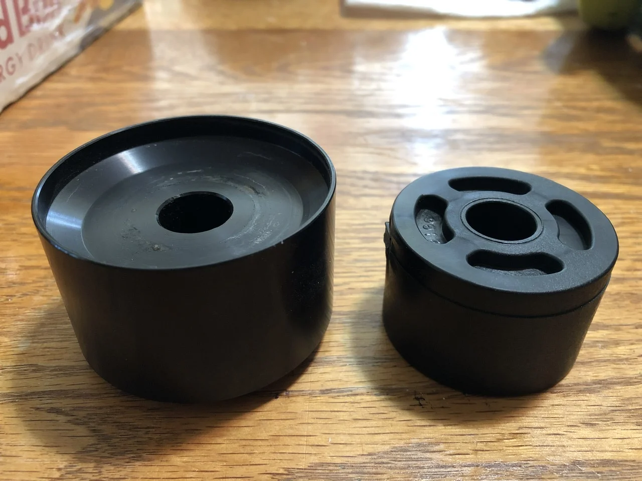

Try to break it and see what happens. Your Jeep will break into pieces easier than that puck.Here is a zone puck next to a savvy puck. The zone pucks seem to be a very hard reinforced polymer unlike the jks pucks. They would definitely break into pieces rather than deforming if taken all the way to yield. They are both 1.25 inches. View attachment 267651
I wasn’t suggesting the zone mounts are prone to breaking. I was saying that my prediction in the manner that they would yield in a destructive test of increasing pressure would be to suddenly break apart given how hard they are. It was meant to be an assurance for those who may be wary of the zone mounts squishing down like the polyurethane jks mounts. If I had no plans for this puck I would maybe think about hitting it with a big hammer for you.Try to break it and see what happens.
That zone puck looks exactly like the hard 3"x3" body lift pucks I used to use and cut down as bump stop extensions.Here is a zone puck next to a savvy puck. The zone pucks seem to be a very hard reinforced polymer unlike the jks pucks. They would definitely break into pieces rather than deforming if taken all the way to yield. They are both 1.25 inches. View attachment 267651
I've seen pics of the broken plastic pucks. Catch a rock and the frame mount rolls over, crushing the puck. Do a nose dive off a ledge and a whole bunch will shatter at once. That is exactly why we have aluminum pucks. But this isn't a problem most will ever need to solve.Try to break it and see what happens. Your Jeep will break into pieces easier than that puck.![]()
