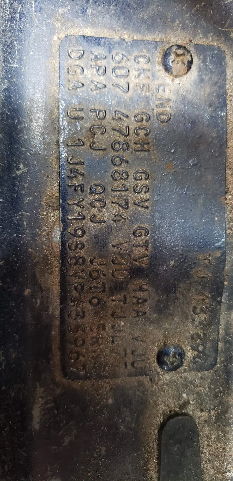

I'm a real noob to jeeps so please bare with me. but i could really use some help answering some questions that have come up in my search. so I'm looking for a transmission. big dollar investment in my build. must get it right you all know what i mean. research research research
I'm absolutely certain i have a 3 speed automatic but 97 TJ service manual only lists 42rle its a 4spd. first big ?
I cant seem to see the transmission code plate without a bunch of wrenching so I'm looking at the body code plate and the transmission code matches nothing i can find DGA??
I am mostly certain that I have a 32RH but I need to be sure. does anyone have any literature references that could help or does anyone recognize the DGA code

Ok so just checked my 97 FSM, and sure enough those three letters on the bottom left of the plate are for the transmission. But I see nothing about DGA! Only DGD and DGG. The DGD is the 30RH 3-speed, and the DGG is the 32RH 3-speed (top-right of page three).
I also don't understand the last three digits of the top line on your plate. According to the FSM, they are supposed to be either TJJ or TJU, but yours looks like VJU?
Keep us posted on what you learn. I wonder if DGA was used as a code on any YJs, and maybe this little typo in your plate is a quirk of the 97s?
