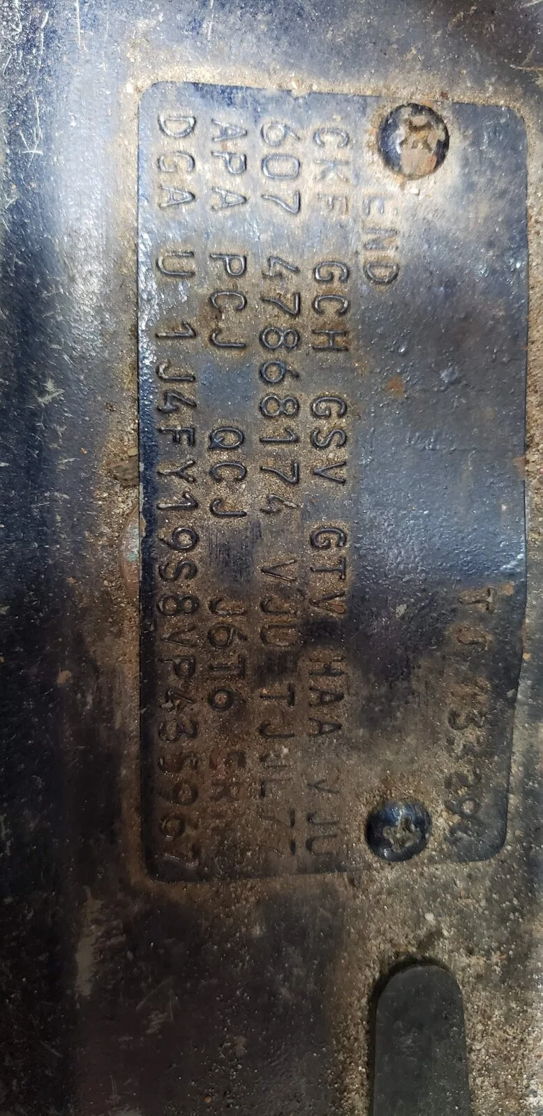

In reference to 97 TJ 4.0 sport 3 speed automatic.
I'm a real noob to jeeps so please bare with me. but i could really use some help answering some questions that have come up in my search. so I'm looking for a transmission. big dollar investment in my build. must get it right you all know what i mean. research research research
I'm absolutely certain i have a 3 speed automatic but 97 TJ service manual only lists 42rle its a 4spd. first big ?
I cant seem to see the transmission code plate without a bunch of wrenching so I'm looking at the body code plate and the transmission code matches nothing i can find DGA??
I am mostly certain that I have a 32RH but I need to be sure. does anyone have any literature references that could help or does anyone recognize the DGA code
Do I have an oddball jeep??
I appreciate any help that is available Thanks all

What is the correct one? I'm trying to recreate my body code plate (and other VIN stickers, vehicle was stolen and recovered 5 months later with most ID striped) and I can't figure out if the code would have been DGA or DGG. The Build Sheet Sales Code Description provided by Jeep has both:
DGA ALL 3-SPEED AUTOMATIC TRANSMISSIONS
DGGS 3-SPD. AUTOMATIC 32RH TRANSMISSION
and the Service Information has:
Transmission:DGG-3-SPD. AUTOMATIC 32RH TRANSMISSION
So I would think maybe DGG, but then why does this guy's '97 body code plate have DGA? Would mine have as well?

DGA would cover the 30RH and 32RH and the DGGS would only cover the 32RH.

I'm still not understanding why my build sheet would have both DGA and DDG or why the '97 service manual lists DDG and not DGA as a code, but the original poster has DGA on his body plate code.
I'm trying to figure out what mine would have said with the information I can find.

One thing I'm trying to figure out is the top lines on the body code plate. All I can find is:
"There are seven lines of information on the body code plate . Lines 4, 5, 6, and 7 are not used to define service information . Information reads from left to right, starting with line 3 in the center of the plate to line 1 at the bottom of the plate (Fig. 3)."
