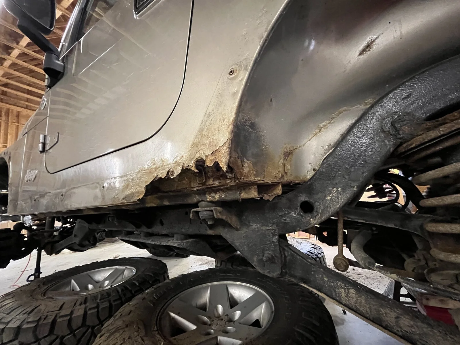

This corner was the worst and had previously been patched. The Rubi rail, fender liner and undercarriage coating were trapping water.

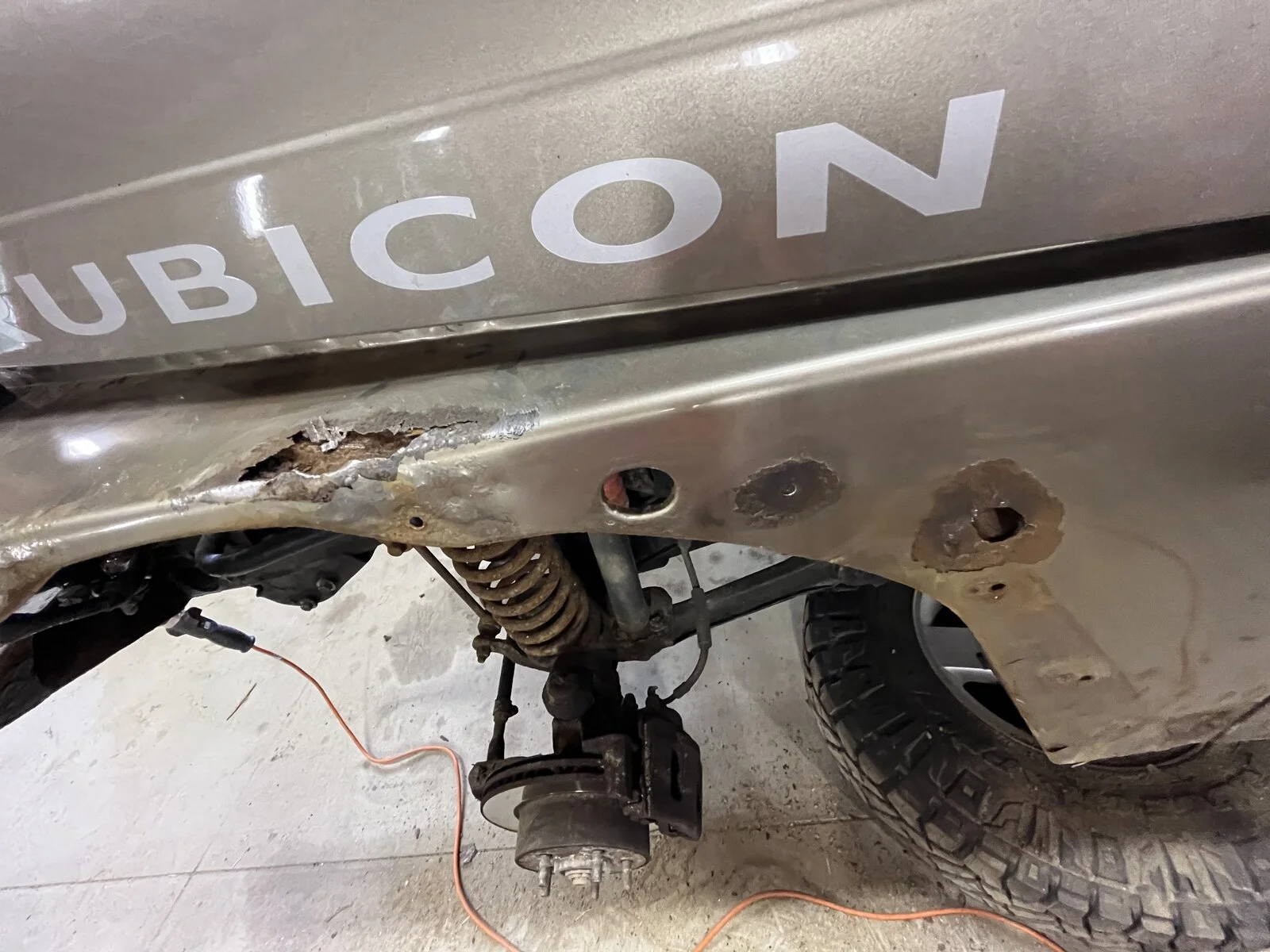

This is where I started wire wheeling and realized it was worse under the paint than I had hoped.
Anything can be fixed but what does your budget look like? Rust repair is expensive and very few shops want to do it. There will be a huge difference in opinions depending on where you are located. On the west coast that is a parts jeep no question. The good news is since it's a rubi you have good value in the drive train if you decide to sell or part out
The fender is replaceable, the rocker panel not so much. To stop rust you have to get it all. Your torque boxes are probably frail.
If the frame is good then a tub swap would be in your future.
The other option is to sell the Rubi goods and hopefully recover $8k (doors, TCase, axles, hardtop??)
Rust is the debil.
If you could do the work it would likely be cheaper to source a tub and frame than it would be to take it to a body shop.
Your options on that Jeep are to part it out, sell as is, or replace the tub and frame.

As someone living in a rusty salty area and going over rust mitigation on my own Jeep... I'd inspect the frame really good. Drill the drain holes, run the sewer jet through the frame, go over it smacking it with a hammer. If all checks out there, then a tub swap, probably. Or coat all the rust in the tub in POR15 now just to prolong the life until an eventual tub swap. Once you por15 you've pretty much given up on any repairs, it'll be impossible to work on. But it'll last a little longer.
If it's like mine, the tub rot is only in that corner. My torque boxes and frame are 100% solid. Very frustrating, just poor water drainage in the design.
Front fenders are easy enough to just replace.

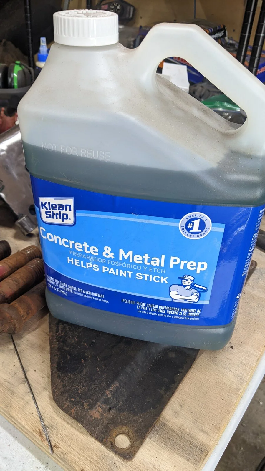

While we're on the topic, I've been taking all the surface rust down to metal with a die grinder, then treating it with phosphoric acid. That will turn the iron oxide to iron phosphate and neutralize the rust. But it only does what's on the surface. Phosphoric acid is, as far as I can tell, the main ingredient in most expensive "rust converter" products. But you can buy it by the gallon at most hardware stores for much cheaper. (maybe not in california)
As said earlier, the fenders are an easy fix. Tub wise before you invest the time and materials in fixing that I would source a tub from a southern state. I got a bunch of sheetmetal from a guy in NC that parts out very nice Jeeps. Time and money wise I just think it's easier. I have done it both ways.
