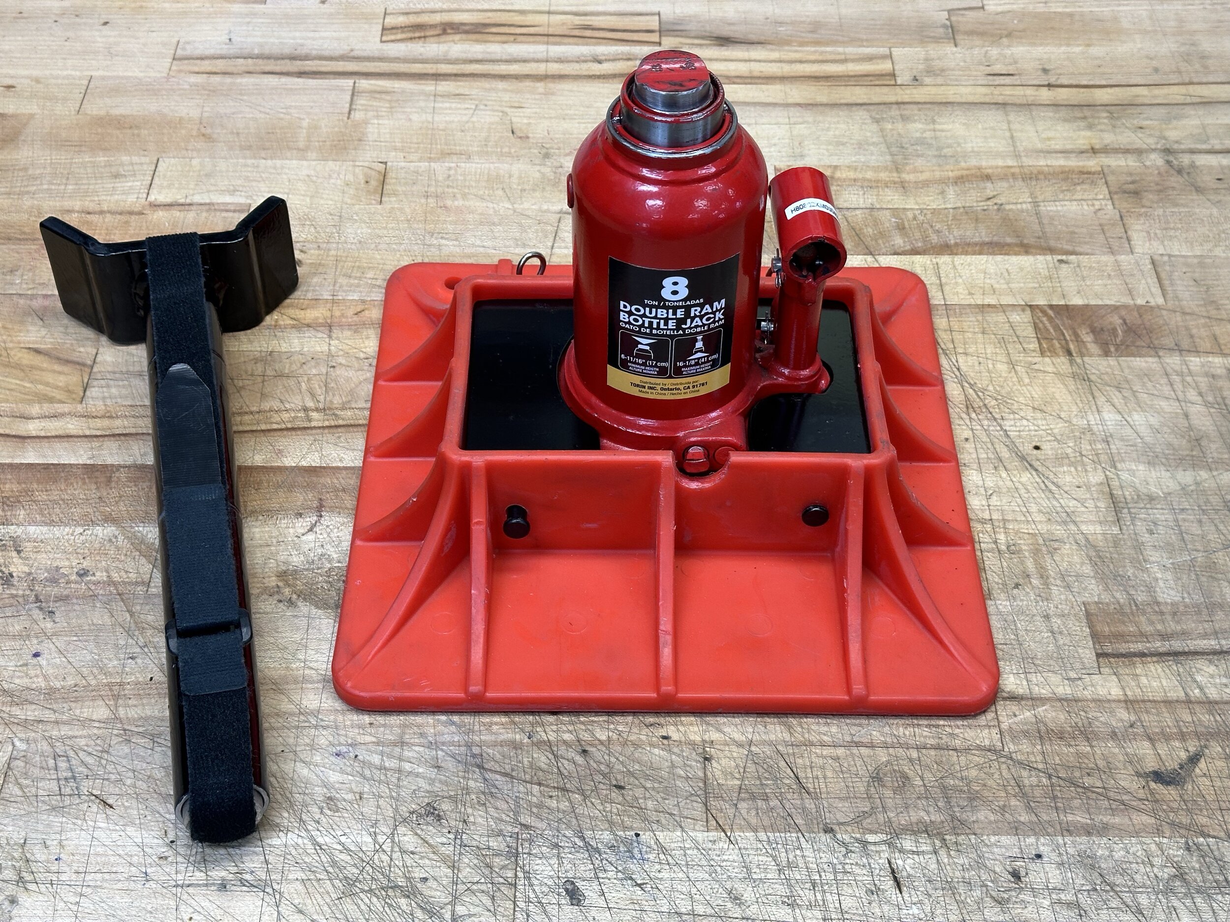

Bottle Jack Useful Accessory Build (Or - Bye, Bye High Lift!)
The 3/8" clevis pins came in from McMaster-Carr this morning. They are always spot on - I ordered them yesterday afternoon.
They work great. Very easy to insert and remove.
And here is the jack in action. The 8-ton jack lifts the rig easily.
Now I'll paint the hold-downs and look for space to fit all this inside of the rig.
Say what you will about the high-lift, but it takes up zero space inside the rig... :)
Very nice. So, what's it all weigh compared to the 29 lb high lift? Less I assume. And of course, what performance and mileage gains are you anticipating with the weight reduction? :LOL:
The jack and extensions came in at 14 pounds. The base was right at 3, for a total of 17. So a 12 pound reduction compared to the high lift.
But to get the jack and the base into the back of the rig, I had to loose a couple of quarts of motor oil that I usually carry - so that offset the addition of the base…🙂
