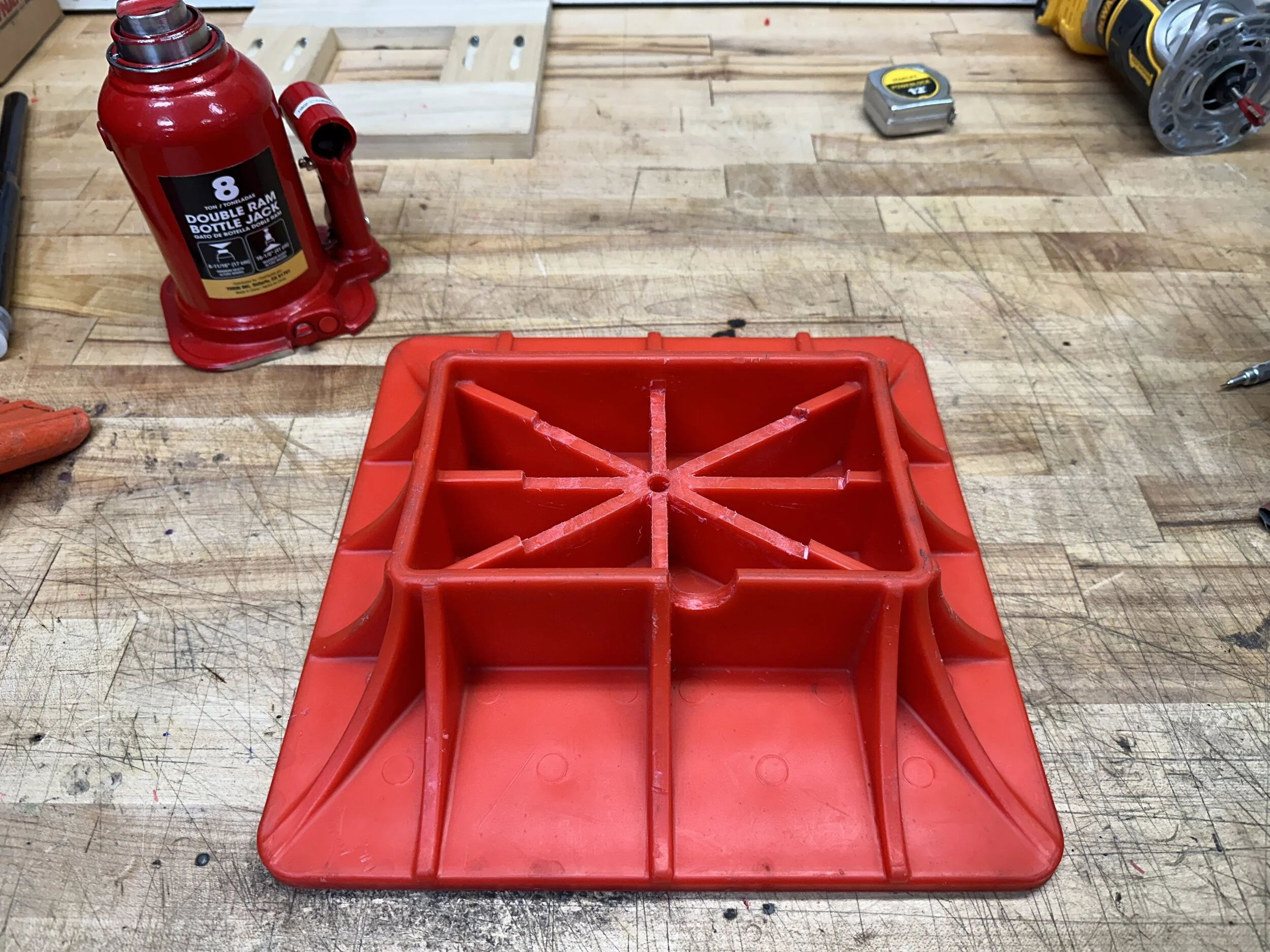

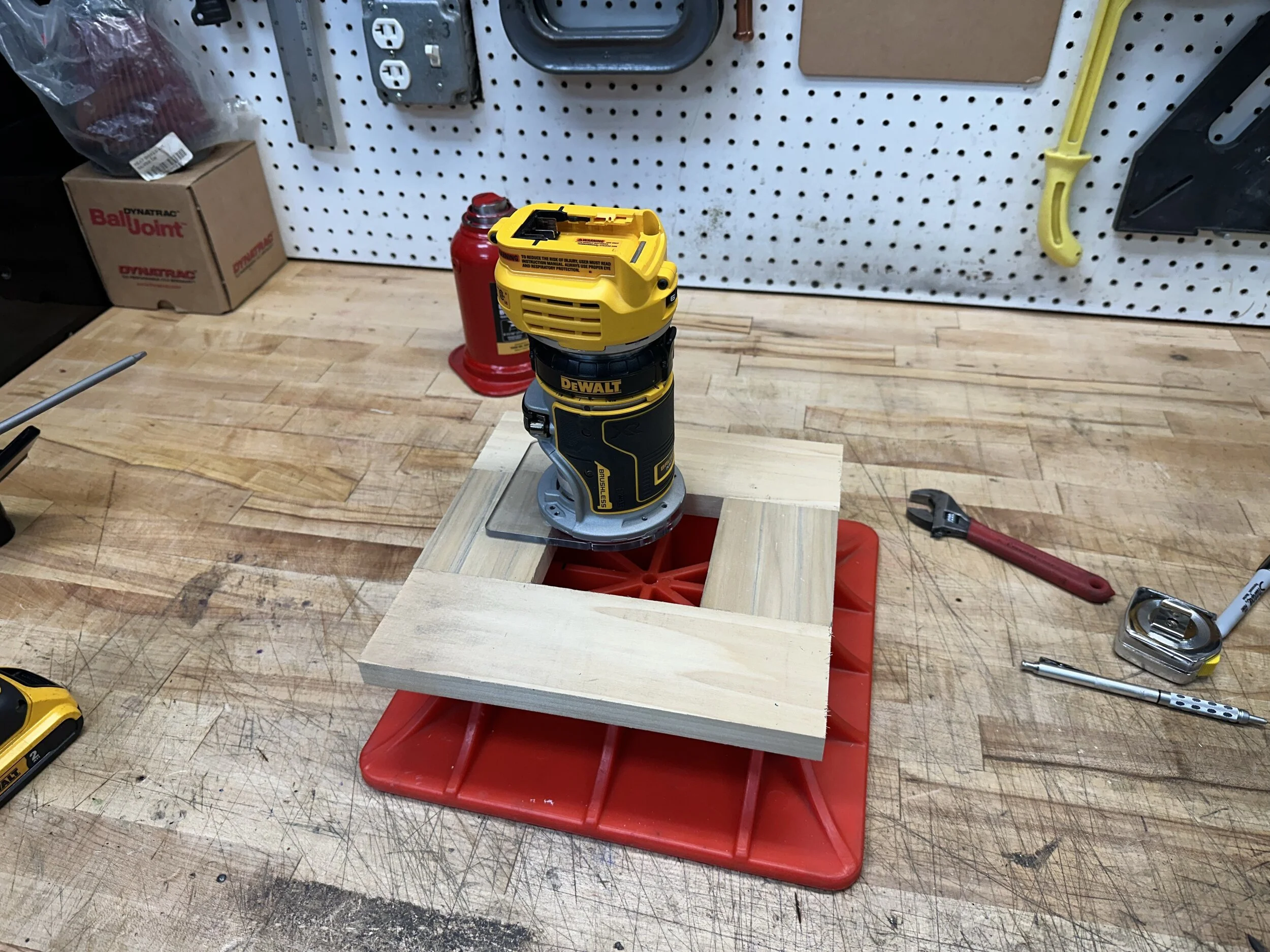

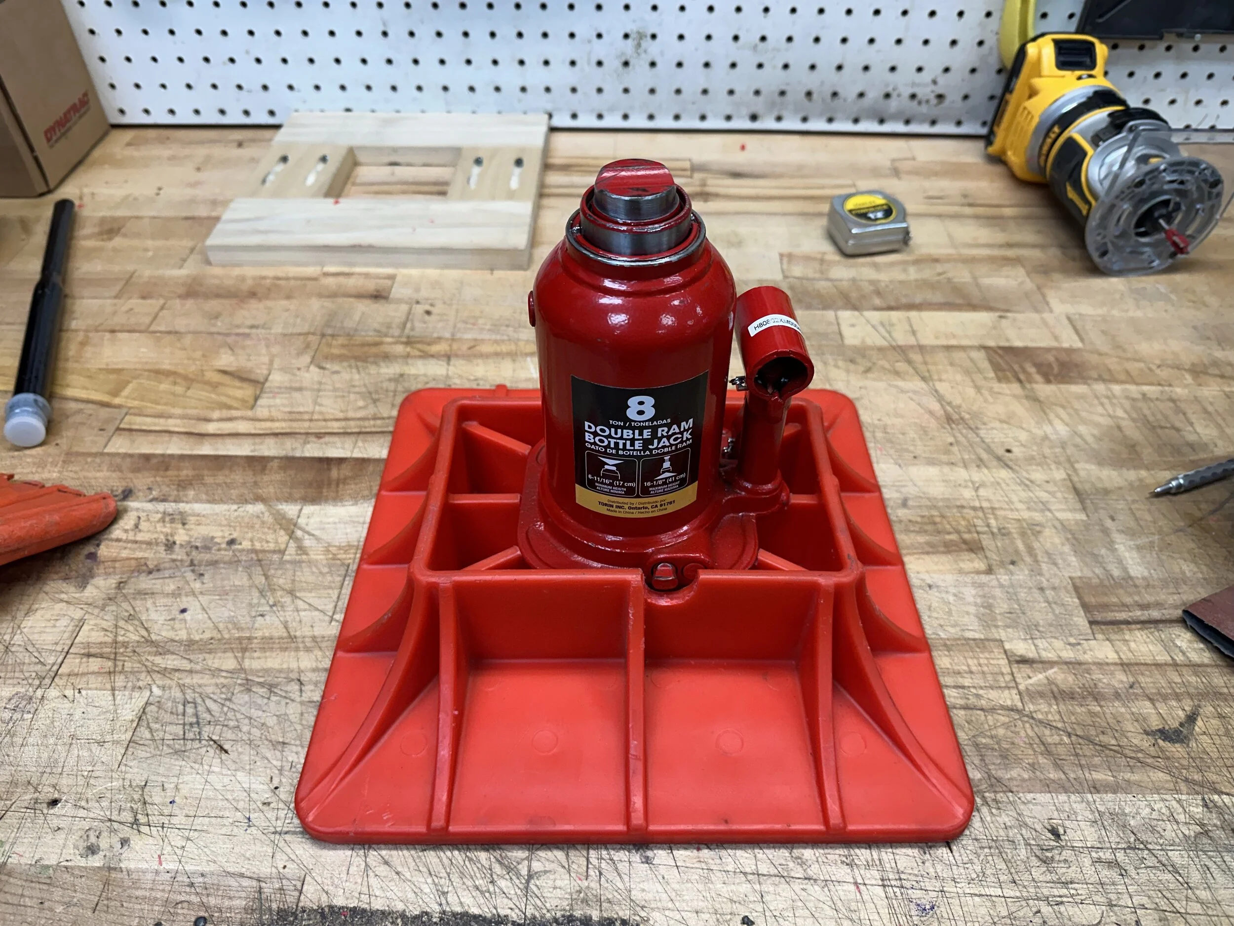

Wanting to experiment with this a bit more, I made a quick pocket-drilled jig for my small router, and carved away.
This stuff is not easy to mill - it wants to melt if you are not careful with the cutter speed and movement.
But here it is - the base of the jack sits flush with the top of the ribs. Now to think through some methods to hold it down.

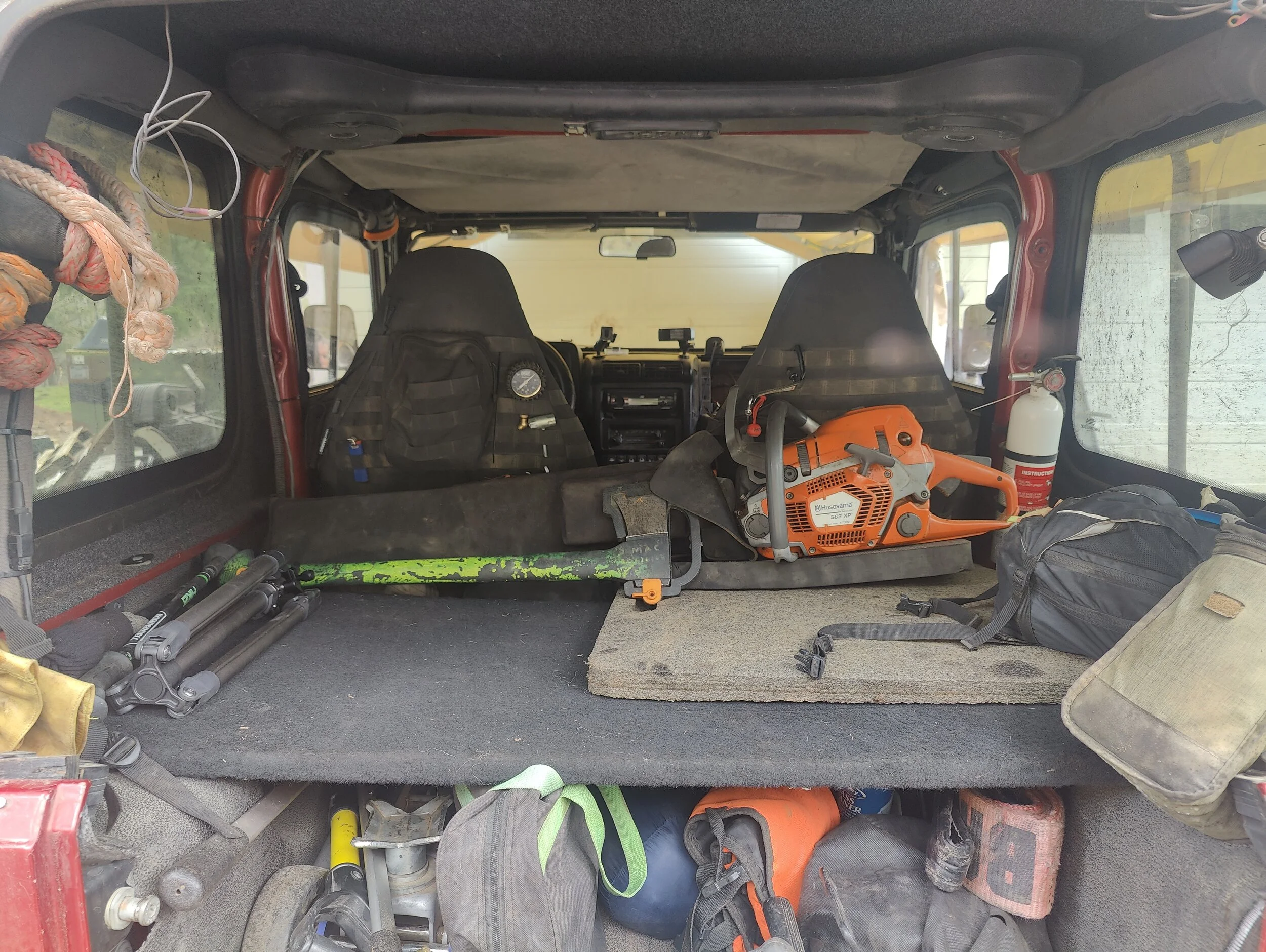

Here in the PNW if I need a block to float a jack or prop something up I just whip out the chainsaw and make something on the fly. Why carry something when the forest will provide!
-Mac
So Mac, you carry a 30 pound chain saw instead of a 3 pound block?
Just kidding - I know you usually carry your saw. By the way - that thing is a monster (just watched your snow / stuck / nearly ran off the cliff video). I've got a 75cc Jonsered with a 3' bar. You know how much I love heavy duty power tools...
Absofuckinglutely!
And an axe, wedges, chaps, small battery saw, Silky folding saw...
Mostly I don't trust plastic. And I absolutely hate when it breaks and I spend an hour on the ground picking up all the pieces.
I think the plywood idea was pretty good.
-Mac
P.S. Nice saw! My 28" tucks just behind the front seats...36...did you cut a hole in the side or do you have it outside?

Anything more than a 18" to 20" bar IMO is too much for EDC in the Jeep. But there are times I've wished I had a 24" or 36" bar also.
This was driving to work the other day after an ice storm. 42" tree. Got lucky and two guys from a local tree service pulled up behind me...unloaded their skid steer.

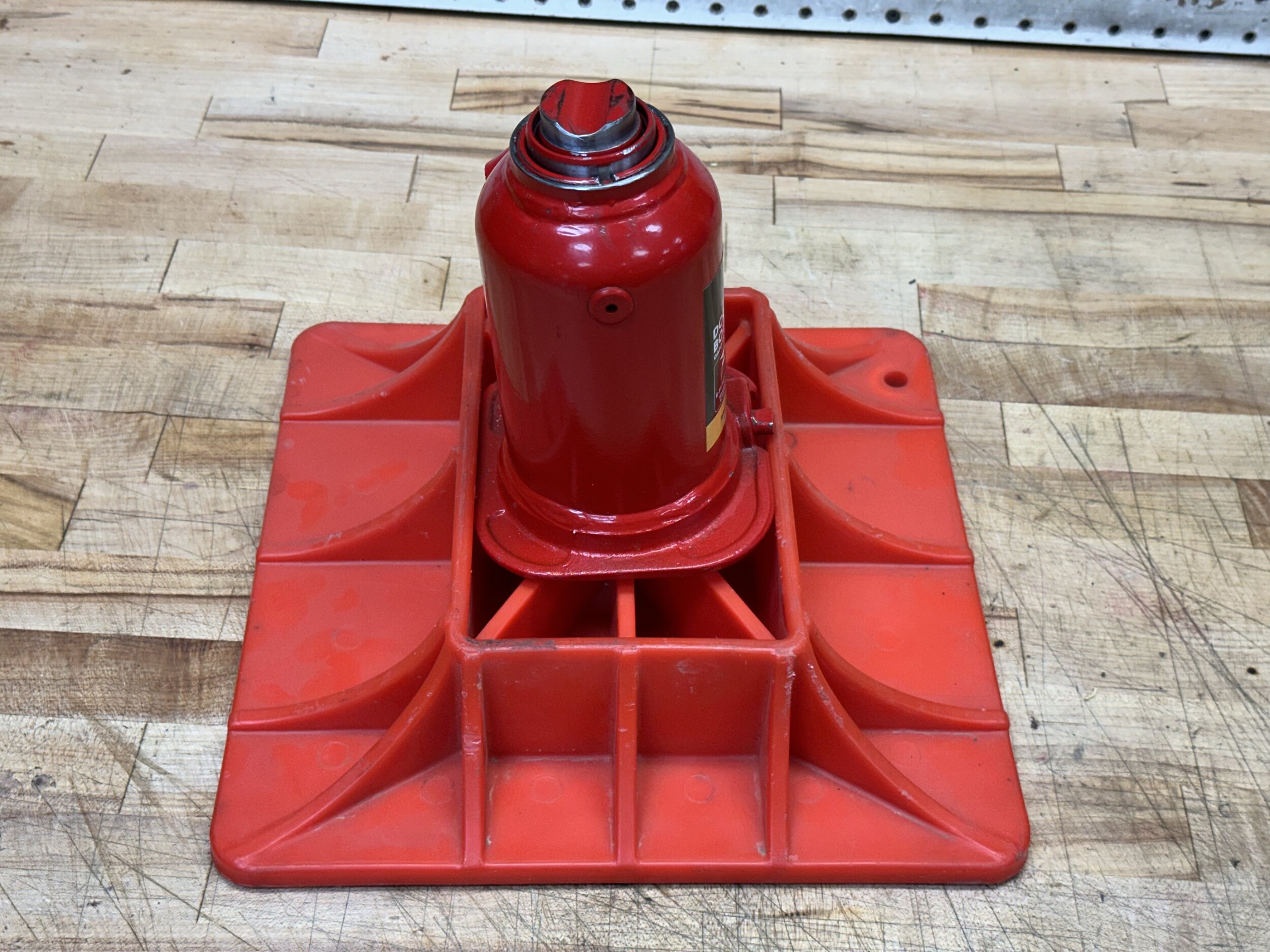

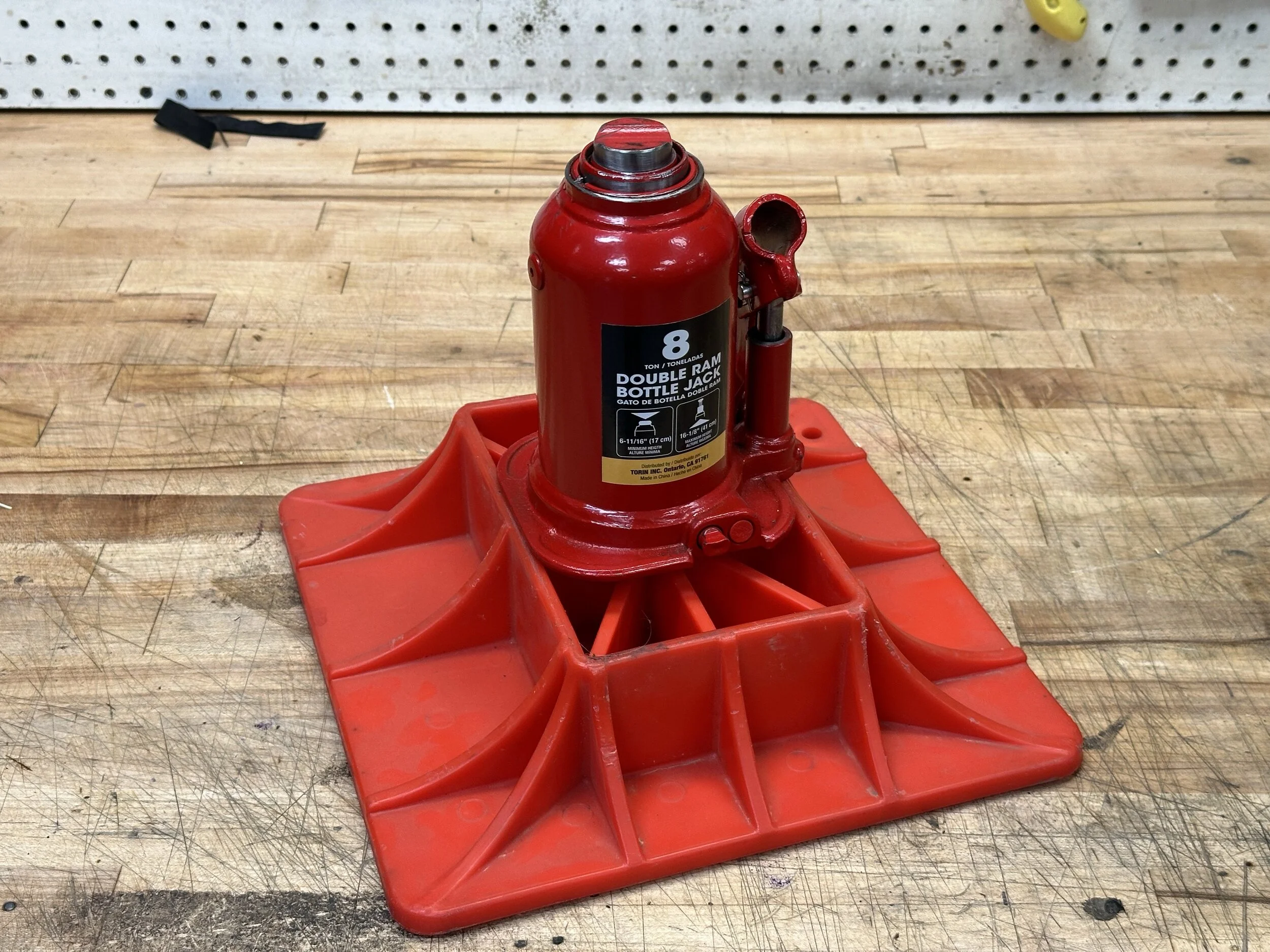

I'm also giving some thought to Ricky's comment about a base to add stability / anti muck-sink.
As I mentioned I've had this high-lift base for almost 20 years, although I have not carried it in the rig for many years as it is a bit bulky.
The jack actually fits nicely between the top rails of the base, and would require only a little clearance-ing for the release valve.
So I'm giving some thought to how to secure it to the base for use, but make it easy to remove. Any thoughts?
The downside is that it weighs three pounds, and is a bit bulky - although the scalloped design of the side rails makes it not too bad. My thought is that a steel plate strong and large enough to work would likely weigh much more.
Do you think it is worth pursuing?
I would reconsider and use a wood base like somebody else mentioned. Using the high lift base means the jack has to go in one spot. If your terrain isn't perfect, it won't work. If you use a flat piece of wood, you can move the jack where it needs to be while still allowing the base to make the greatest contact with where it will fit on the ground.
I get your point, HJ.
I look at the base as having two purposes. One, anti-sinkage. And two, and in my view more important, stabilizing the jack. The only way to do that well is to attach it firmly to the base. A flat block of wood accomplishes purpose one, but not two.
Attaching a larger base to the bottle jack will greatly improve the stability - the 8-ton jack I’m using has a pretty small base, and at the lift heights I’ve given it would be pretty unstable by itself.
I think I’ve come up with a cool way to attach it to the base which I’m working on this morning. I’ll post up in a bit to see what you think.
