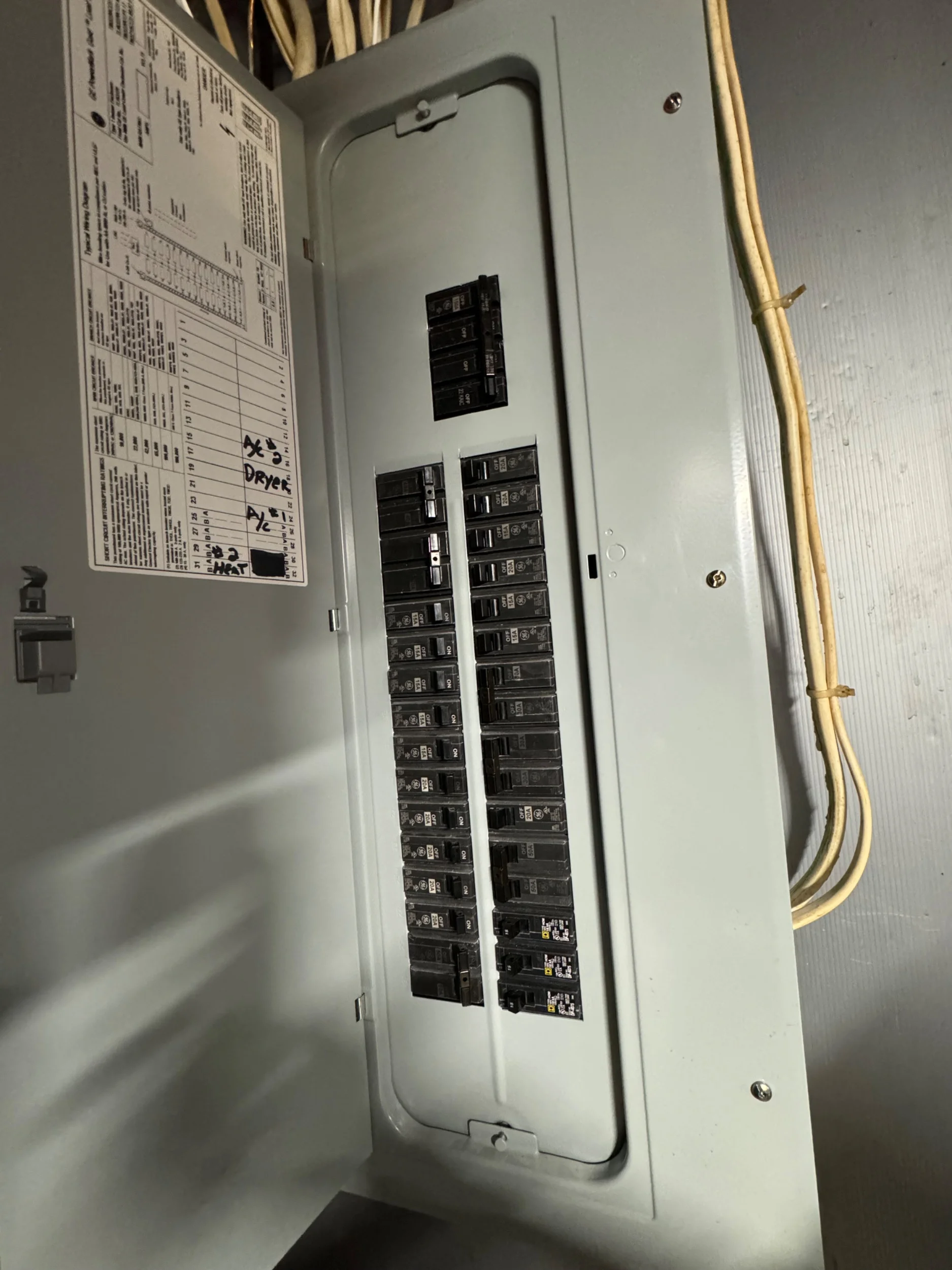

If you post a photo of your panel showing the breakers and the model number I'll explain how the circuit numbers work

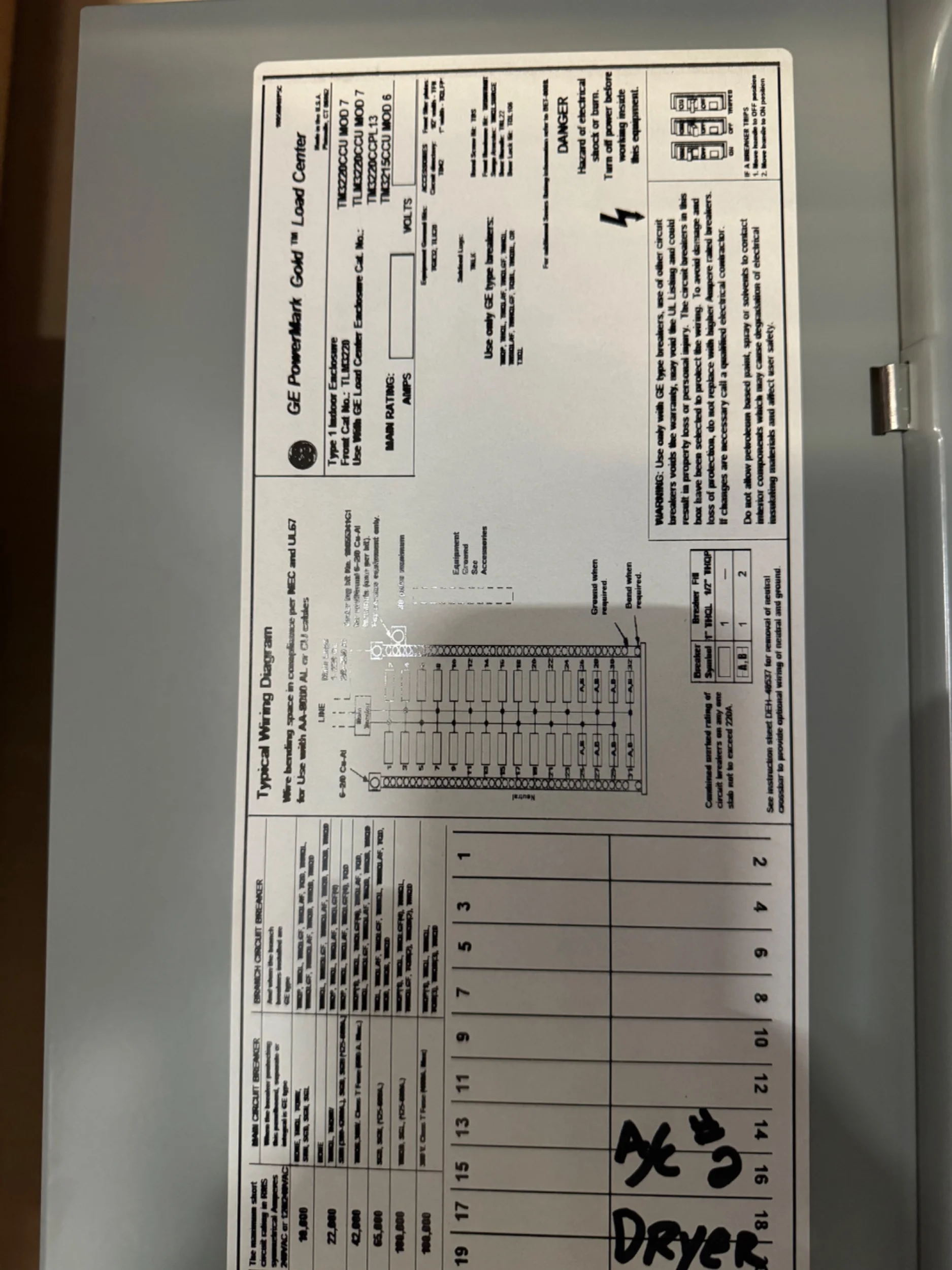

So that's a GE 32/40 which means 32 spaces 40 circuits possible. To get the extra 8 circuits the bottom 8 stabs can take twins. As you can see on the diagram the bottom 8 are marked A&B in case you put twins there. Since there are no twins now it's a moot point but if you ever want to expand you will need to label them A&B which makes the labeling even more cramped.
The diagram also shows the correct sequence which is all the odds on the left and all the evens on the right. Some people don't notice that and just write the numbers on their labels in the order they think they should be in which confuses electricians who go by the standard.
Also the 3 Square D breakers on the bottom right are not supposed to be in there, A GE panel is supposed to get GE breakers only, no other brand. It's actually an NEC code violation section 110.3(B) because it is not allowed by the manufacturer of the panel.

Thank you, I definitely would have missed the numbering sequence. Are the non GE breakers something I can replace or do I need an electrician?

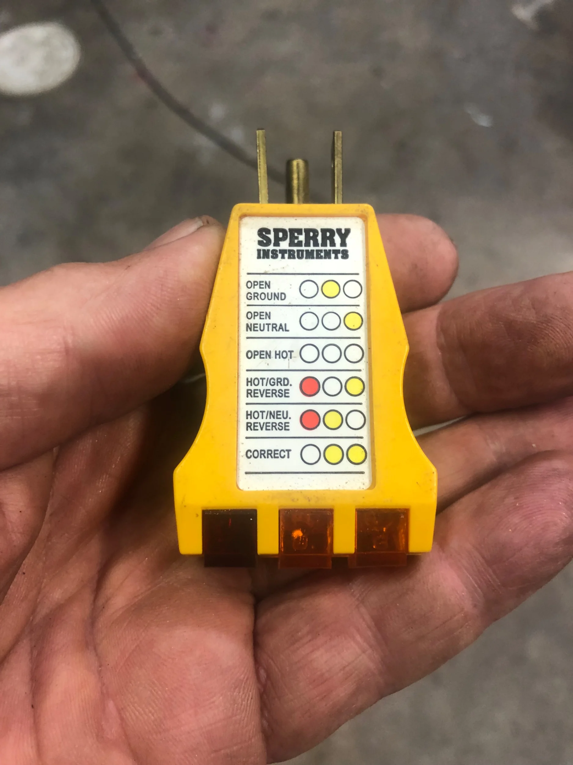

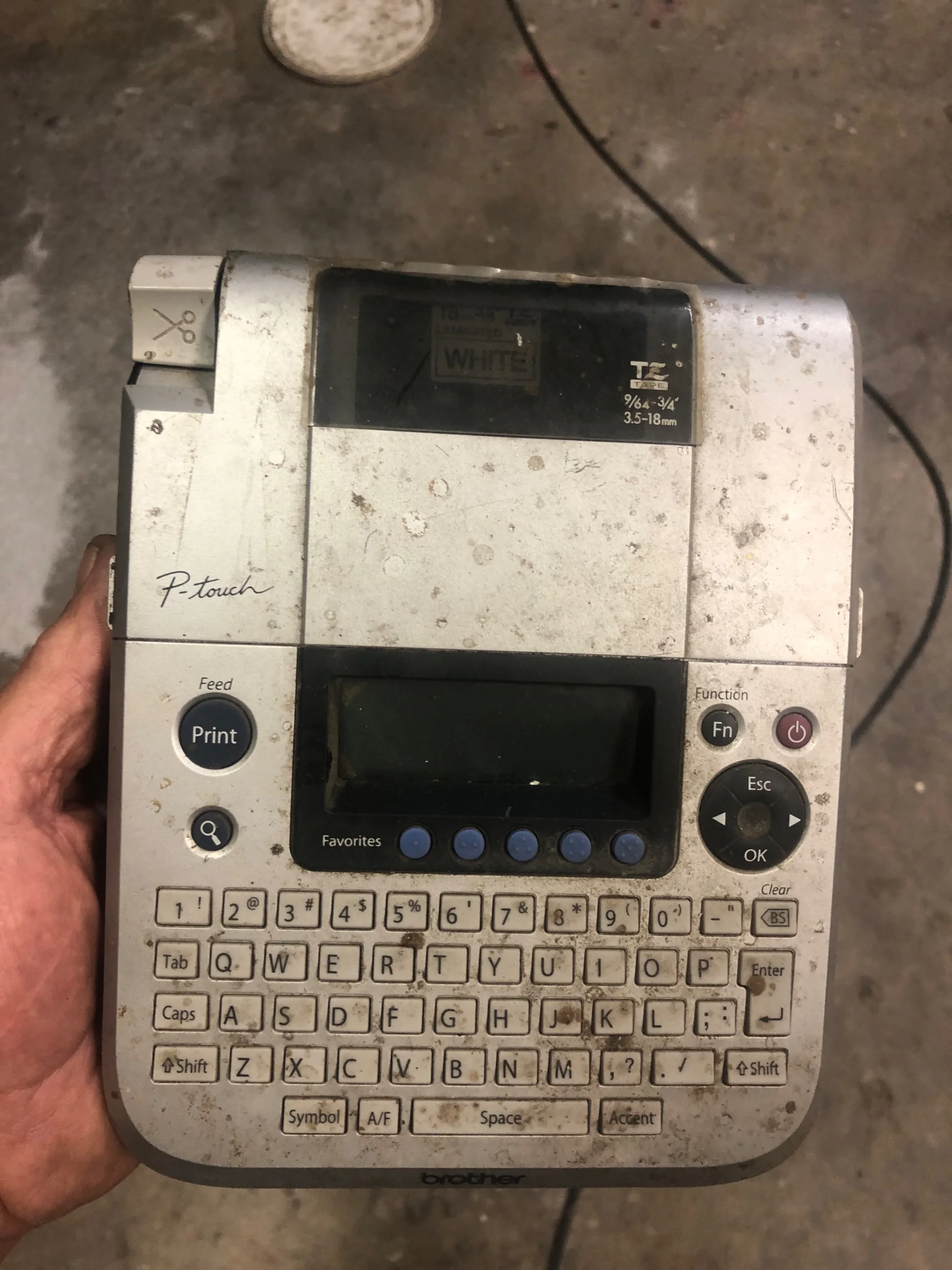

I just use a basic plug in circuit tester. I label with a P-touch label maker. I also use the label maker to document when oil changes were done and label in the engine compartment the size of the drain plug, oil capacity and when parts were replaced. I get my label makers and label refills at Costco.
You can replace them if you're comfortable working in a panel. They just push onto the bus. It's easier to install the wire and tighten the screw first then put the breaker on the bus. You hook the heel of the breaker on the outside rail then press the inner side onto the stab.

If you look real close the numbers are stamped into the metal next to each space/breaker.
Breakers are easy to replace. Turn off the main breaker but be careful because the is still power in the panel. Pull one at a time. Make sure you tighten the screw thoroughly and retighten them after all breakers are replaced. Since you have a 70s home you might have aluminum wires. If so and anti-oxidizer must be used. YouTube is your friend.
