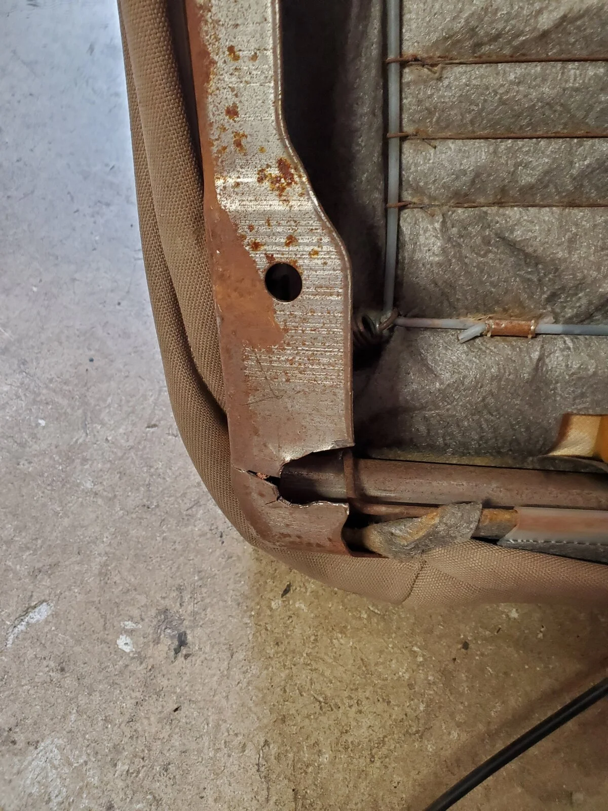

I have a nice set of sahara seats only issue is the base of the seat is cracked out where it attaches to the slider. I will attach a pic for reference. I'm thinking of welding a small plate top and bottom is there a better way?
It's really thin metal, you should only need to weld to one side of the frame- saves you the trouble of taking it apart! I'd also add washers to the other seat bolts to keep everything level with the new plate.
Reactions: P man
Hammer it back straight, then weld a plate on the inside of the frame. This will avoid having to add washers/spacers to the other 3 bolts.
Reactions: P man
It really is thin there I've never had this issue before so I never noticed
