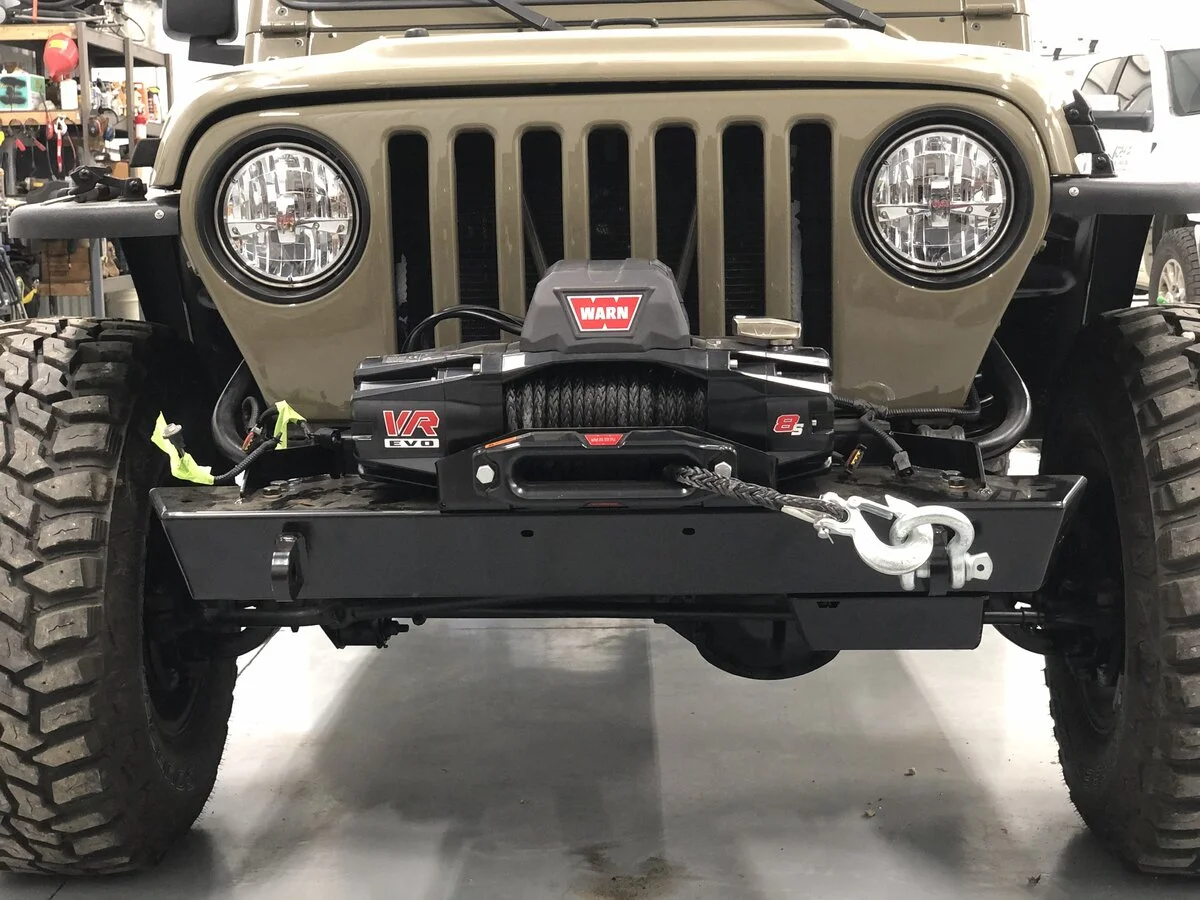

Got my WARN sliders mocked up tonight. Should be fairly quick work to get these installed. Liking the look, wishing they made a little more coverage. About 4” in the front and 6” in the rear left exposed.... :unsure:

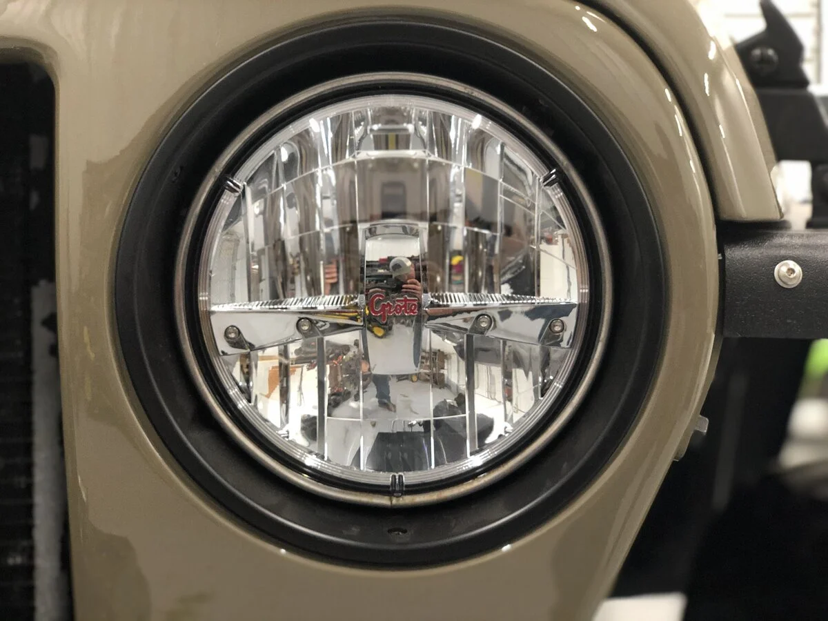

Great day in the garage! Got the WARN rock sliders installed, finished up the wiring on the winch and installed the Grote Industries LED lights. Super pumped to have these lights on the rig. As an Indiana guy, as Grote is located in Madison, IN, it feels good! I will be installing their flush mount brake, reverse, turn signals in the rear soon.
