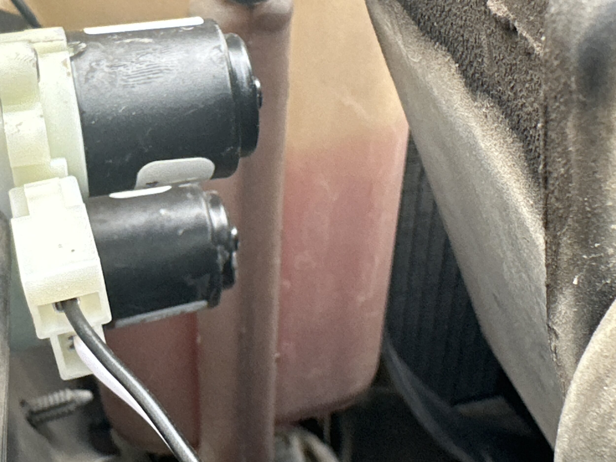

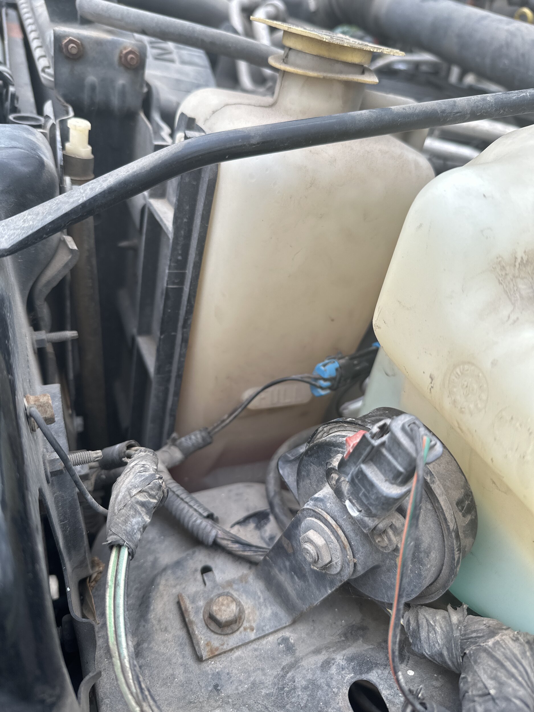

The only thing that I’ve changed is the oil, it does have a bad oxygen sensor, but I’m going to get that replaced. The coolant level has been the same since I purchased it and I will post a picture of that below.
That’s the overflow, have you opened the radiator when it’s cool?
