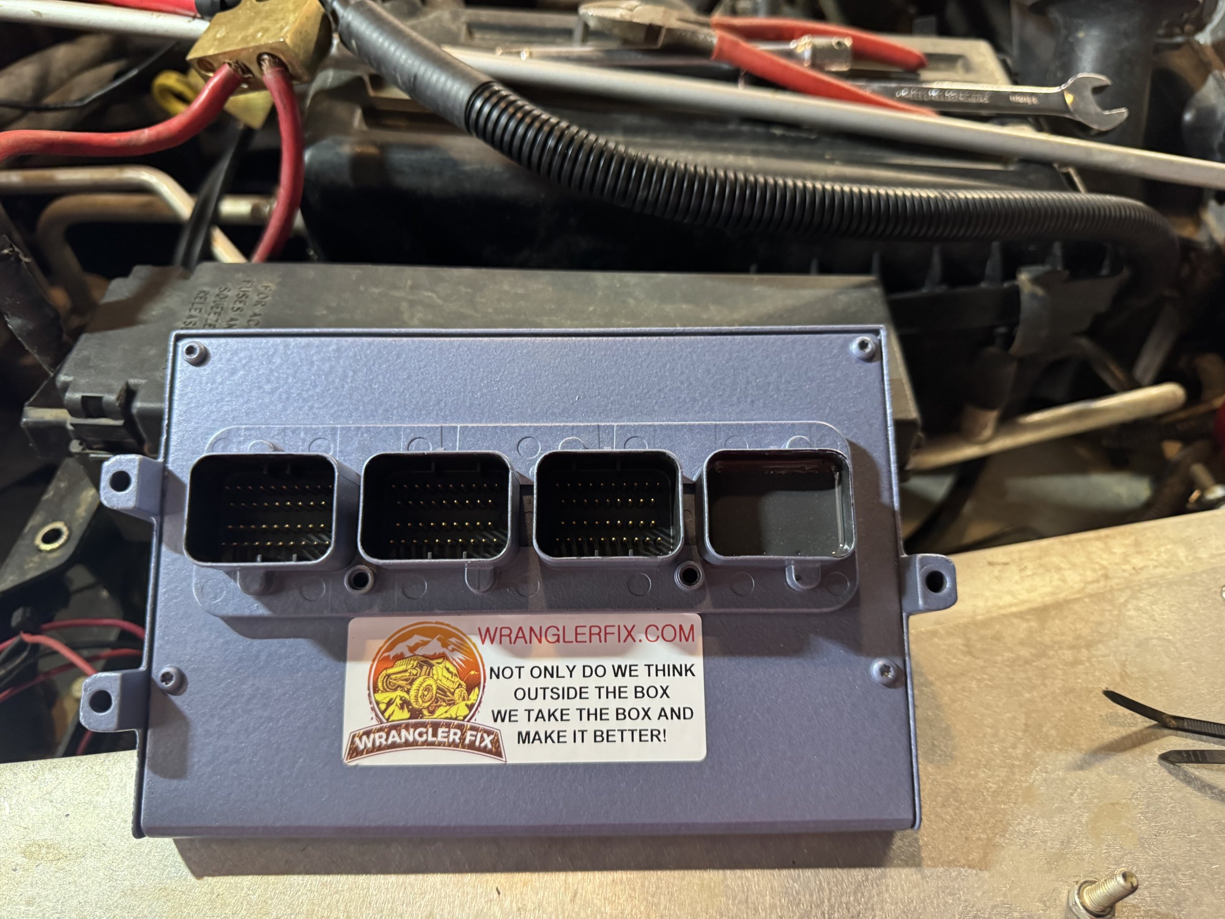

An update on the PCM swap...
The new PCM came in very quickly and the swap was as easy as anything I have done on the LJ.
Before the swap, I polished my battery terminals and grounds. I checked every electrical connection I could find. Grounds, etc. All seemed fine.
The LJ fired off and has ran/idled as well as it ever has.
A few miles into the test drive, the check engine light reappeared. The P0517 code is still there and now P0141 pops up.
WranglerFix.com has already warrantied the original PCM and is sending a replacement. If the codes show on the new PCM, then there is no doubt that I will need to address those issues accordingly. If not, the new PCM is all I will need.
