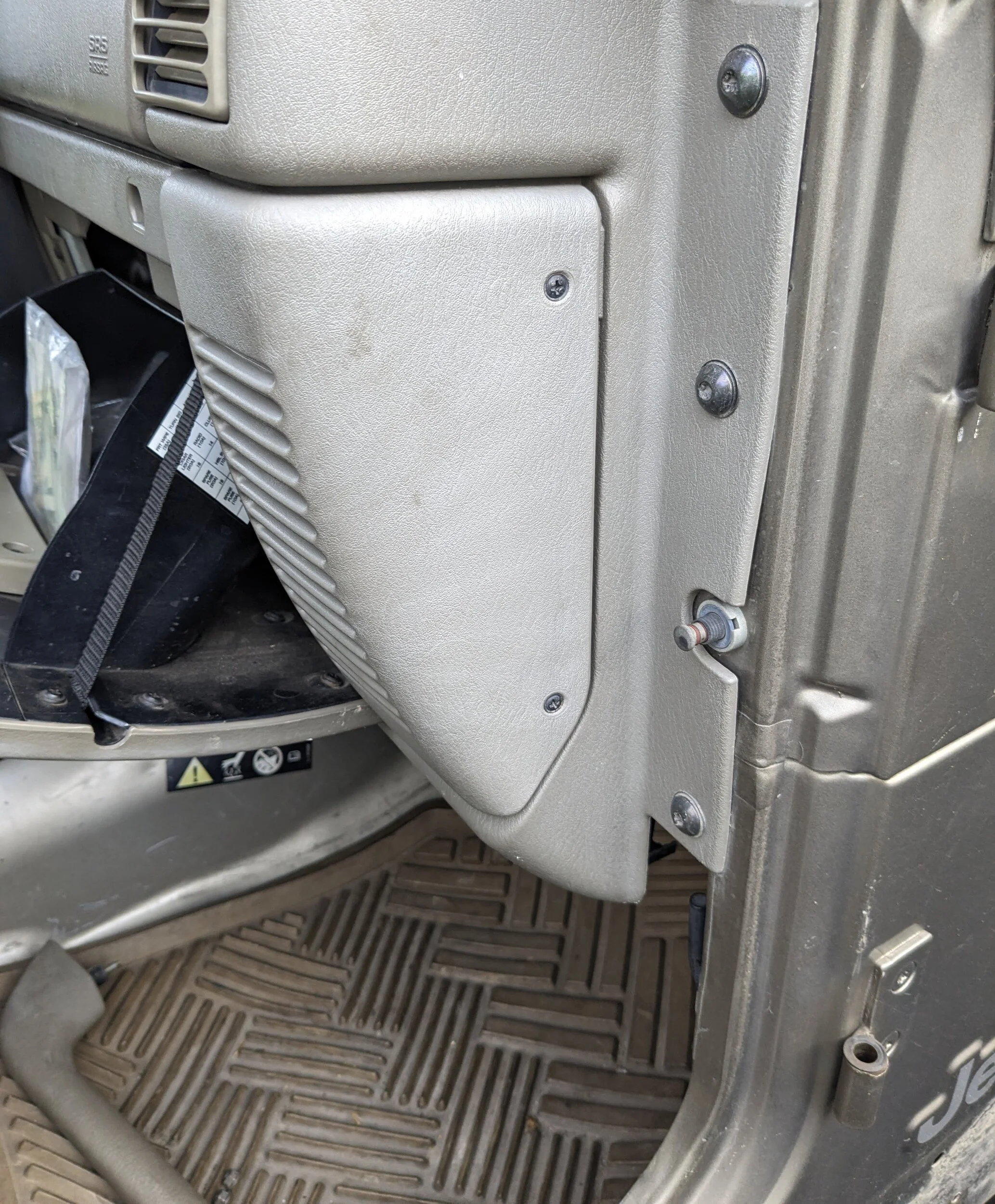

For those who said that the heatgun approach to removing plastic 'ashing' is a short-term solution...
It appears you're right.... :cautious:
Speaker covers are starting to show the same lines after only a few rides out in the sun.
I told the wife that I'll be looking to paint the full dash next spring or the year after, depending on how things align.

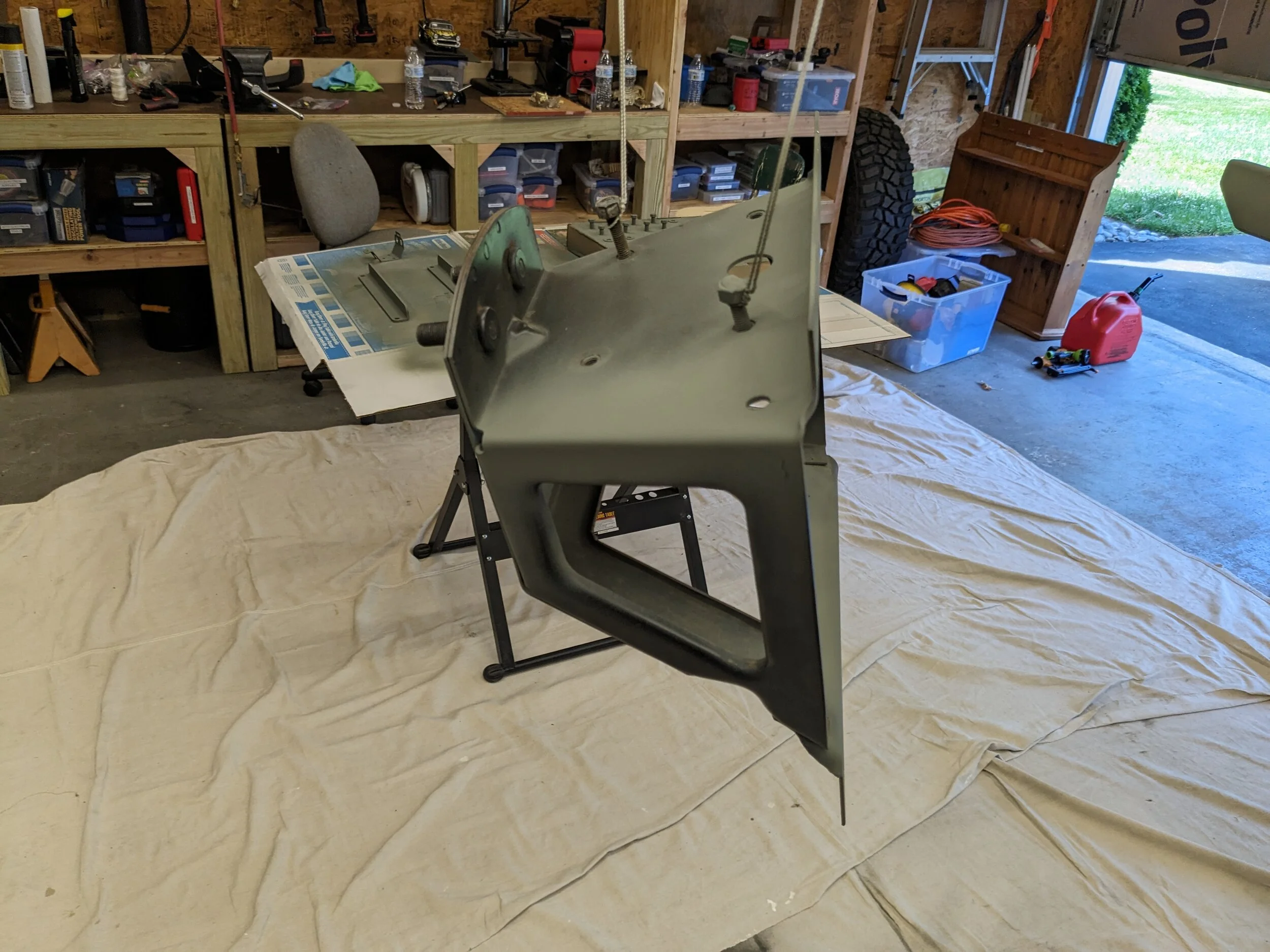

Went to install the phone holder the other day and found this...
Primer is showing through the black paint and this would be there the passengers enter and would really bother me.
Learned not to use the string from the ceiling for small/light parts... Just use a flat surface...
So today I threw down another coat of black and matte clear. It's drying today. May try to finally get it installed tomorrow.

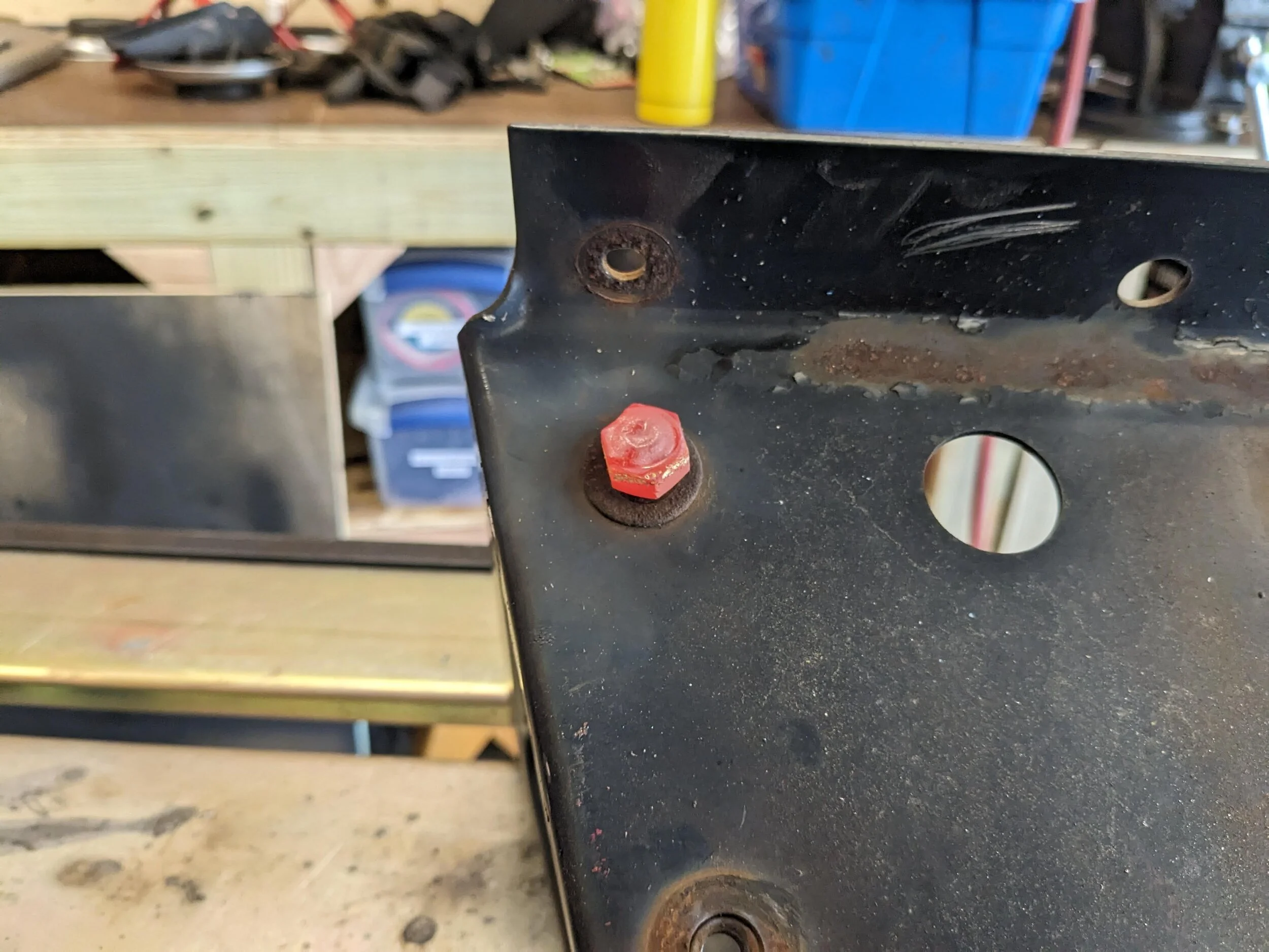

Pulled the tire carrier off for the first time since Homer was built. So if you're curious, here is what the paint condition looks like after 19 years and 156k miles:
Paint will get cleaned up before the MORryde hinges & tailgate plate get installed. Bolts came out with a little patience but they're rust-worn where they went through the bracket so new hardware will go back in when the time comes.
I had spaced the brake light lifted up with 1" nylon spacers (to clear the old 33s) but the hardware rusted over time to the bracket.

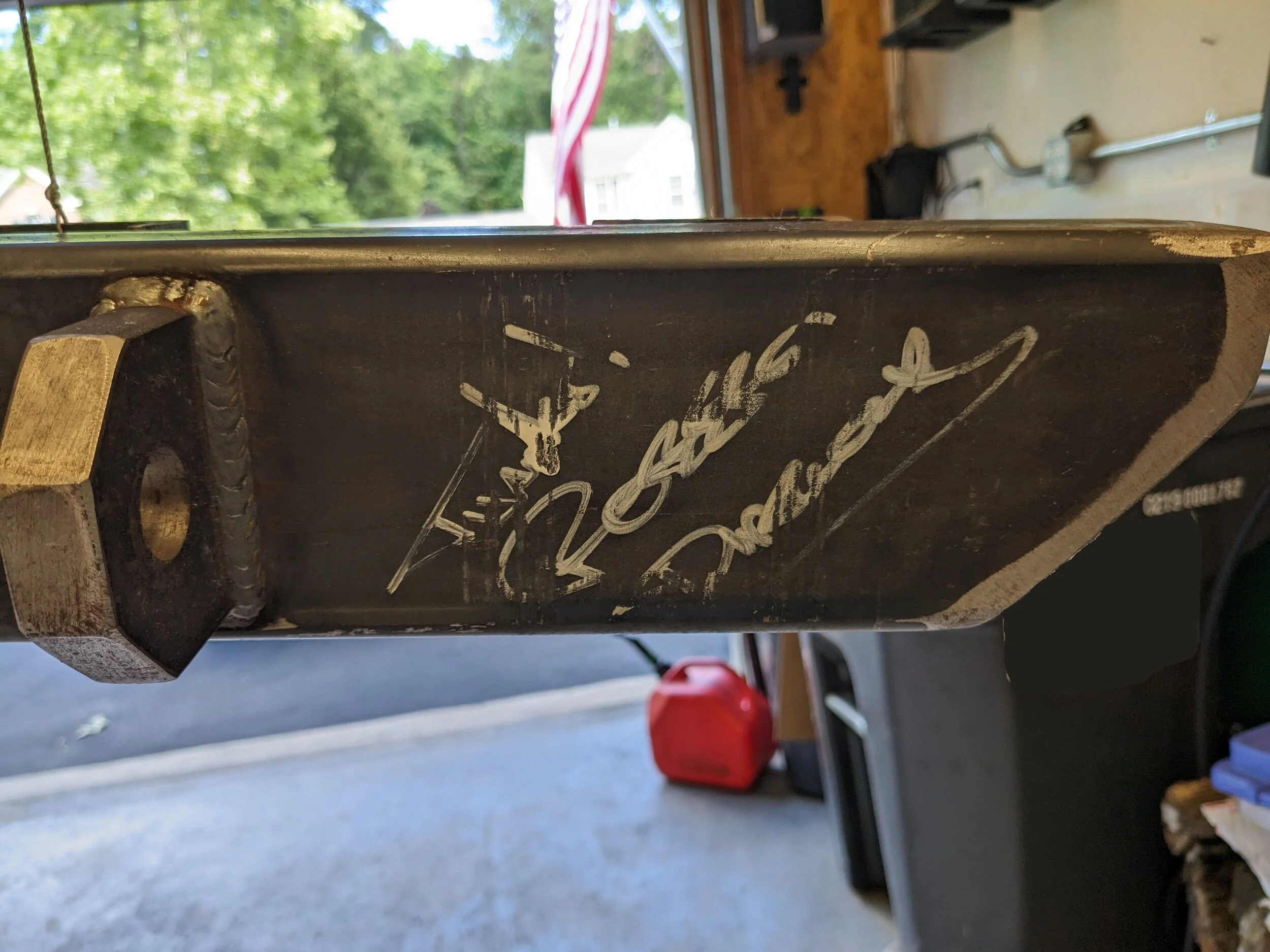

When I first received it, I enjoyed seeing the personal touch that Robert at DirtWorx adds:

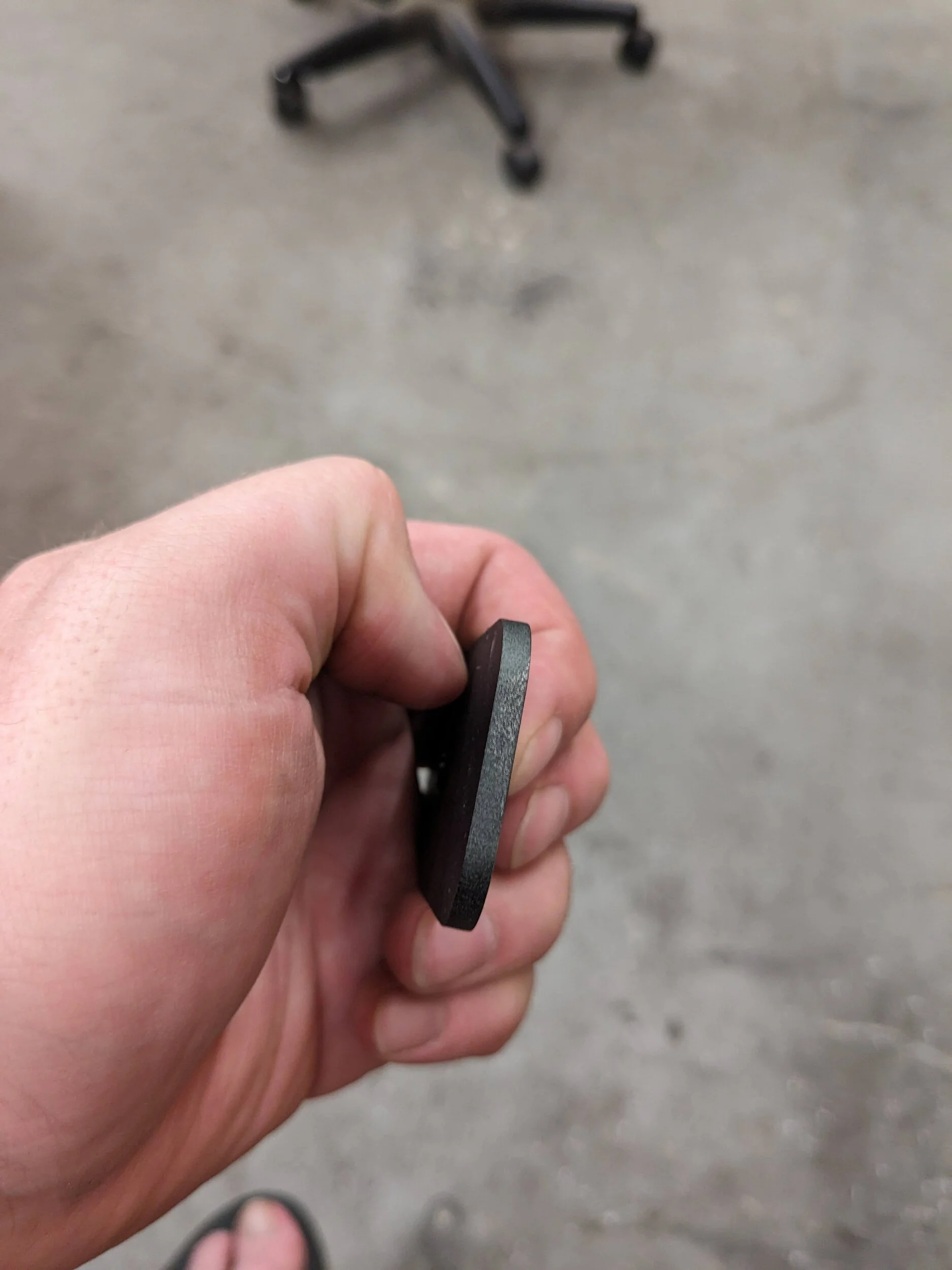

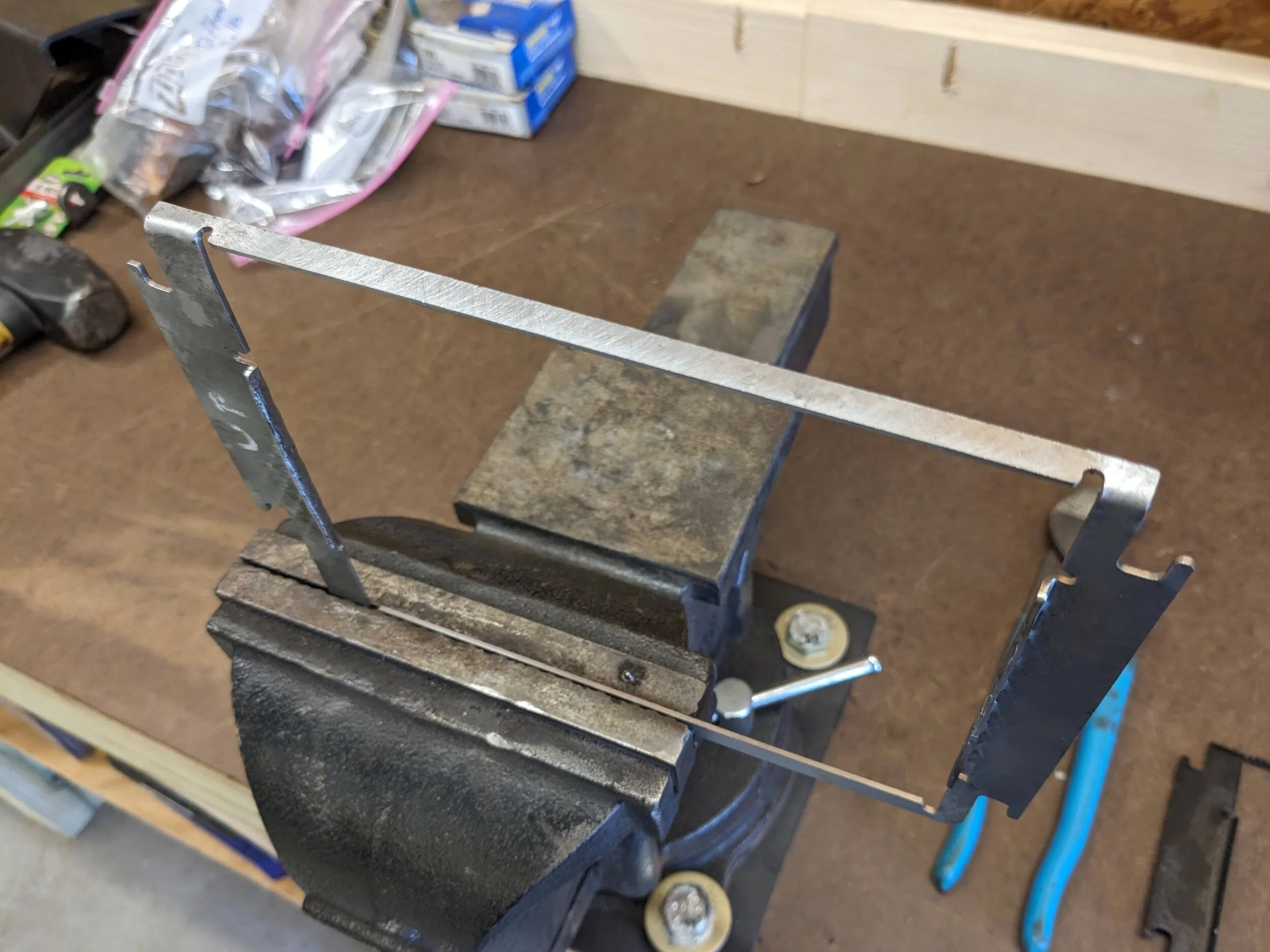

Been planning a 'How To' for the Forum on a replacement if the shift boot mounting bracket breaks. It's think metal and I figure over time this will happen for folks.
I created a CAD and had ordered 2 replacement pieces from Send Cut Send.
First try to bend it:
Bending went really well but the exact positions of the bends gave a little tighter fit than OEM backet. So I'm going to try again on the second blank.

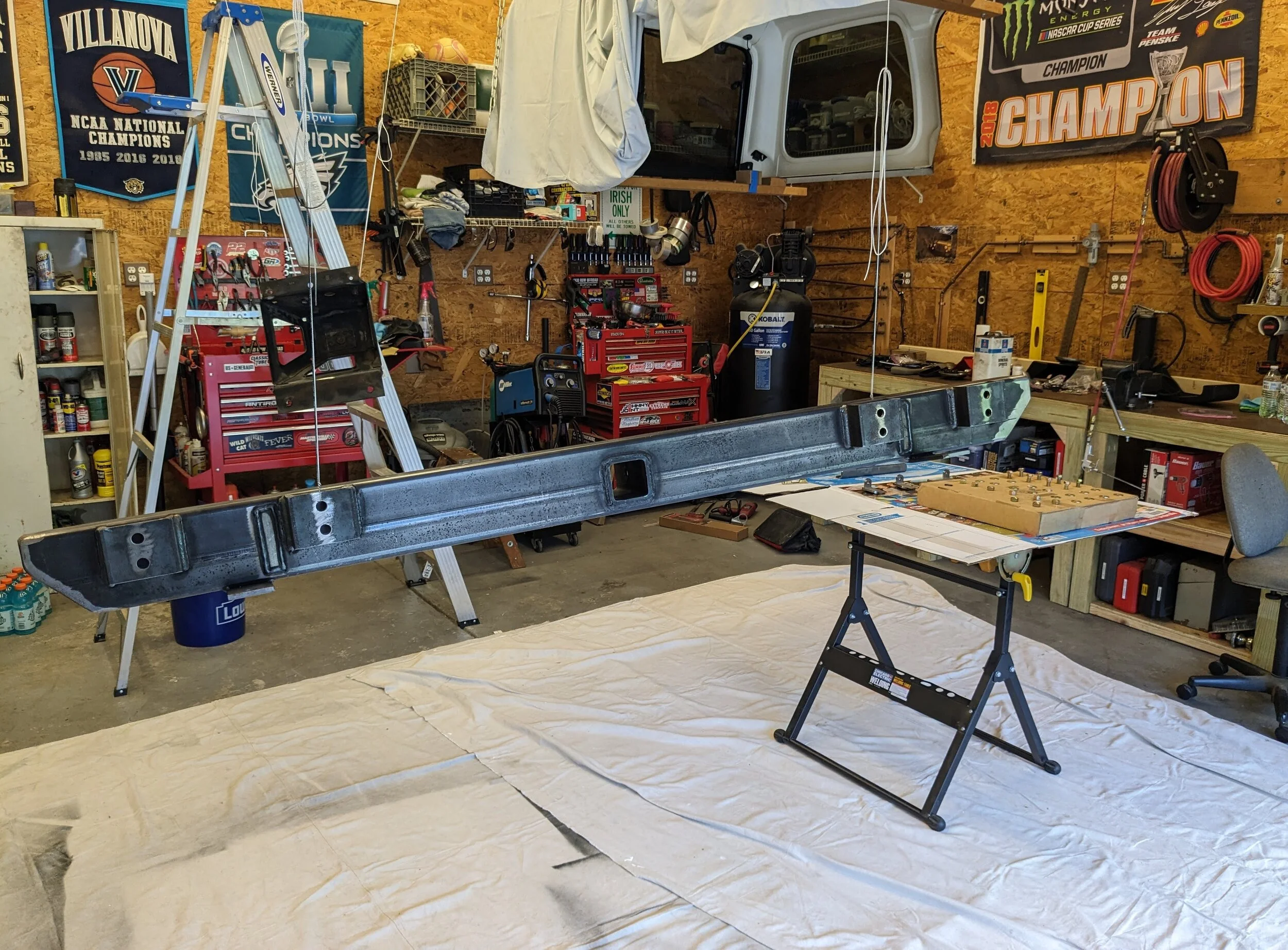

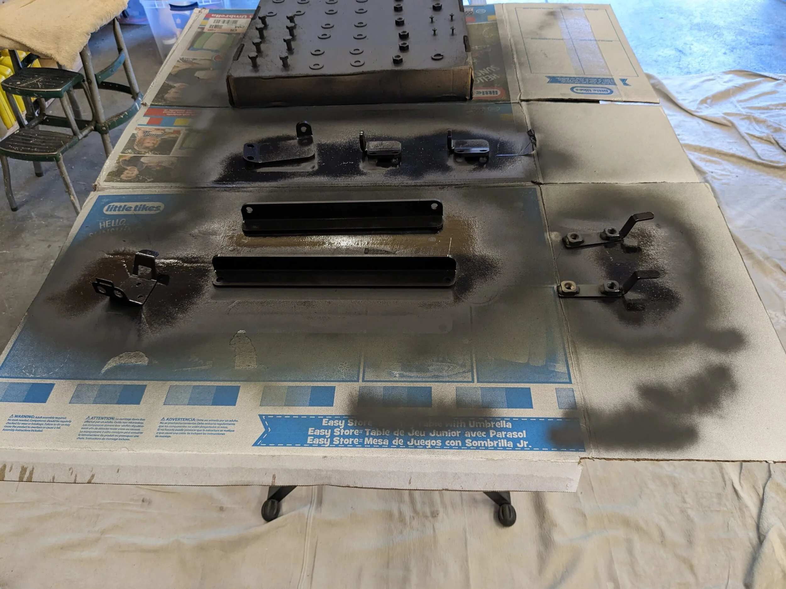

Primed. Only hit the raw metal on the tire carrier.
Flat black coat #1
I'll go out in 20 min for coat #2. I'm staying with the 'coat within 1 hour' on the can while letting coats dry as much as possible. Trying very hard to not get drips while still getting in all the holes & small inner spaces of the brackets.
Coat #2 complete.

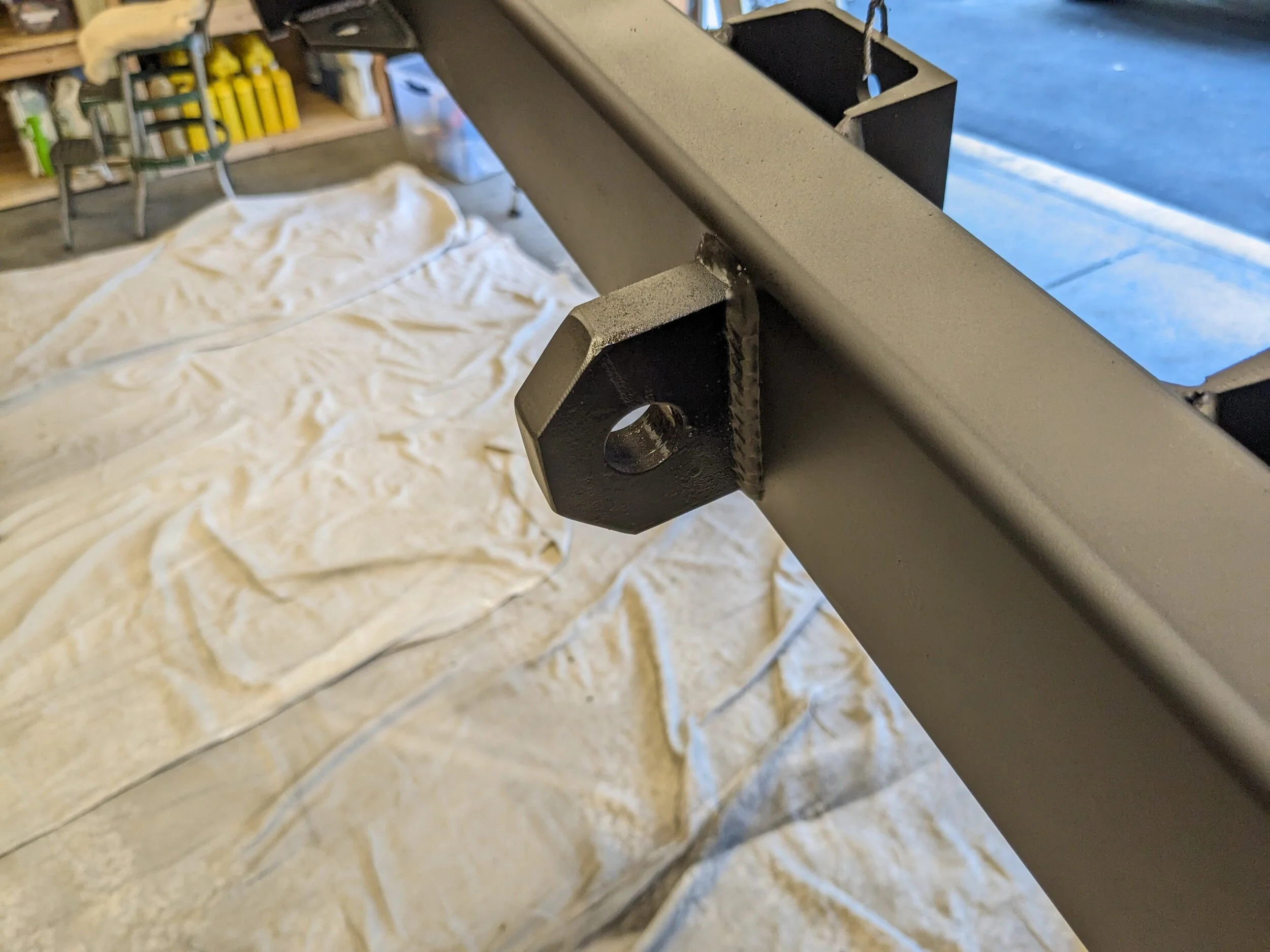

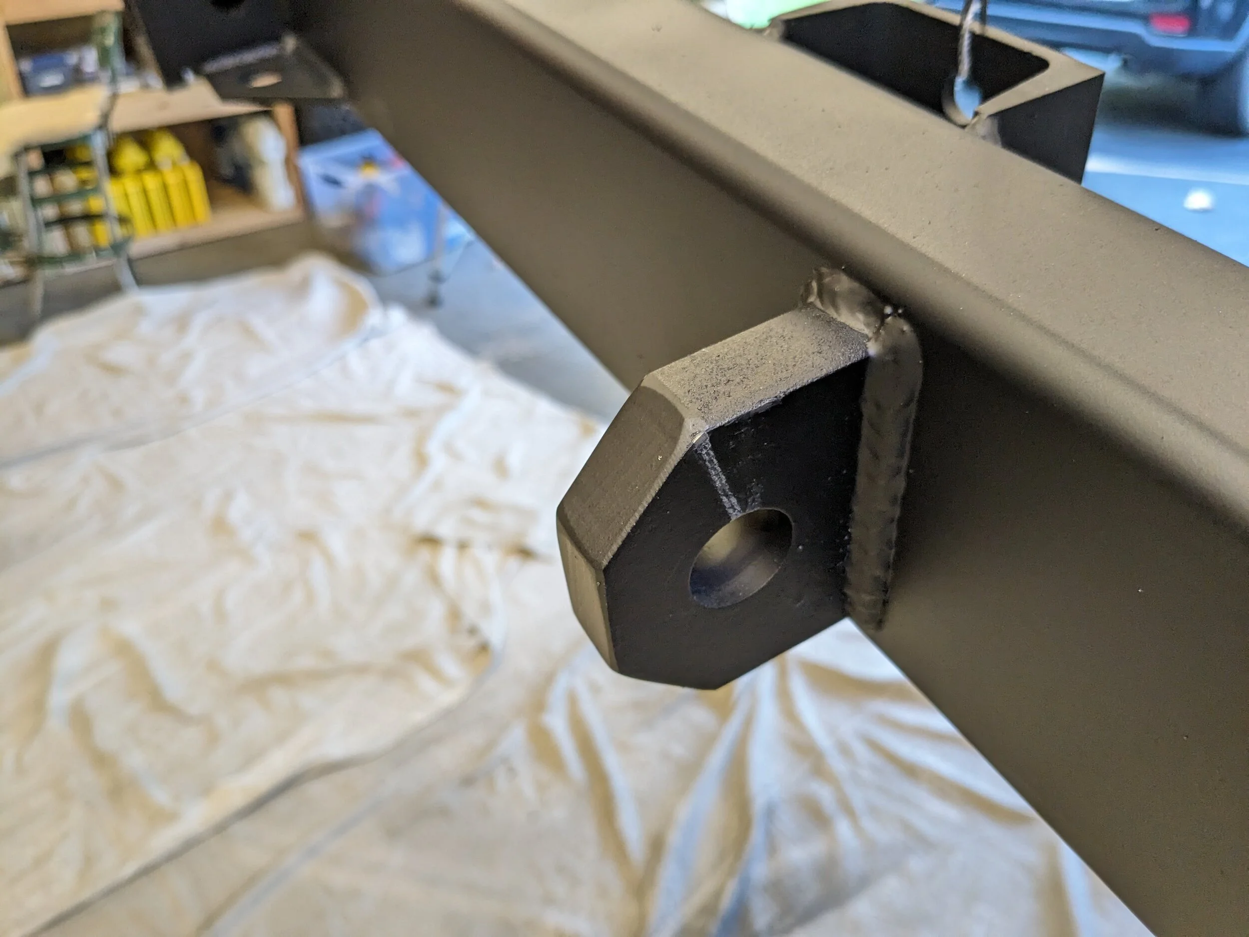

Had an "Ah, Damn..." moment just before second coat when I suddenly recommended I wanted to round out the edges of the recovery points in the bumper to accommodate soft shackles... 😧
I test for the WRG shackles and I'd need to remove so much material to make them fit through with any level of ease (as the current hole diameter is way too tight of a fit) that I opted - "That's a problem for future Mike..."
I'll see if it becomes something I want to get into down the line based on future experience with the soft shackles as I haven't used them yet.
My rear recovery has been a D-ring adapter in the hitch so having these two points is an upgrade to start with...

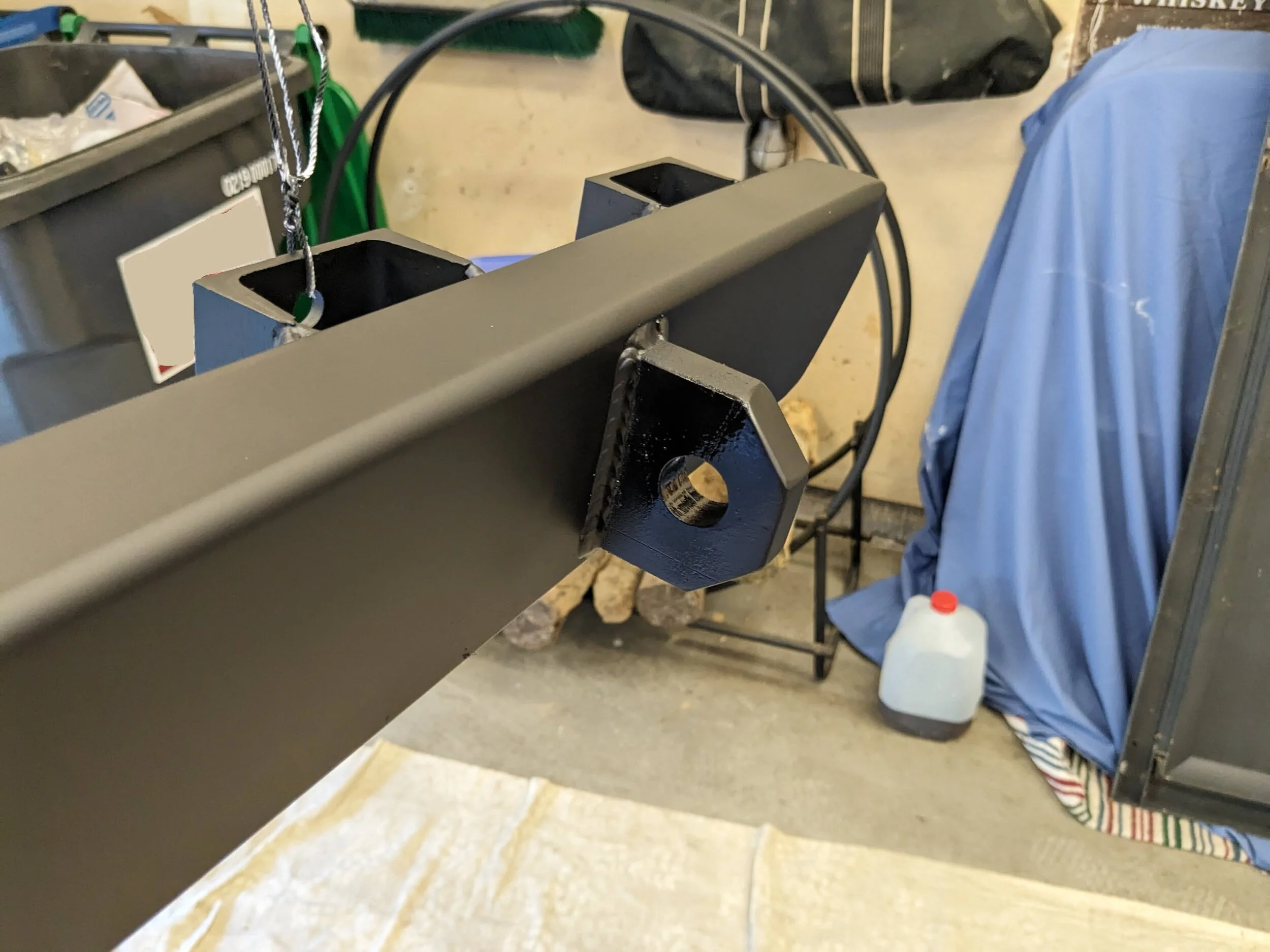

Coat #3 is done.
Hardware got 2 coats. It's done with color. Brackets need to be flipped & hit with color.
Three coats on the tire carrier. It's done.

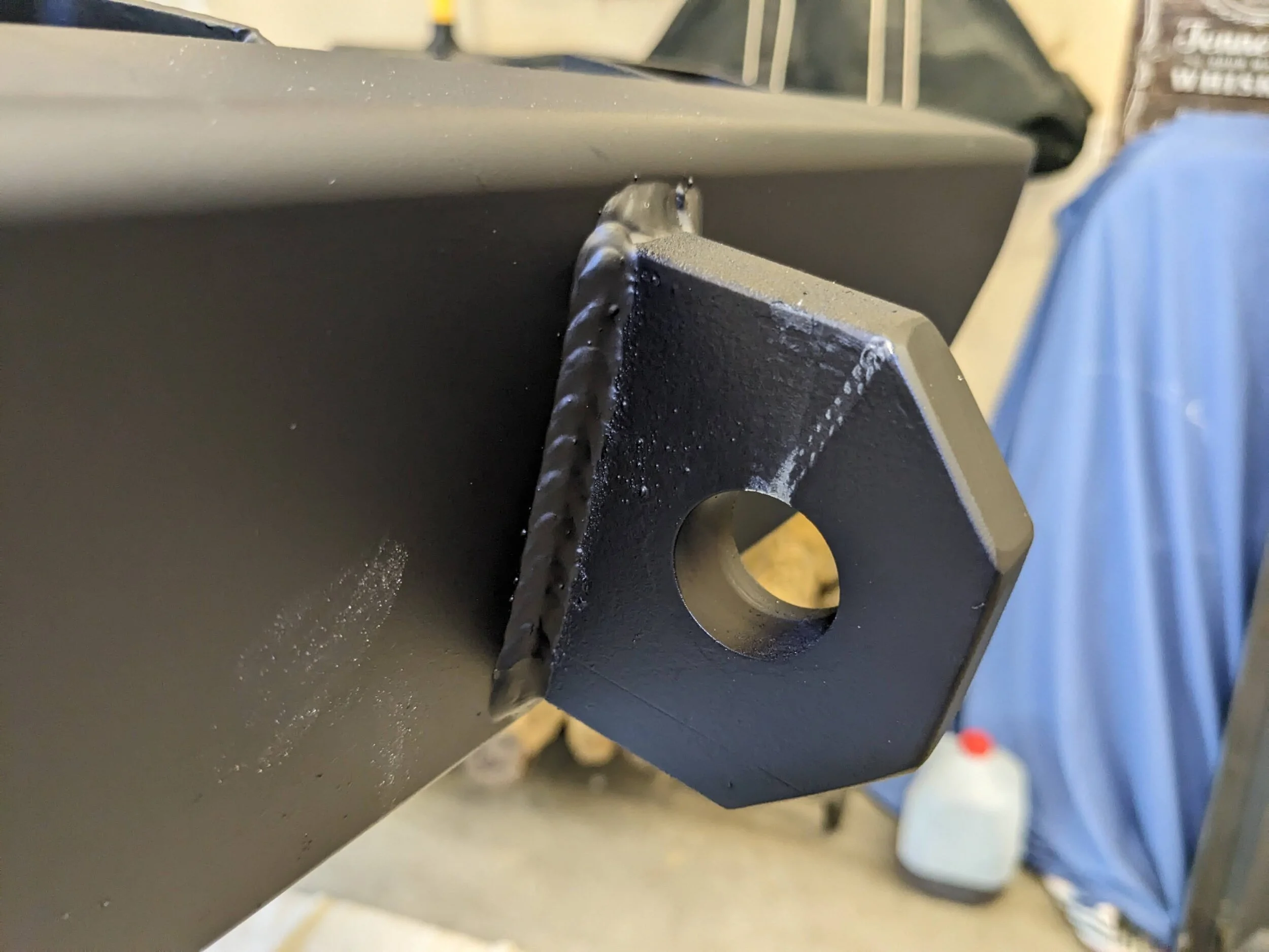

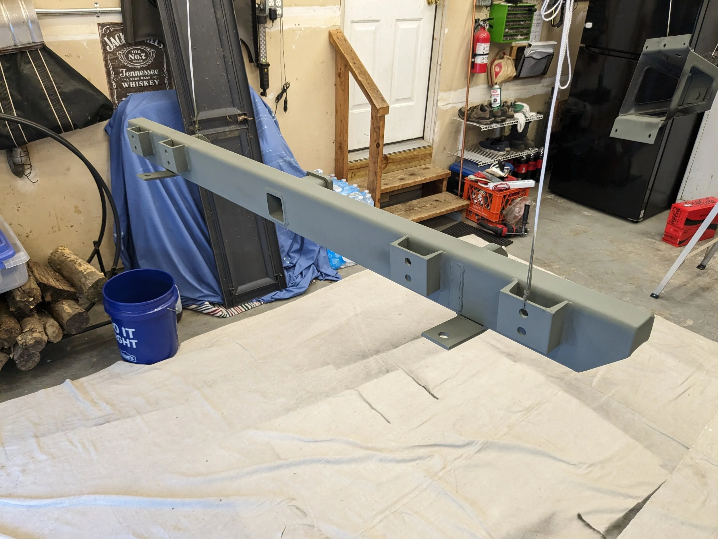

Bumper looks good with 3 coats. I'm going to let it dry and check for any bare spots - the glossy wet paint makes it hard for me to see bare or thin spots.

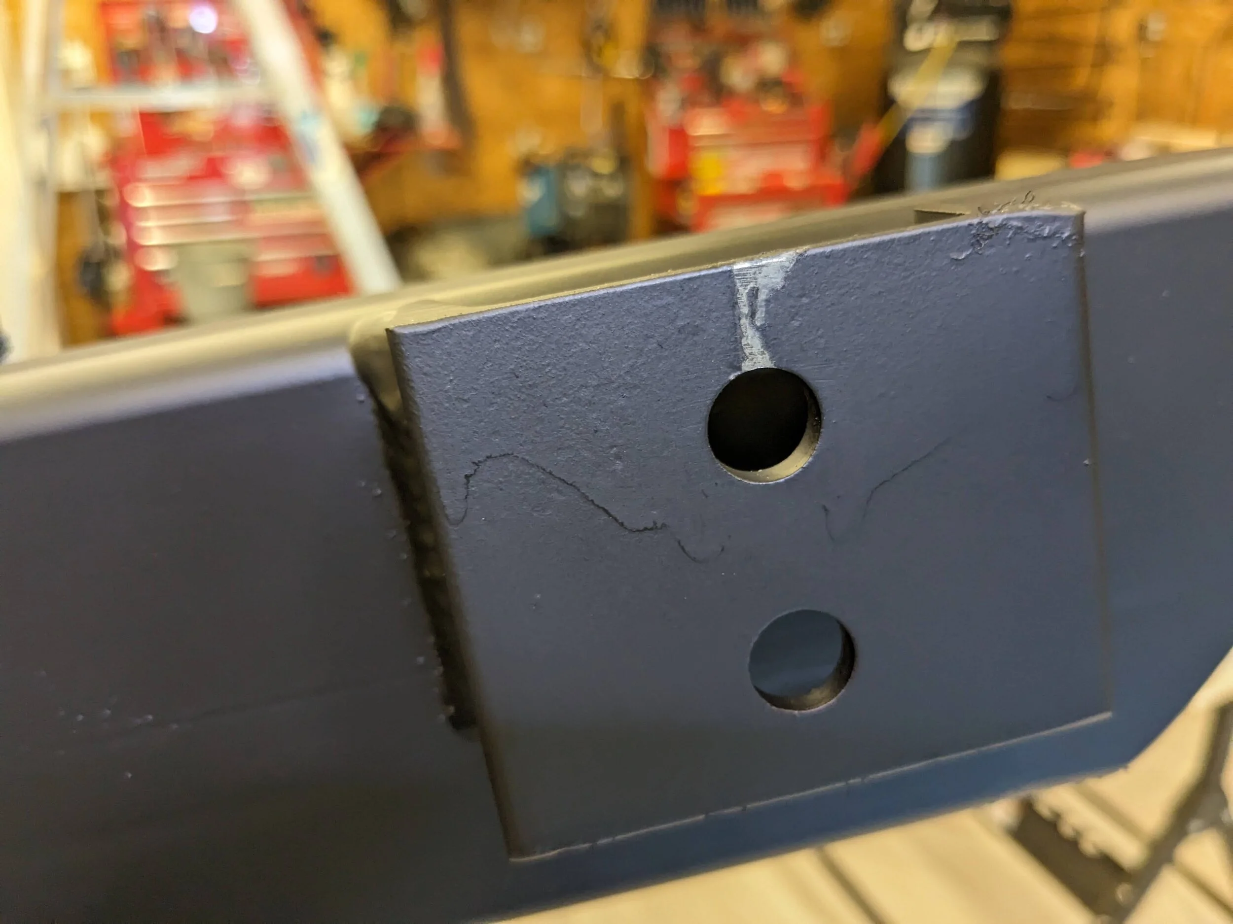

Had Samuel L Jackson in my mind: "Mother F$%^er"....
Caught this edge of the bumper with my shoulder as I came up after spraying the bottom of the bumper... Got too cocky...
Hopefully it dries okay and doesn't look stupid....

Looking good all dried up! I hit inside the mounting bracket inner-corners where it's welded to the bumper as that seemed to be the only bare spot.
Edge I contacted should be ok.

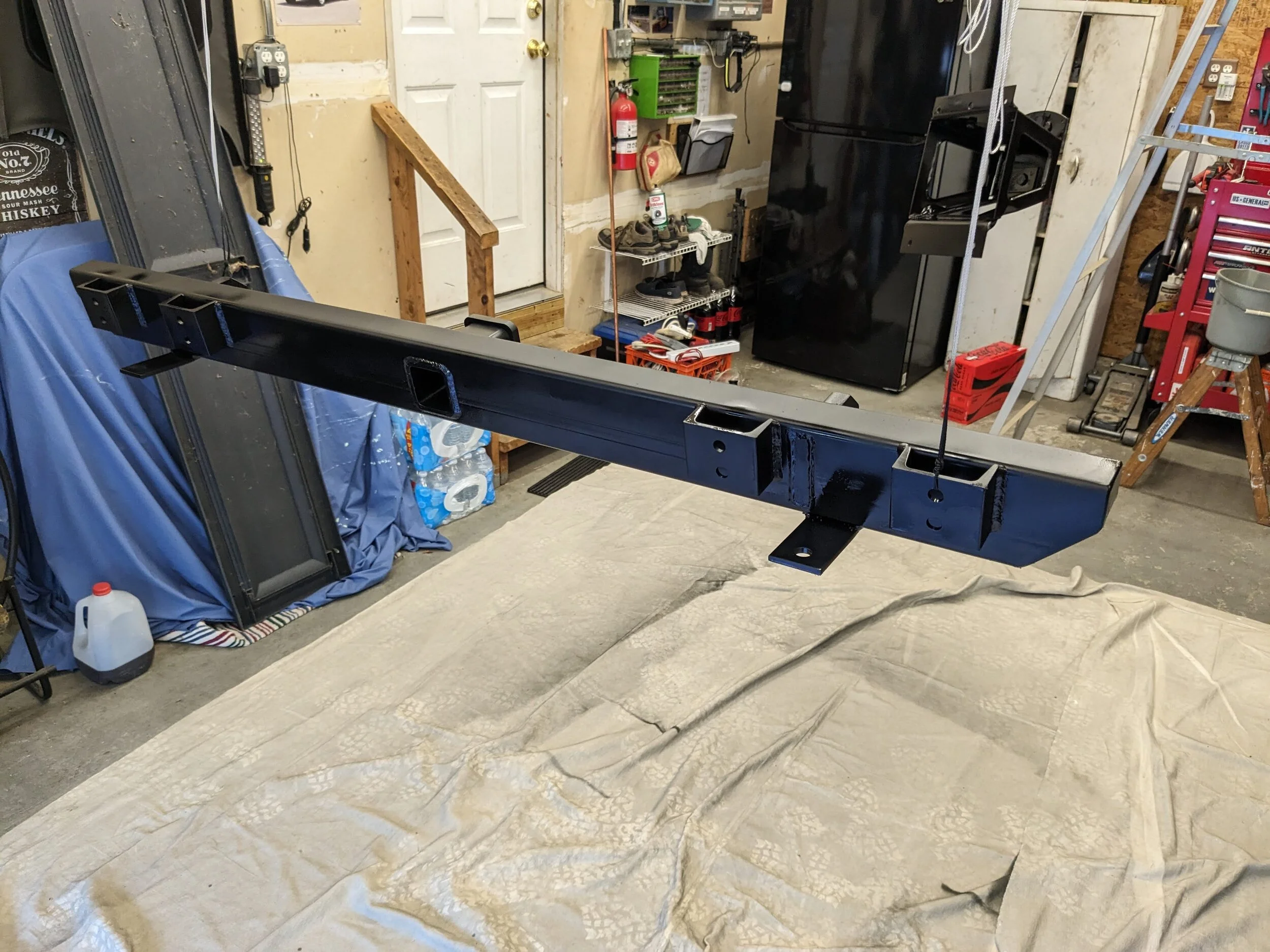

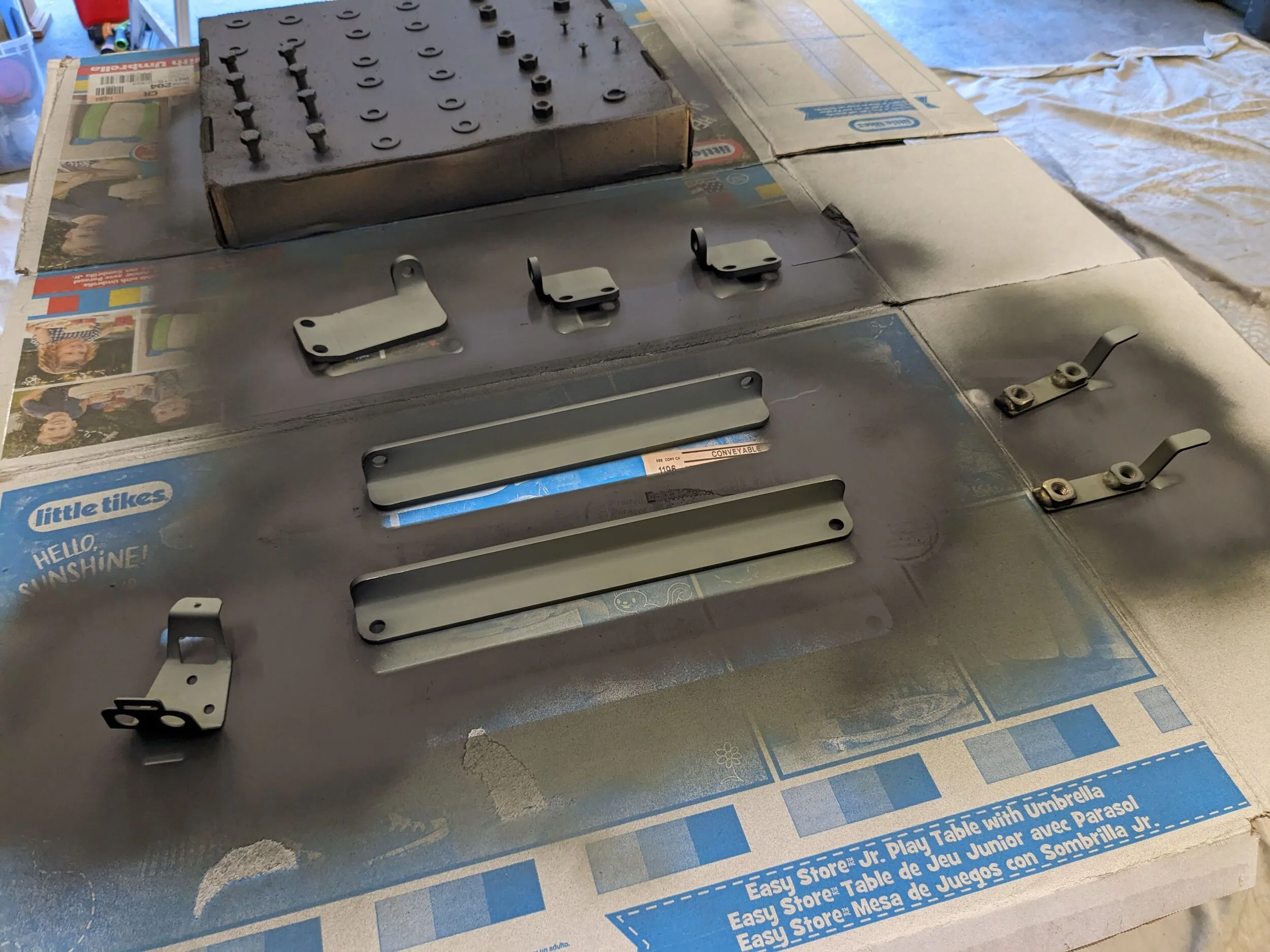

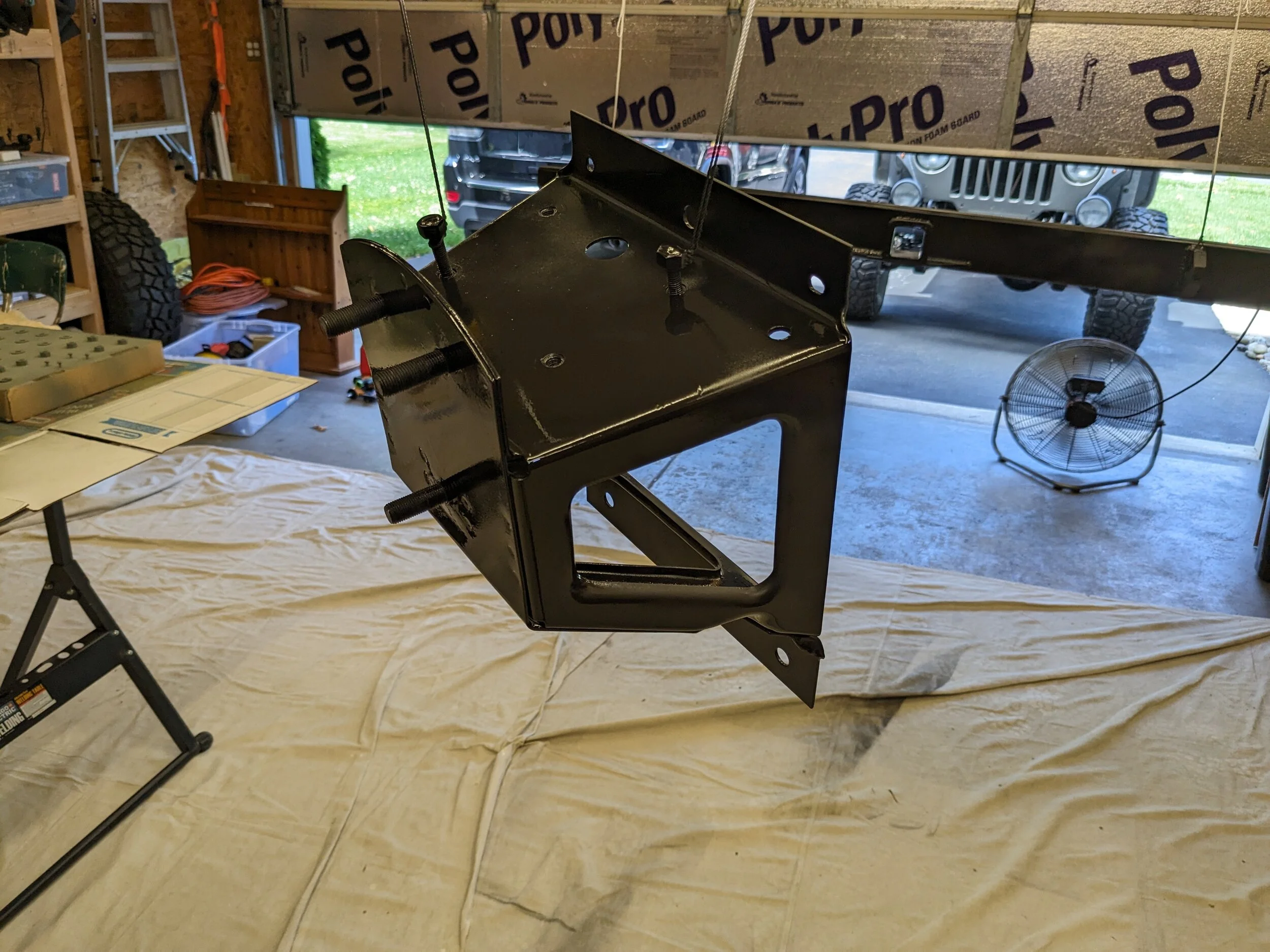

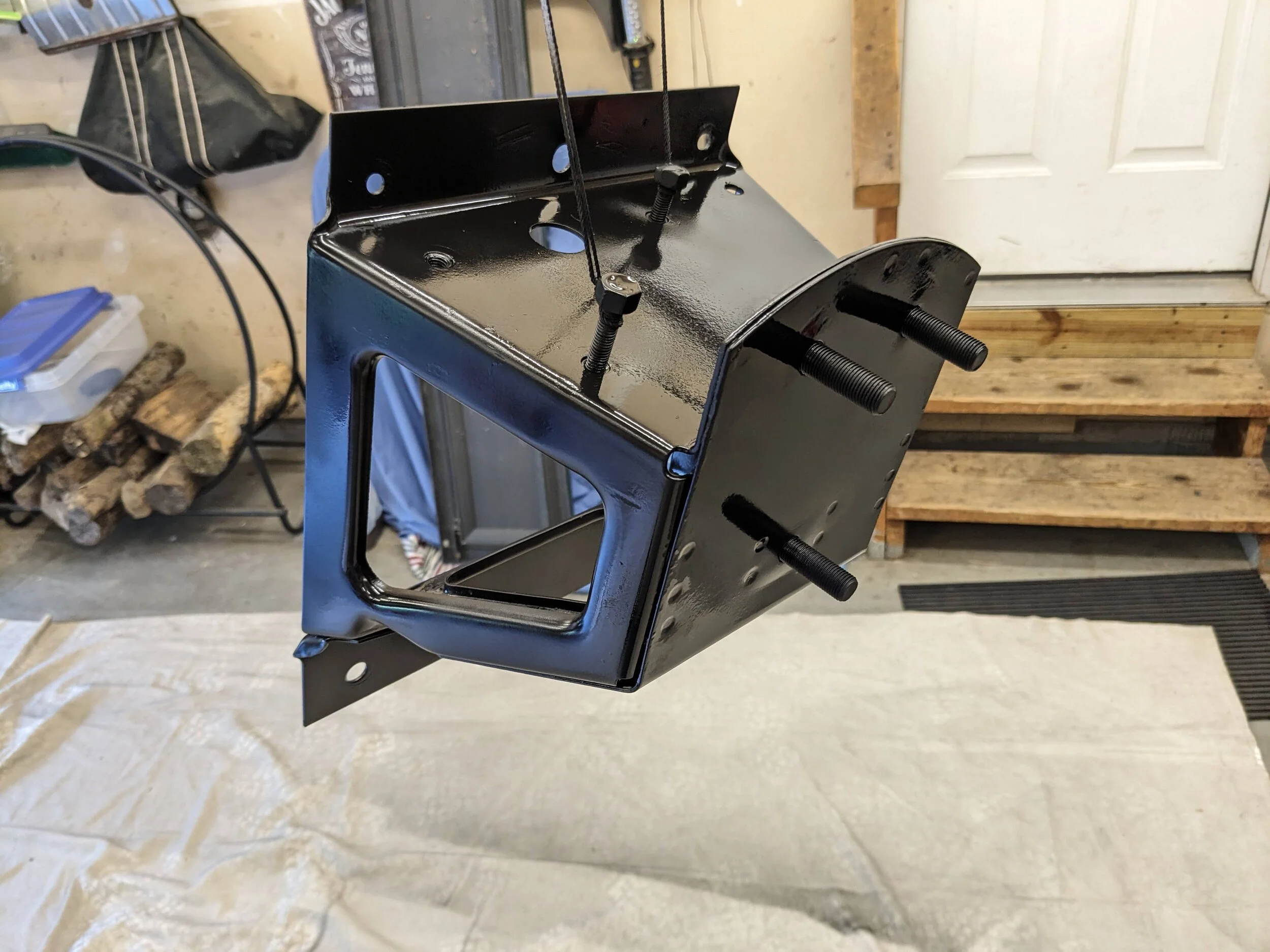

Filled the brackets and hit them with 2 coats of color.
Moved the string from front to back on both sides of the bumper and hit the spots covered by the string with color.
Got a little dripping on the mount brackets... They'll be hidden anyway...
I'm okay with the results for my first time hanging parts to paint. But I don't love the strings on the product. I'm thinking maybe some small diameter metal tubing to space out the string and create a single 'non-paint' spot within a mounting hole to be hit with brush after lowering the part.
I have to figure most auto painters are using wire since they're dealing with light-weight panels vs 40+ lbs. bumpers. Looks like a new topic to throw on the pile for research...

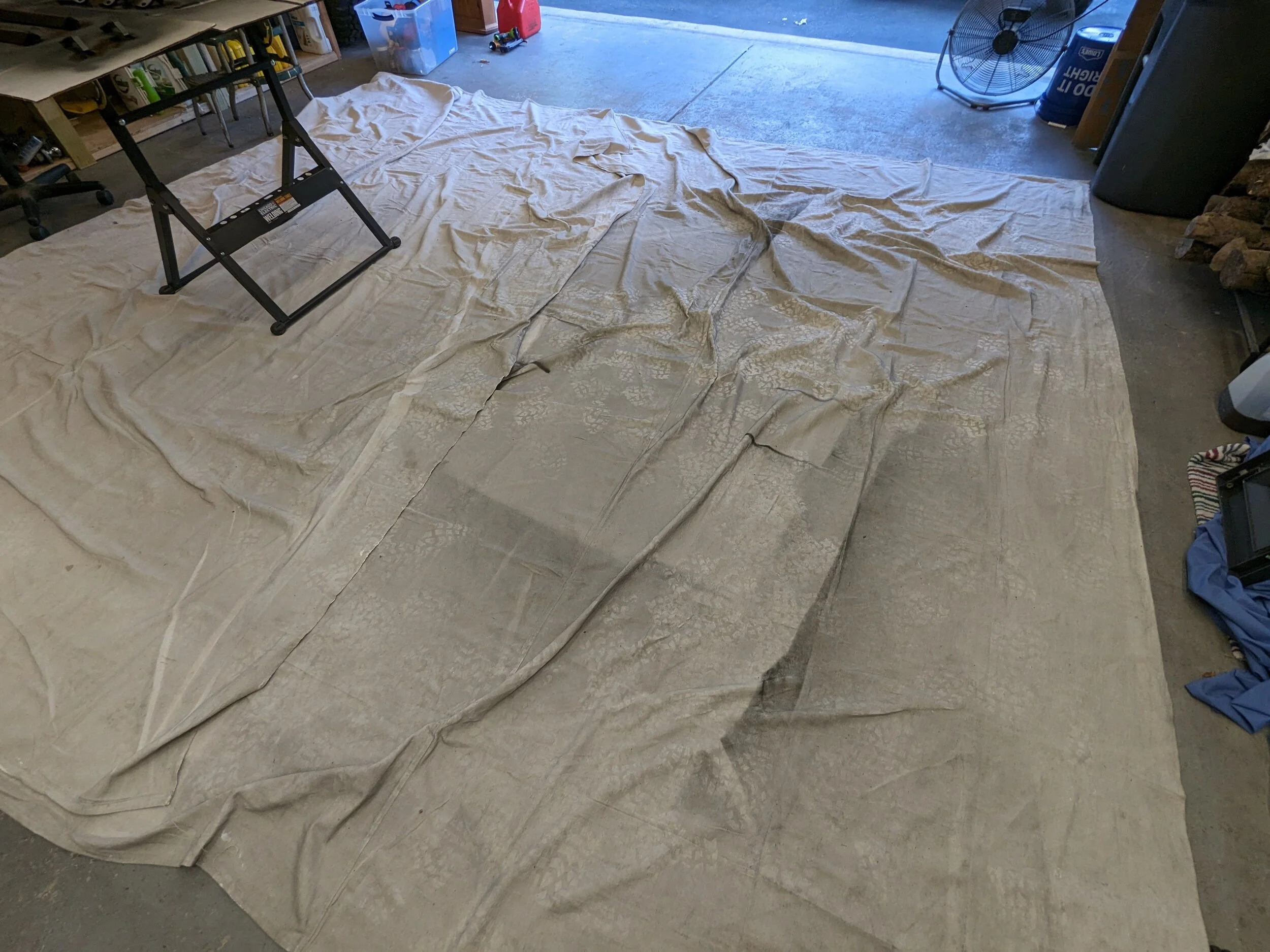

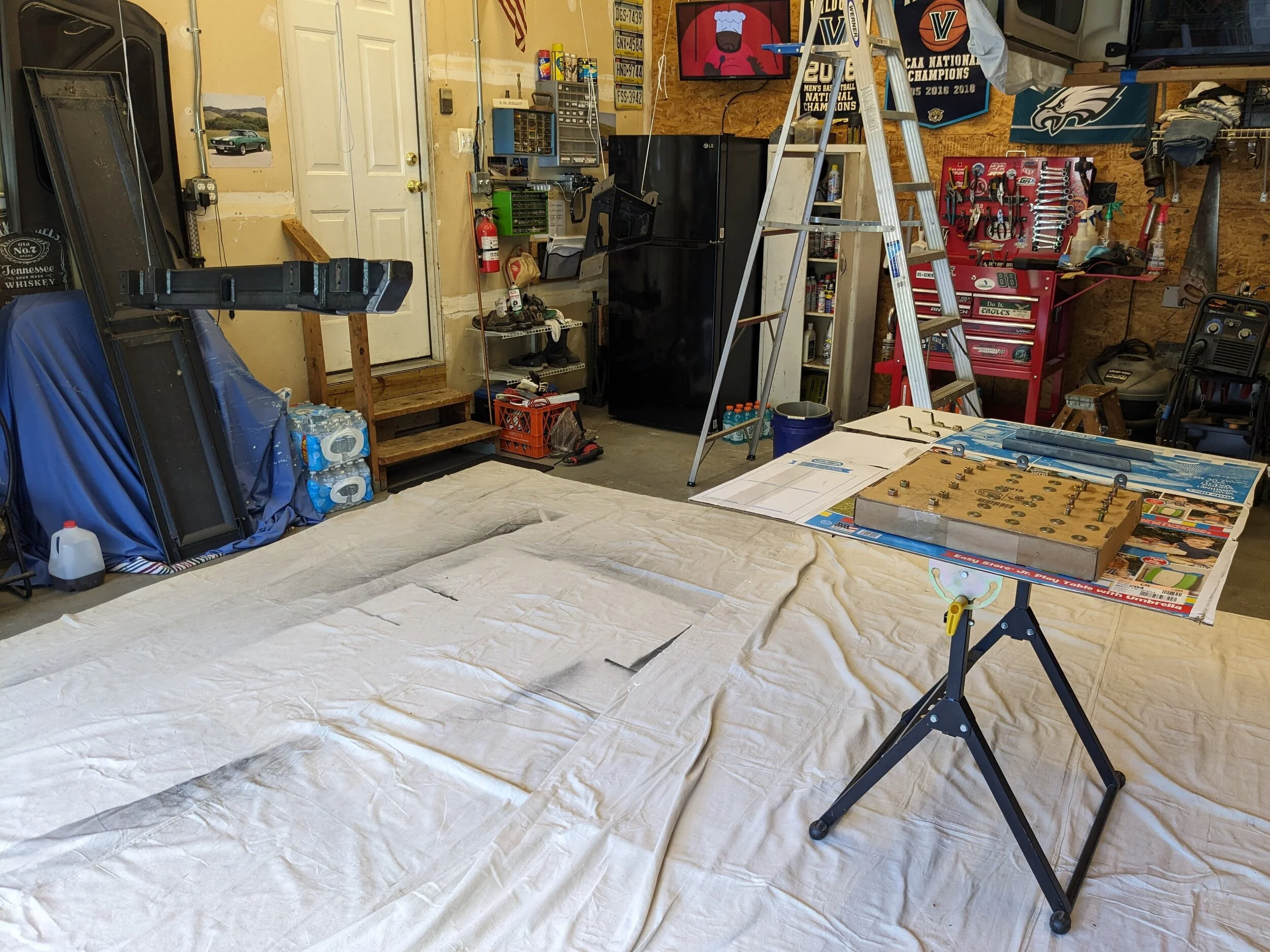

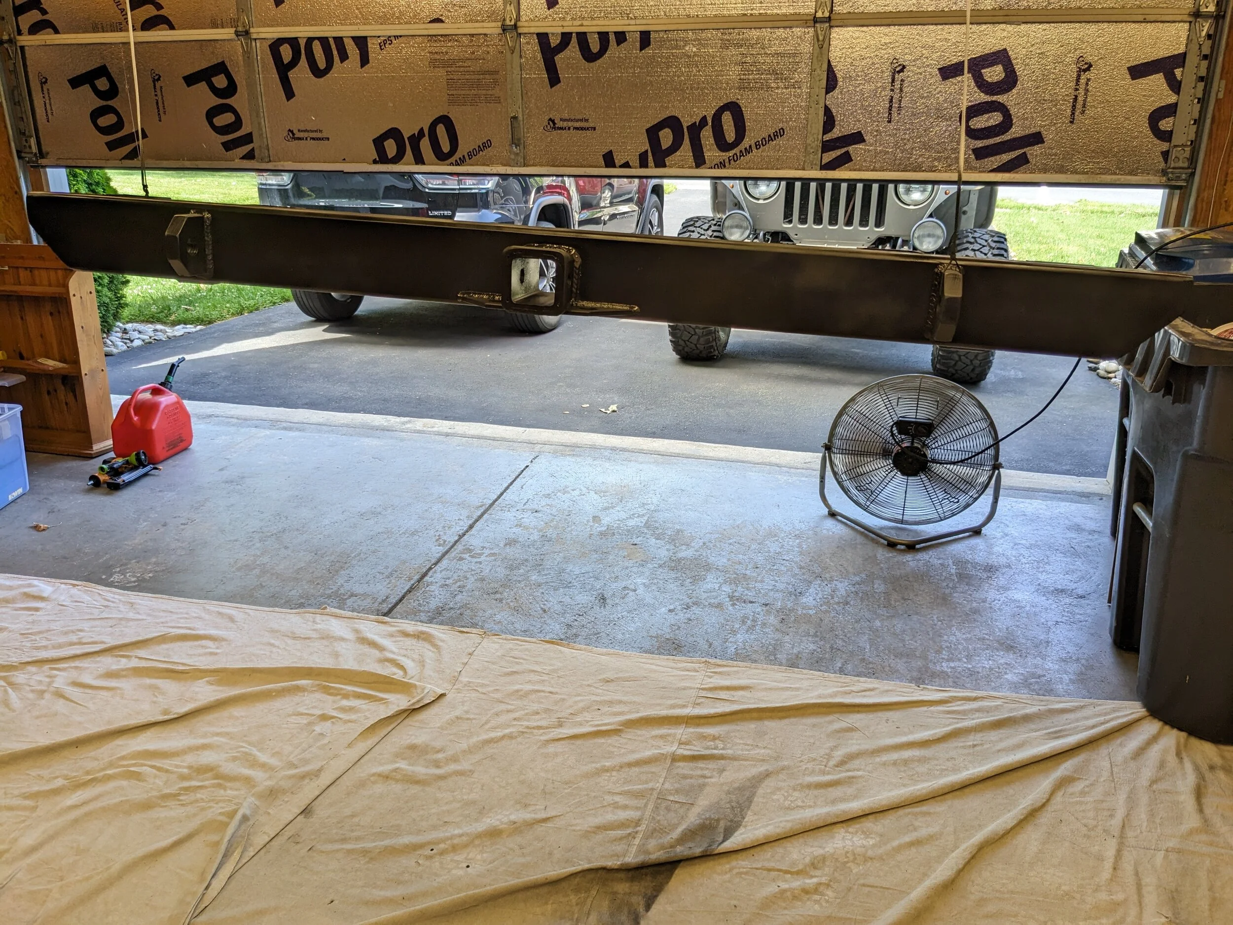

I've had over spray before, but damn....
Pretty much have overspray everywhere, even off the drop clothes. I can't tell how hard it'll be to get the garage back in order until after I clear coat everything as I'm not kicking up all that dust now...
Floor is noticeably sticky, even off the drop clothes.
I'll put this in the 'I'm learning' bin...
I get overspray everywhere when I was painting. I was amazed at where I got it sometimes.
