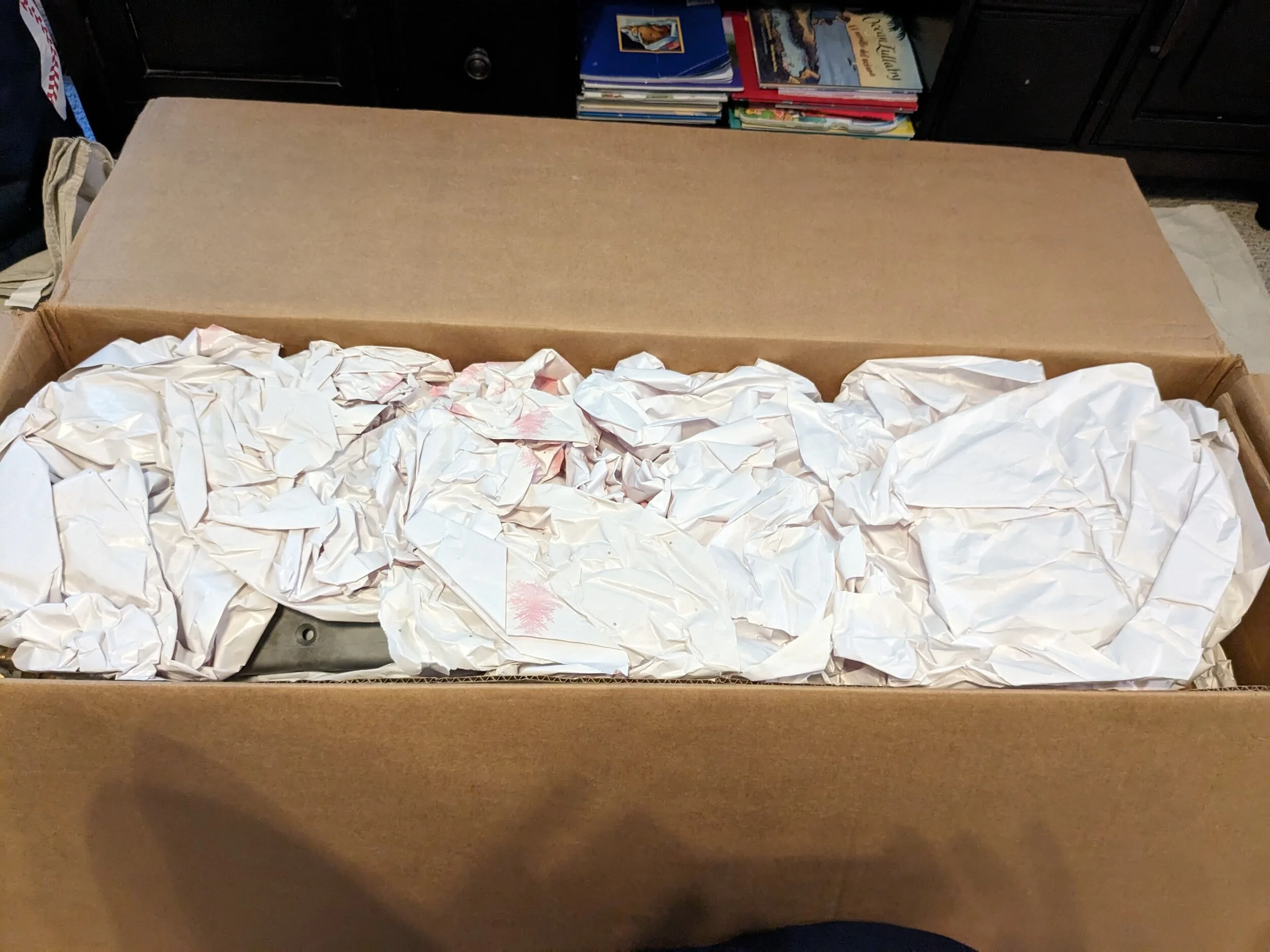

What is in the box?!?!?.....
:oops: :love:

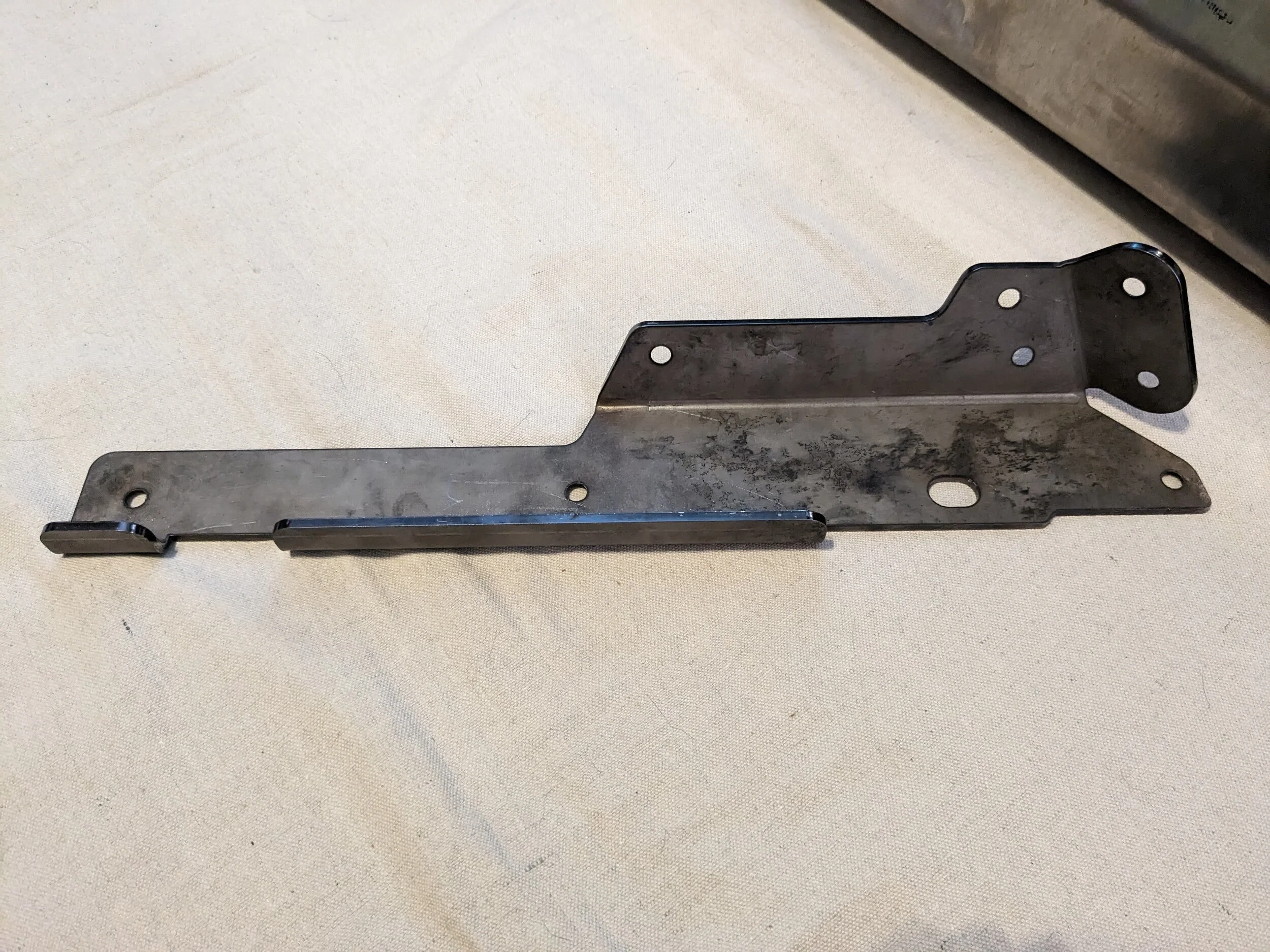

Fellow WTJF member opted on his own to drop to the second drop so I was blessed enough to be first in line on the second run and get bumped up.
Bumper:
Steel Corner Reinforcement Armor:
Winch Plate:

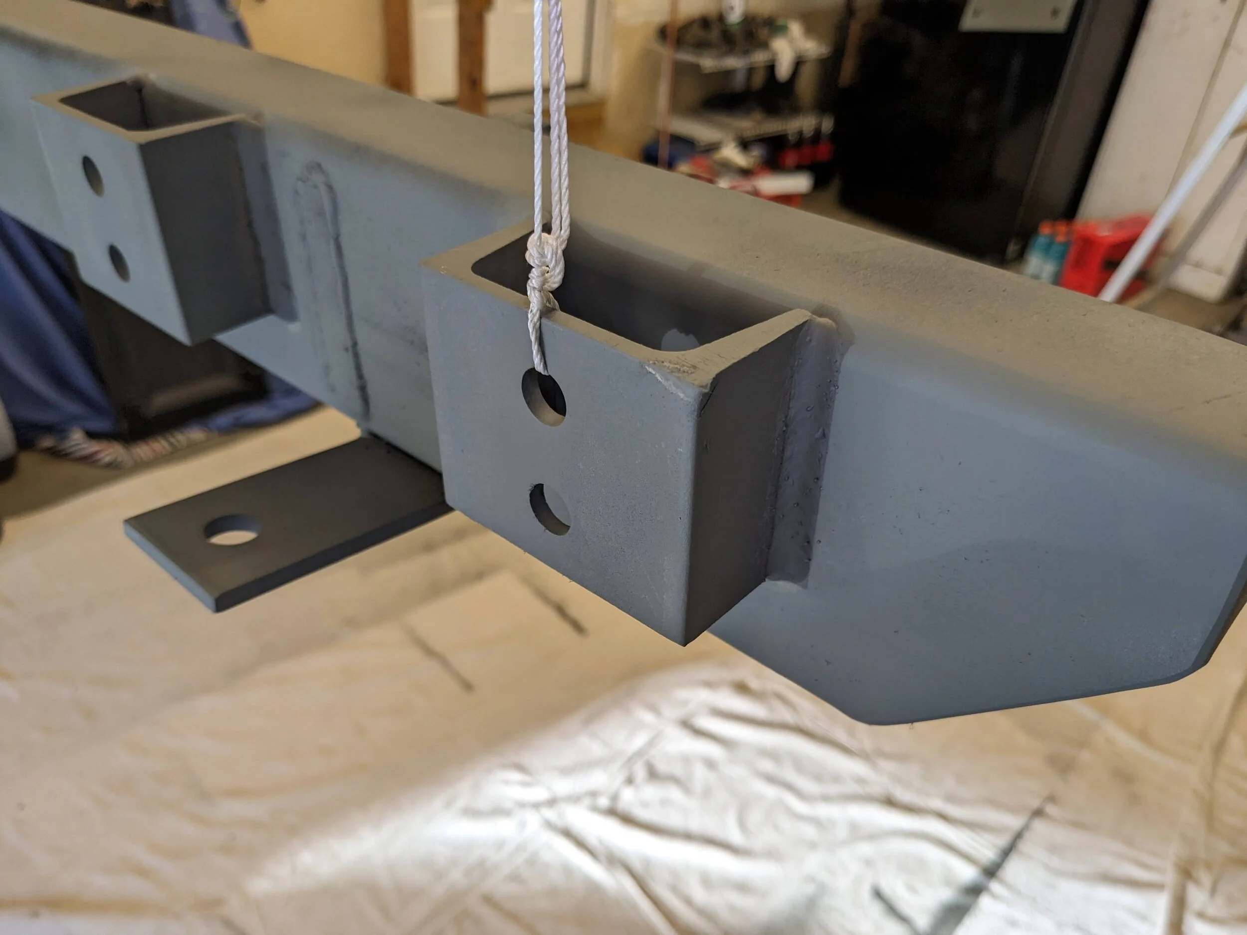

back to painting...I used to use string but have switched to wire coat hangers. They work much better. I cut them up into hooks and hang them. You might need more than one or two for heavy stuff like bumpers, but the wire is rigid enough to hold the part without wrapping around. You still have a contact point, but its generally in a bolt hole and not noticeable. Quick dap of paint on a q-tip takes care of it.
I hope to have the rear design done next week when I’m back for vacation.
I’m incorporating soft shackle mounts, frame reinforcing brackets that tie into the soft shackle mount , 6061 shell with rash guards so the design is a little more complicated.
Nice! That is all I said I need now 🤣. A matching aluminum rear bumper. Also those sweet aluminum soft shackle mounts for the front!
Exactly what I'm thinking. String down and then wire or the string through small diameter coper tubing into a bolt hole for minimal 'non-painted area'.
For a 45lb bumper (per UPS the rear bumper weights in at 45lbs), I suspect I'd need at least 2 pieces through each hole to hold the weight and keep from deforming the wire.
I also had originally used 1 piece of string to hold the bumper. I knew I should have gone with 2 but the string was rated for 160lb.
LIGHTWEIGHT STRENGTH - Nylon fibers are twisted to create a mid-stretch line that can hold loads of up to 160 pounds. Handles high-stress application with no sag or distortion.

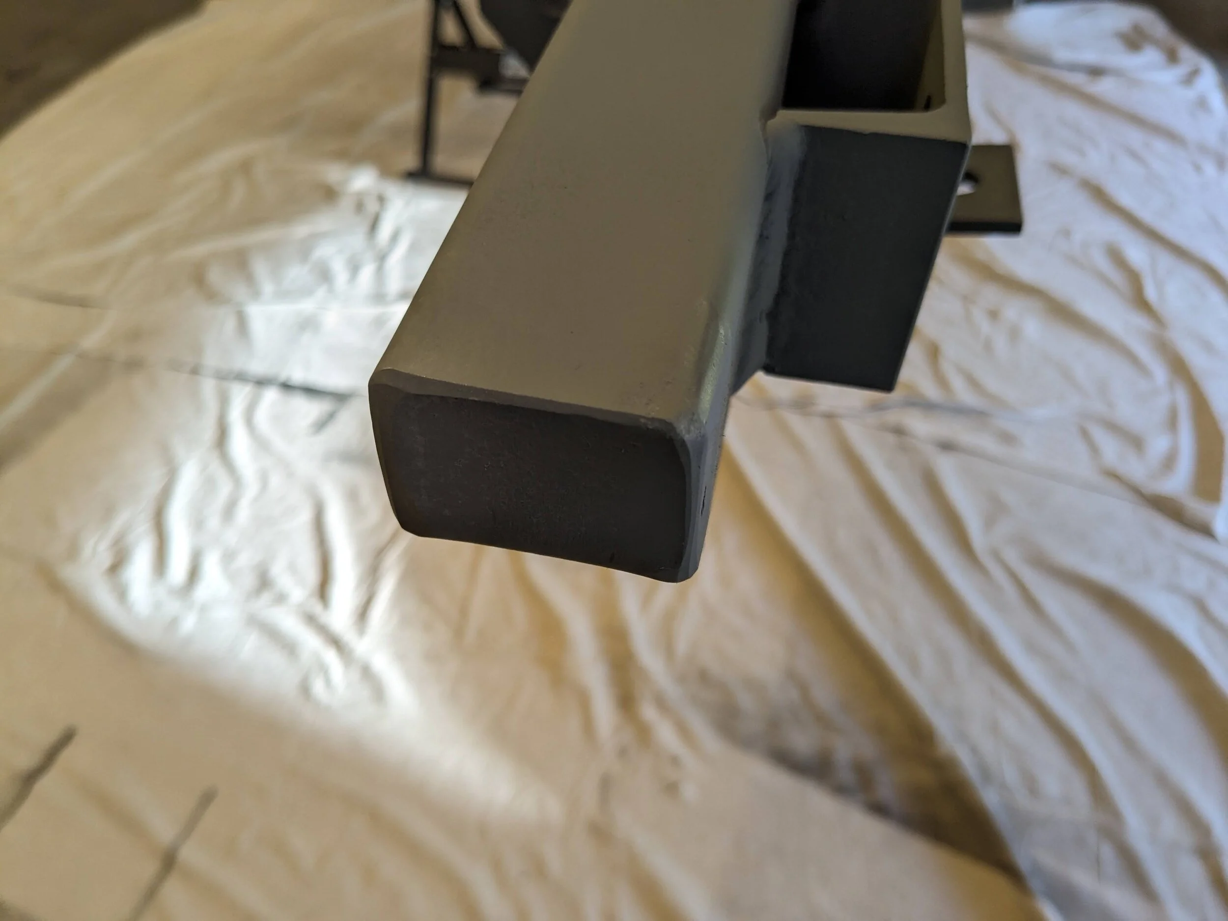

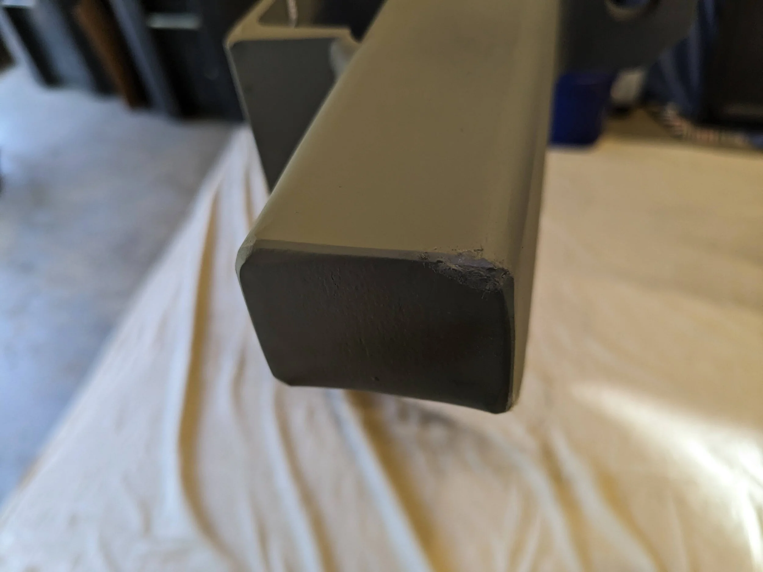

And it did hold the bumper (But I disagree with the 'no sag' as it did sag 3-4" under the weight of the bumper), but when I went to move the string to primer the spot covered by the string, I believe the sharp edge of the holes cut the wire and the bumper went to the ground...
Impact points:
Wire or tubing through wouldn't have been cut... Learning lesson.

When I was doing my painting I got a 60lb test fishing line. Figured it would leave less of a line from painting. Not going to say it worked out GREAT but it worked. I have to say while it was an experience I am NO painter.
I was almost done with my front fenders and knocked them off the saw horses I had them on. Took me 4+ days to get them cleaned up enough to repaint them. It was a complete mess.

Luckily the rash wasn't so bad and 'it's a Jeep bumper' so I don't need 100% perfect. Rash was decently covered in the color phase. I'll likely be the only one to see it.
I keep telling myself - 'You aren't painting panels for your Show 1st Gen Camaro' ... These are Jeep parts so get to good; good is better than trying for great.
