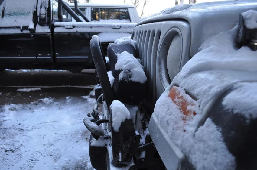

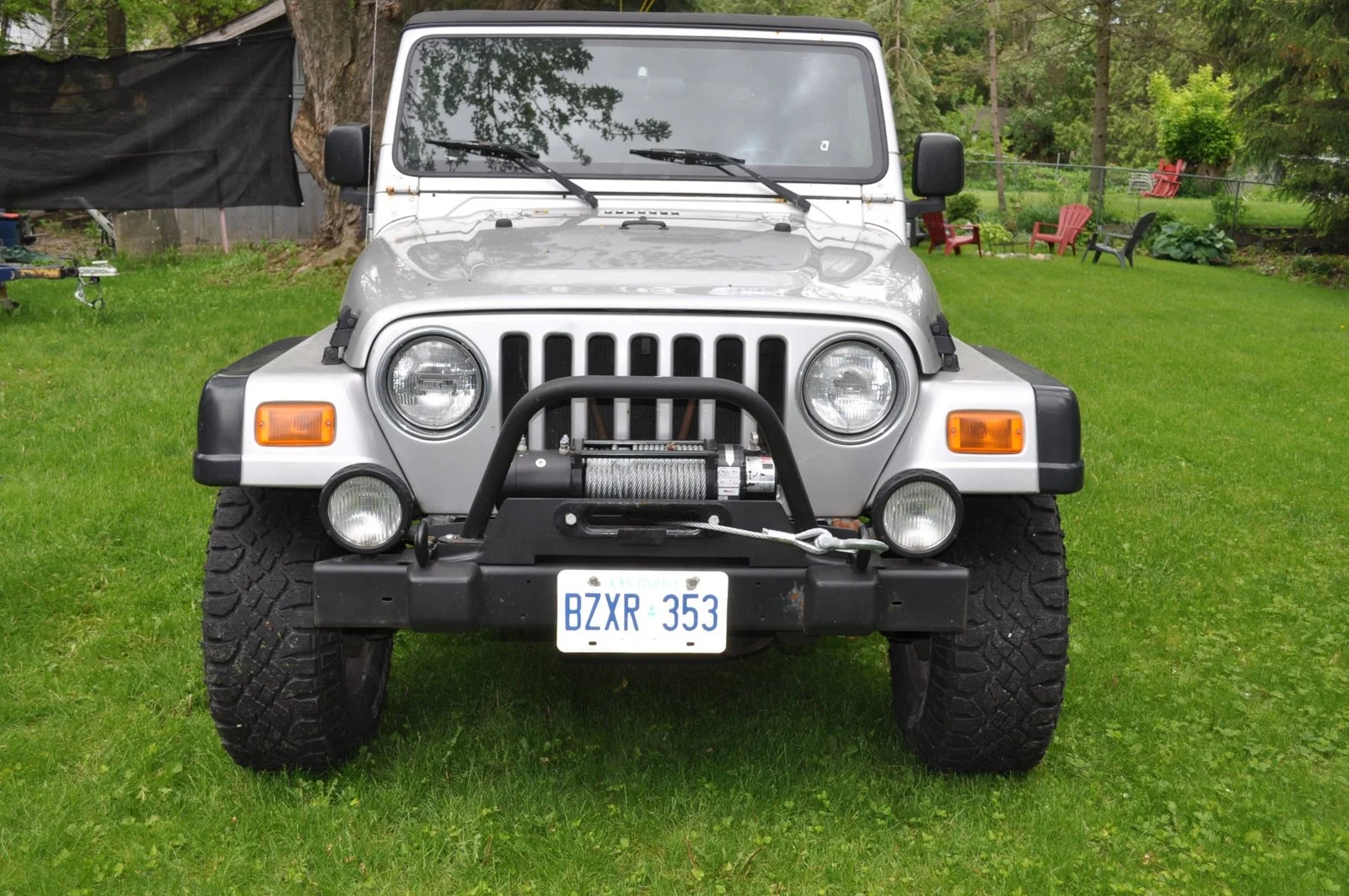

Sorry I don't have any close up shots of it and also that I got it wrong above (it's been a few years since I did it). I welded the brackets I made to the winch plate NOT the hoop. The Warn winch plate is the raised version and the hoop wouldn't fit flat on it. I cut a piece of 2" channel iron to match the length of flat iron bases of the hoop. I cut and ground down the channel iron to fit the contour of the winch plate and then welded them to the plate. I was then able to bolt the plate and hoop together.
This pic shows it a bit better (passenger's side as the other side is obscured by the cable). The "wedge" under where the hoop is bolted down is the piece that I made and welded to the winch plate.
Ok, I see. The 2 inch channel was welded to the angled part of the winch plate to give a flat surface for the mounting point of the hoop.
Does it angle out away from the grille much?

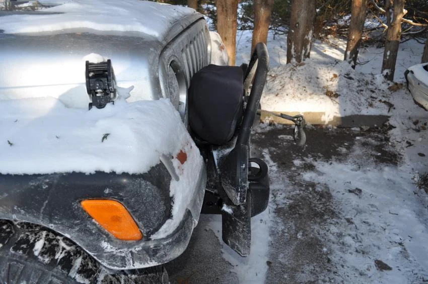

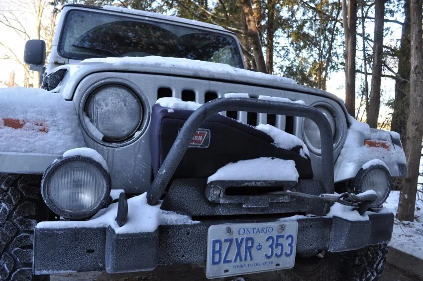

Using the bumper itself for reference, the top of the channel iron is parallel to the top of the bumper and front of it is likewise parallel to the front of the bumper. The "problem" is that the winch plate has angles. I basically squared things up so the hoop would sit properly. I think it's going to warm up to -17*C today so I'll try to get some pics for you. lol
MountaineerTom & KimsJeep - here are some closer pics of my front bumper.
As clear as mud … or snow ...
Showing the distance of everything in relation to the face of the grill. I wanted to take the winch cover off but parts of it were frozen.

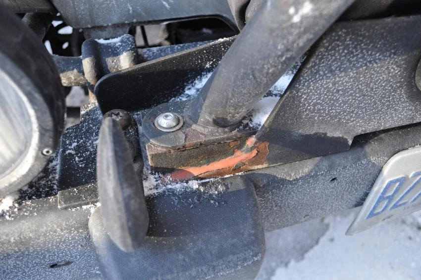

This shows the piece of 2" channel that I fabricated and welded to the winch plate. This LJ has seen a LOT of year round use since I did this, hence the wear. I plan to take this and other things a part this summer for blasting, painting, etc. (plus some mods to my original rear bumper … stay tuned!). The missing paint and rust actually helps to show what I did. The SS button head bolt that is shown was easy to do (bolt into a nut). For the other one that secures the hoop (out of sight in this pic) I had to drill and tap a hole because there was no way to use a nut with the bolt. Things got a bit crowded so I couldn't make the original 3 hole tow hooks work. The 2 hole Reese hooks worked fine with no extra drilling being required.
BTW … The Warn winch plate I used was from a parts car. The previous owner cut off parts of the fairlead plate for some reason. I made additional cuts to make the angles more or less match the hoop (easier to see in the first pic). I just thought I'd point that out for those of you that might have a Warn winch plate and wonder why it looks different.
Hope this helps - Stew
