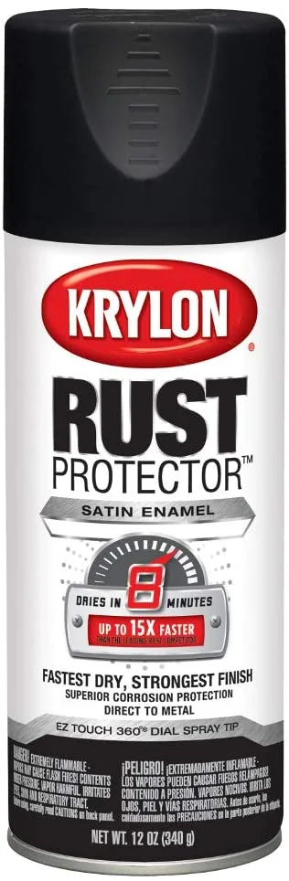

This is what turned me

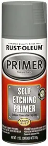

Krylon, with an 8 minute drying time. I've been using this for a while now with very good success. Use a self etching primer, on bare clean metal. This also touches up nicely, with a little sanding.
Why? The guy asked directly if not using primer would be an issue and you just say, "use it." Have you tried and had bad luck or is this just, "I was taught to do it that way." Just saying use it isn't really providing any information to me and I can't imagine it's much help to him either. Not hounding you but why just regurgitate this stuff, why do you use it?
There ya go!it doesn’t say vari-prime on my tshirt because they didn’t pay to put it there but vari-prime is th shiznit,plus it comes with the fan-mode on th spray-nahshizzle
Self-etching primers have zinc chromate (an acid)in their chemistry and it eats into th metal surface creating a porosity that is more aggressive than just sanded scratches.subsequent layers of paint tunnel into this micro porosity and adhere better
Honestly, I don't use it. I simply want to hear why people use it. I know when you just spew out what you've been told sometimes you got nothing to say. Fine. This is the perfect place to say, it helps with adhesion, it helps with corrosion in my experience. I don't want to really hear about the label or what you read, what is your experience? But I almost never hear that. it's just "use it." It's not helping anybody. I've used modern paints on steel and they don't have adhesion problems. So what's the deal, why is this so difficult for people?
