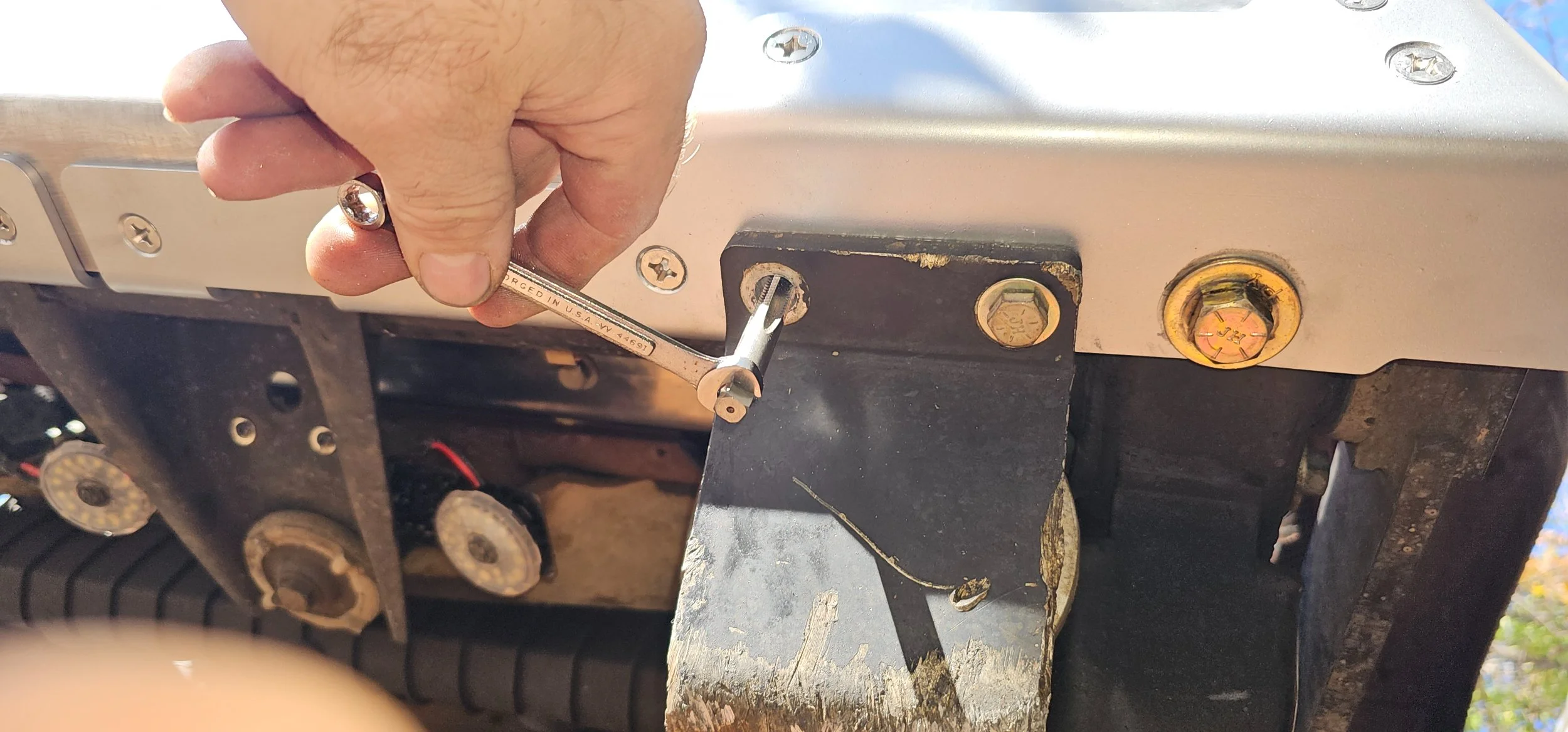

Isn't the bottom bolt here:
Reactions: Alphonse53

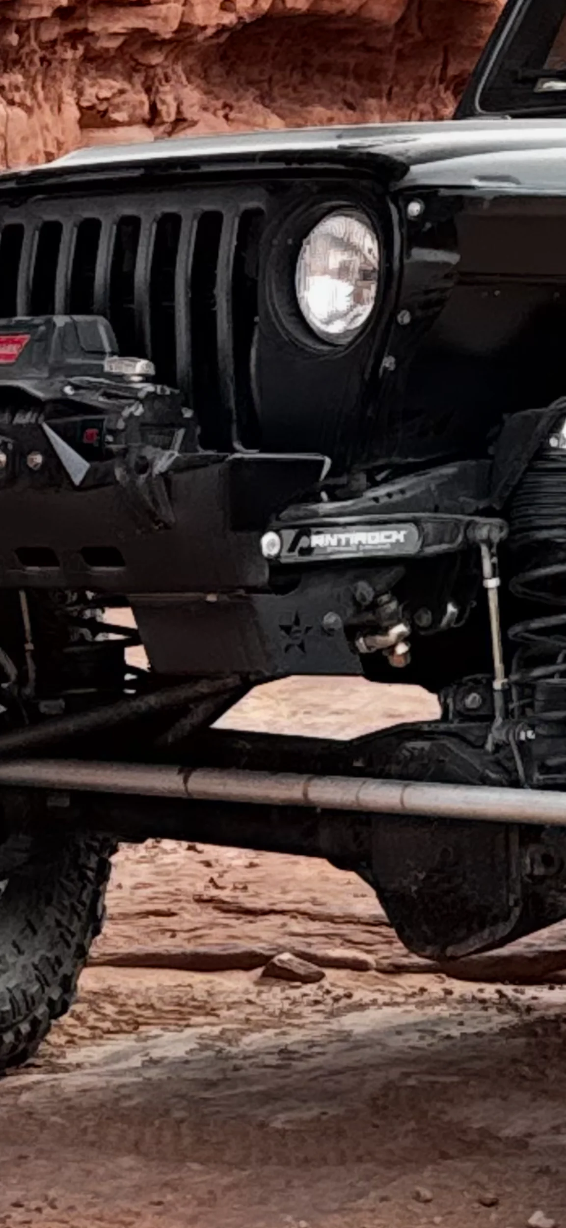

This is a Savvy steering gear skid on a Flux Off Road bumper.
Oh yea! And that location is flat, but most of the plates bolt to underside of the bumper as well. I was hoping to find a plate that would do that. You have the same bumper setup as I do. How many bolts are holding it? I'll post a picture.
