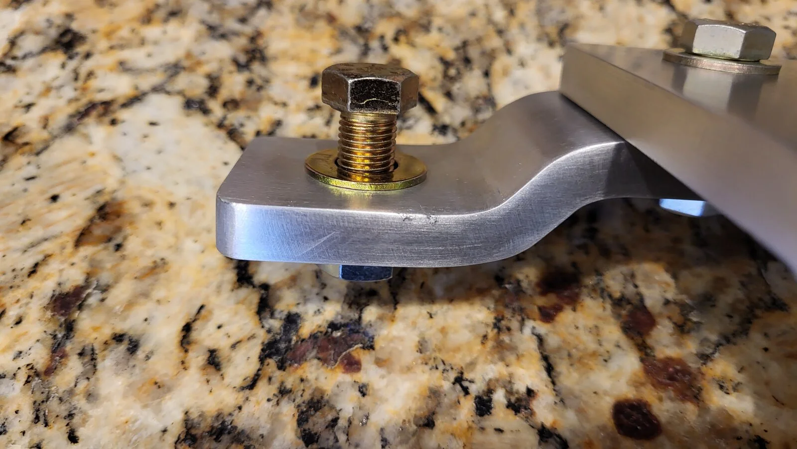

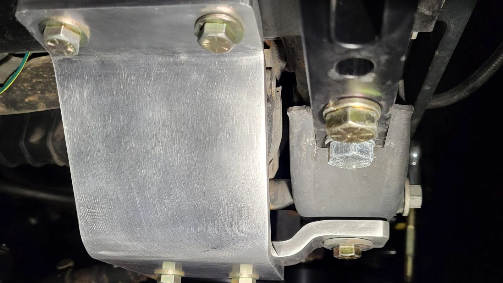

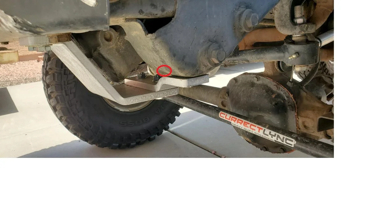

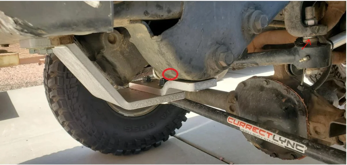

I don't recall if you fixed this but that washer does not go there. It goes under the nut if it is the one that came with the trackbar or it does not belong there if you added one of your own. Top of the JJ barrel goes against the bottom of the mount.
I recieved my skid recently and am glad I found this thread. Savvy is back to including the wrong washer with the steering box support bolt. I dug around in my hardware bin and found a much thicker washer so I won't muck up the threads. The machining was left pretty rough. I had to clean it up a bit so I will be able to get a good paint job on it.
They are not machined. They are laser cut.
Great to know about the washer. I'll give it a look before I do the install.
