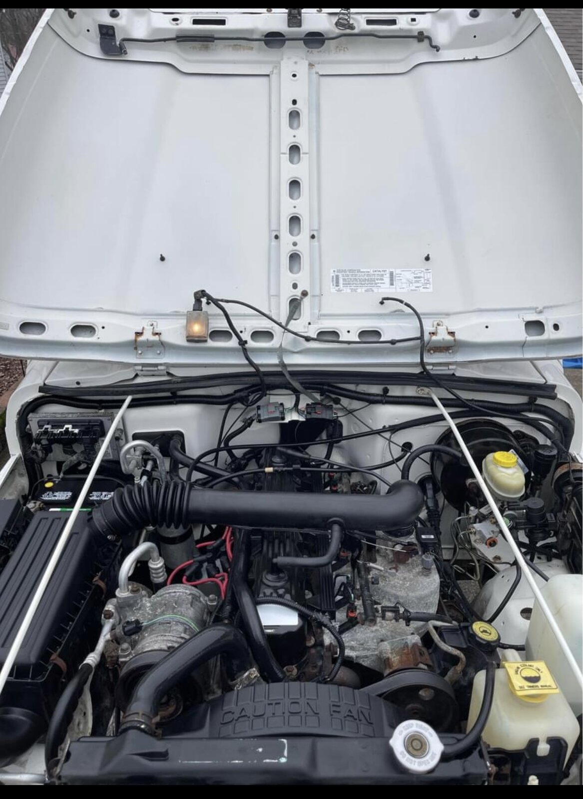

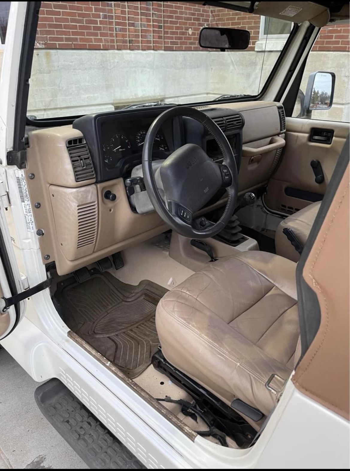

I found this one. Guy says it is rust free. I haven’t seen in person though. Also said CEL light was on for rear O2 sensor. It looks clean by pics, but thought I’d let you guys check it out. Asking around $11k. Also, is the Sahara edition desirable? This color combo? Thanks.
11k is fine as long as its truly rust free. Make love to the frame of that thing and make darn sure. The sahara package might be desirable to some but IMHO it doesn't add a ton of value.

Thanks. I think I’ll pass anyway. Doesn’t have a back seat. Floor had rhino cover. Not sure if that was done to cover something.

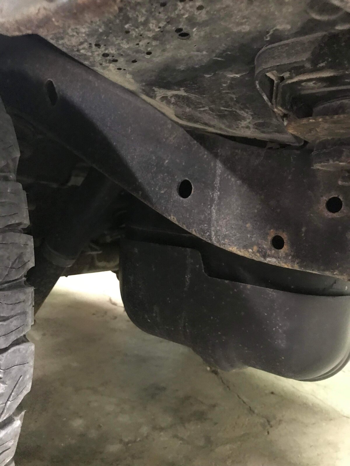

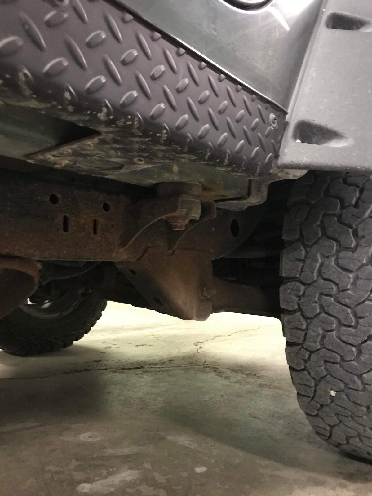

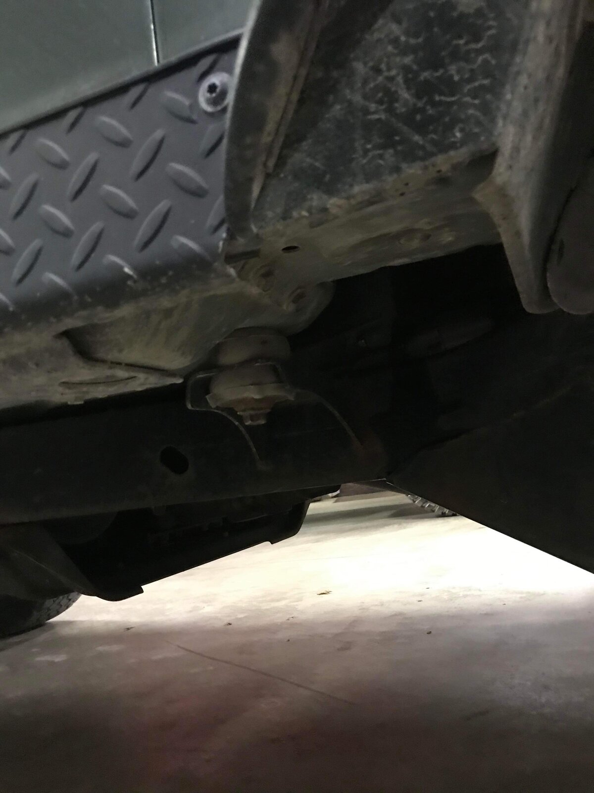

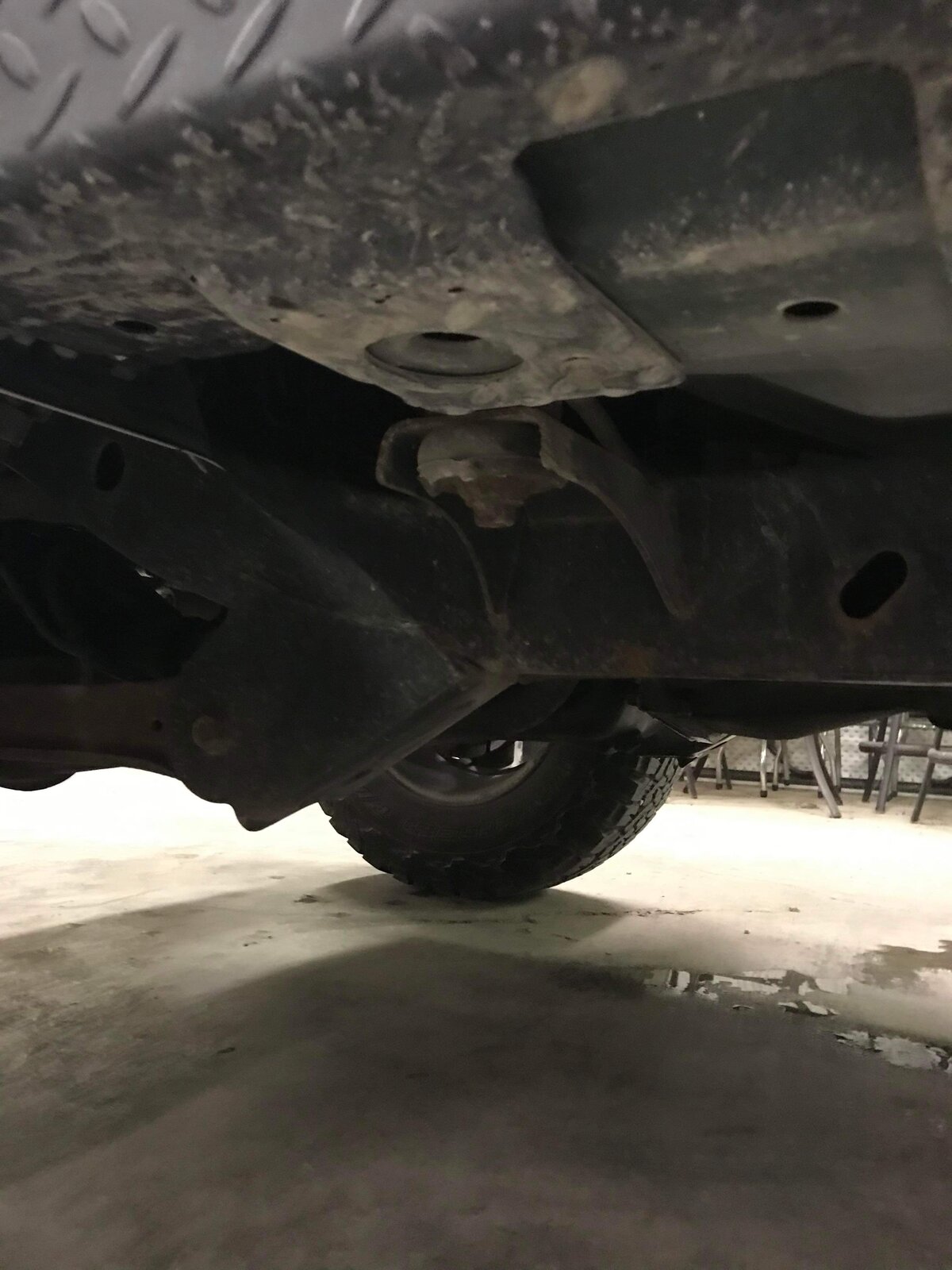

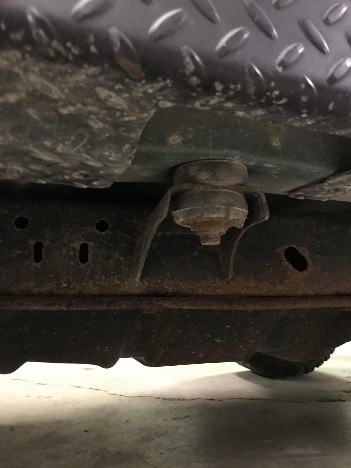

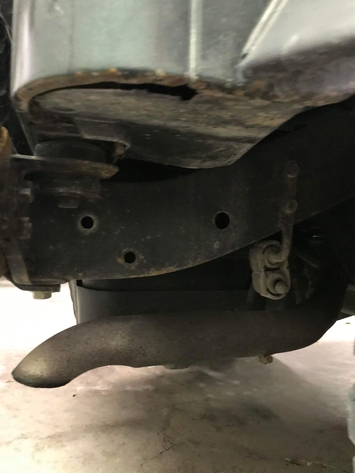

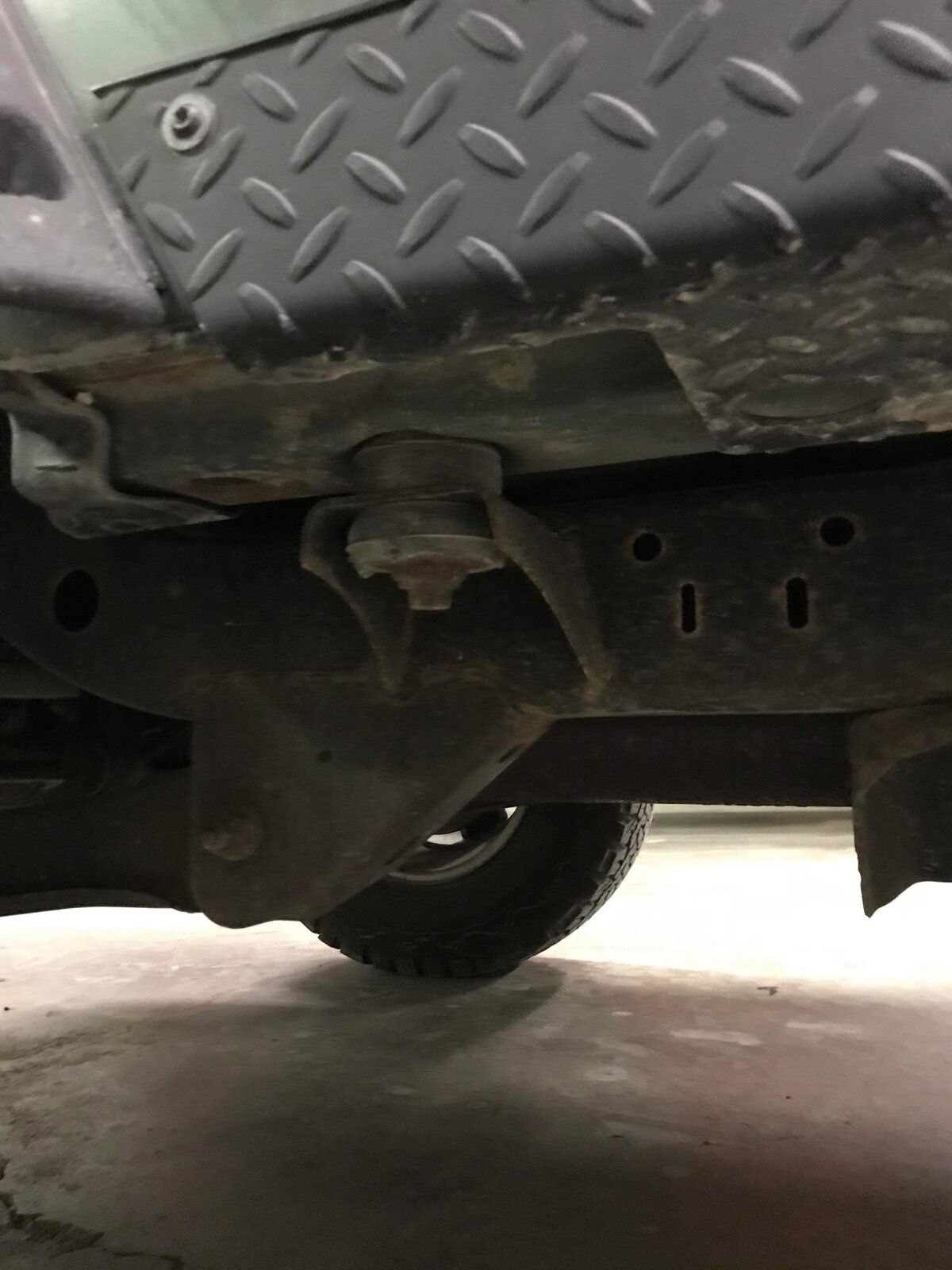

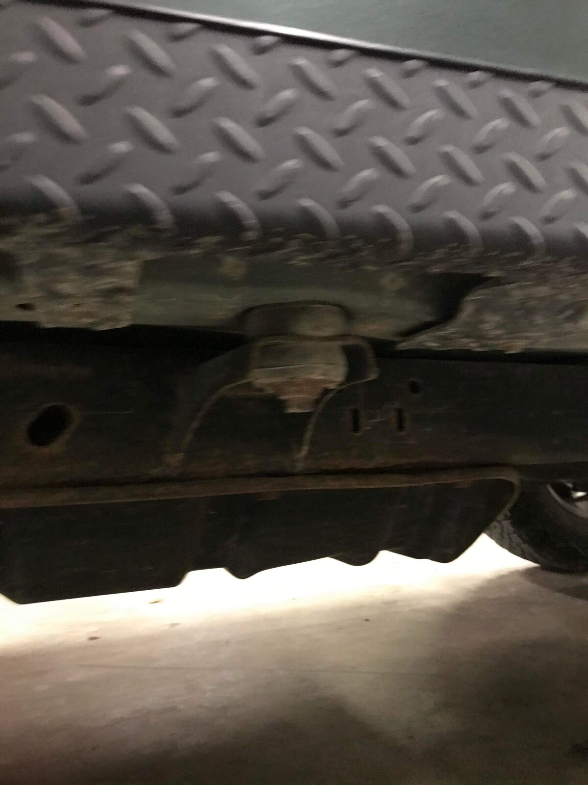

I’m sorry to keep hassling you guys, but I’m trying to make a good purchase. Here is a 2004 Rubicon. I had them send pics of the frame. How does it look? Thanks again.
All the non-rusty state members will say that's way too rusty. I'd be skeptical of it. I wouldn't be surprised to drop the skid plate and have holes. I'd probably keep looking. It may take quite a bit of time.
Reactions: bbaldwin237
Here in the PNW I probably would have avoided that much rust, especially sandwiched between the frame and skid. Now if they let you drop the skid and inspect and you can absolutely confirm it's all just surface rust, it might be worth a discounted price and then immediately get to cleaning and treating everything. But my guess is that inside the rails isn't any better.

Thanks. I found another as well that has been Undercoated. I guess that makes it difficult to know what’s underneath. Is that something to be suspicious of?
If I liked everything else about the Jeep and there were no better prospects available, then so far I don't think that level of rust would put me off. Next step would be to buy an endoscope from Amazon ($60) go see it and take a look inside the frame to confirm what we are seeing is just surface rust.
