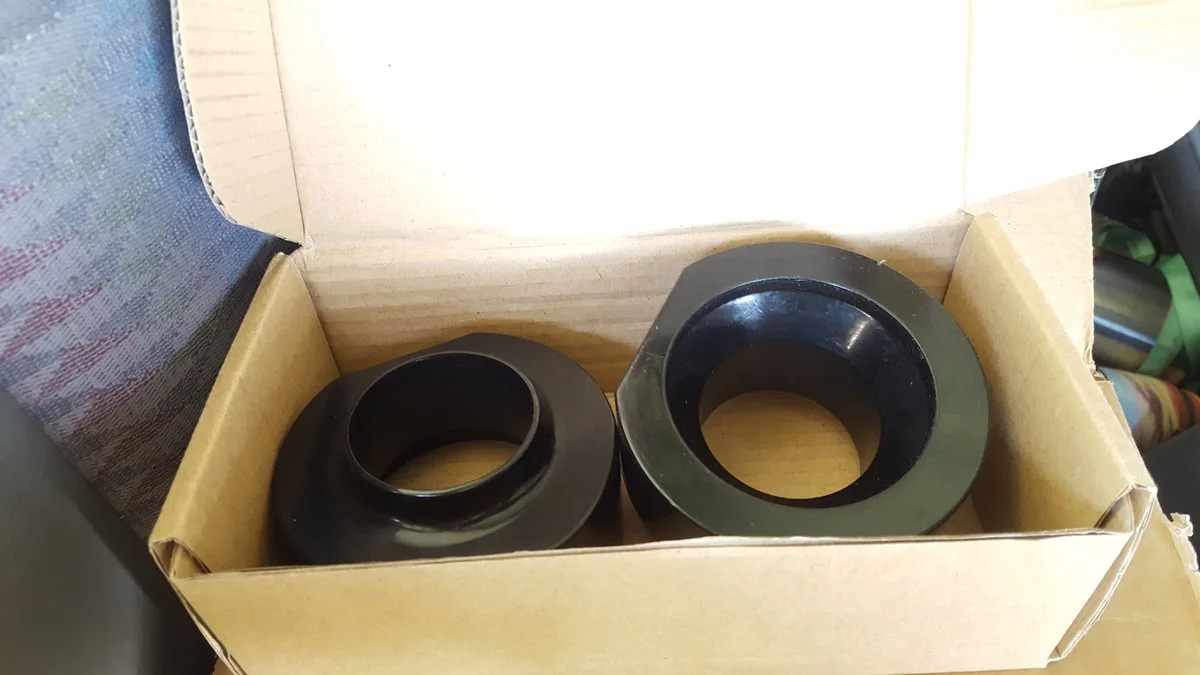

Just a follow up on this for anyone in the future, the best way to trim these would probably be with a lathe. This wouldn't be a problem for me since I have a friend with one but they are contoured on both sides. I won't be needing them now with the lift on its way. Pic of top and bottom below.
You could probably hold them in a small enough 3-jaw chuck(definitely a 4-jaw) and face the extra material off the backside. That big chamfer on the backside is just clearance for the top of the bump-stop tube.
If someone is in a position to turn down a set spacers, then just make a set from aluminum. I've used both materials on mine. The current set of aluminum spacers I have on the rear are the best set I've used.
