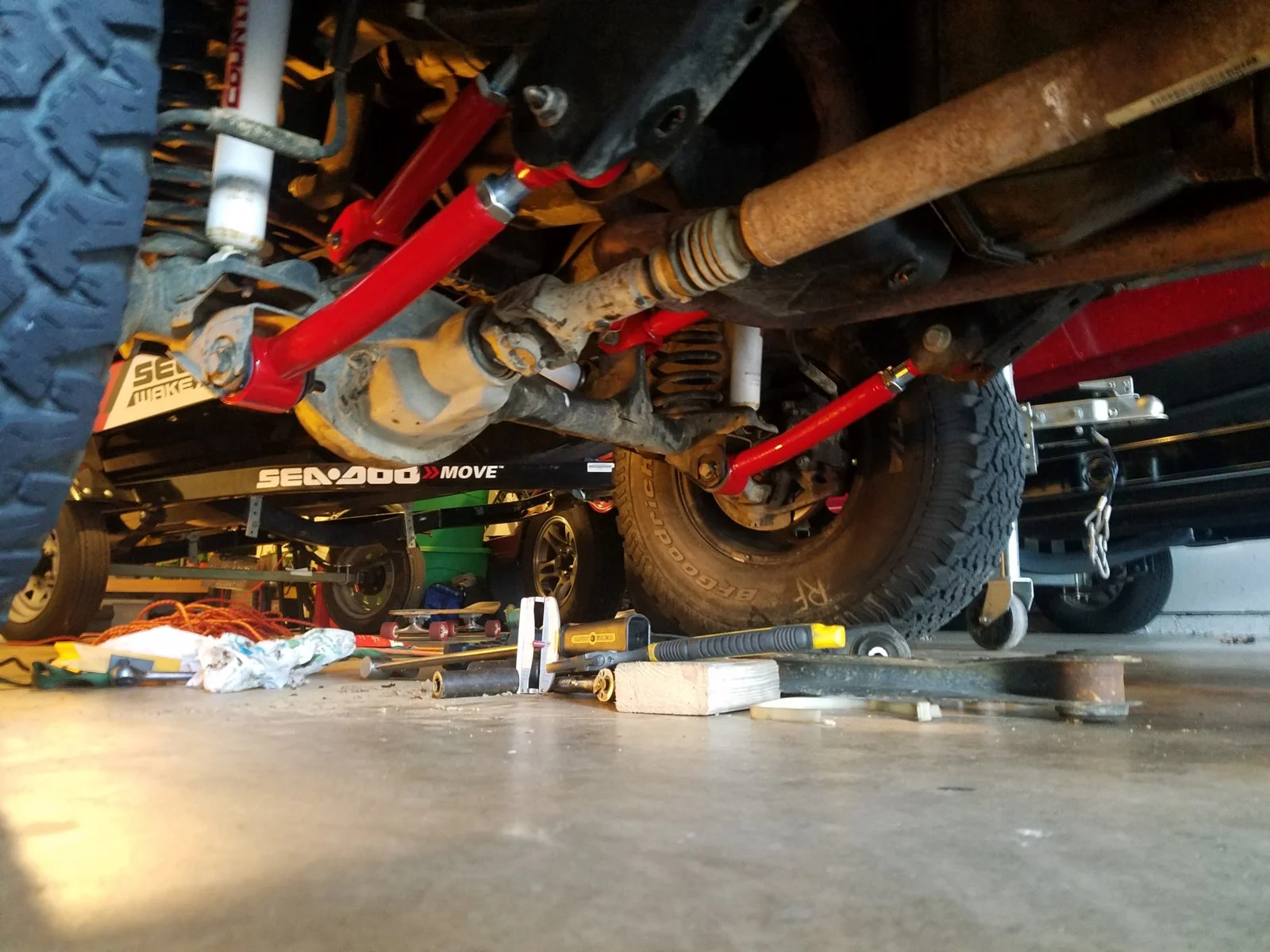

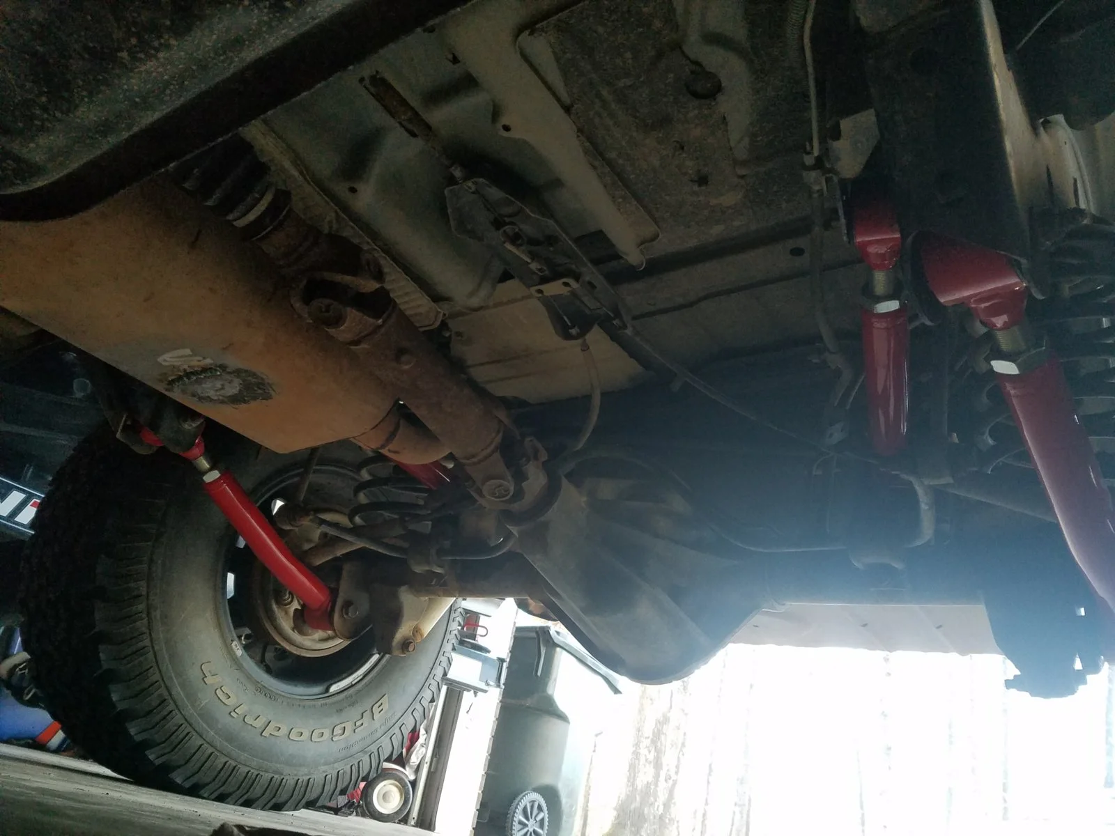

Went with the Core teir one adjustable upper and lower control arms. Now to pray I can get these in and adjusted right. You tubing it up..

Got all eight adjustable control arms in, torqed to spec and adjusted. It fixed every single issue with the suspension. No more flighty feeling in the front, no more drifting/fishtailing feeling in the rear, no more clonking on sharp turns or hard acceleration. It fixed everything. Got 5.5 degrees caster. Big thank you to Jerry and Chris!! Eric.
