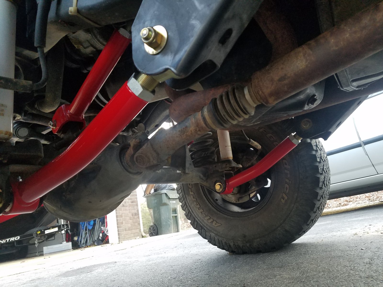

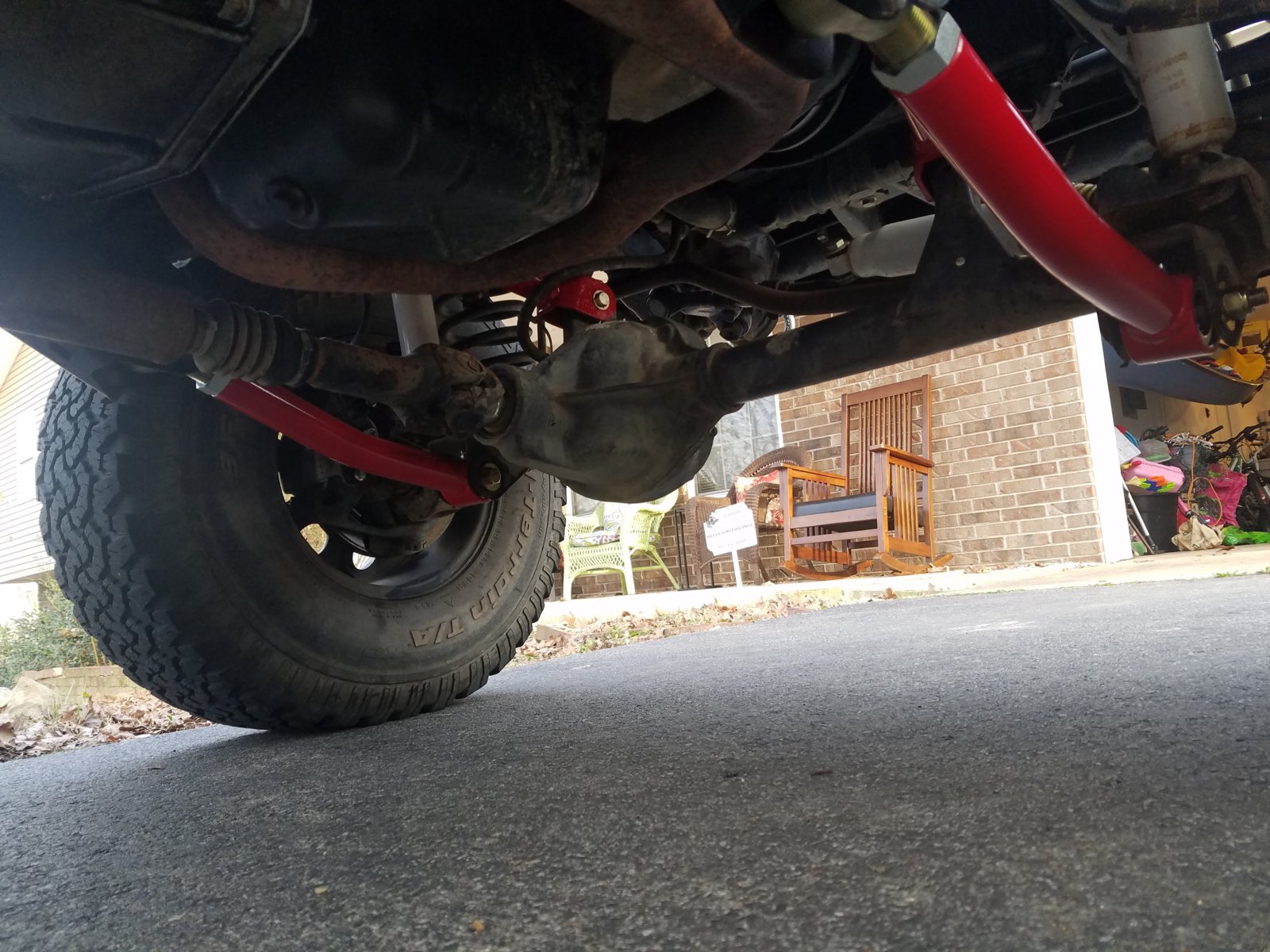

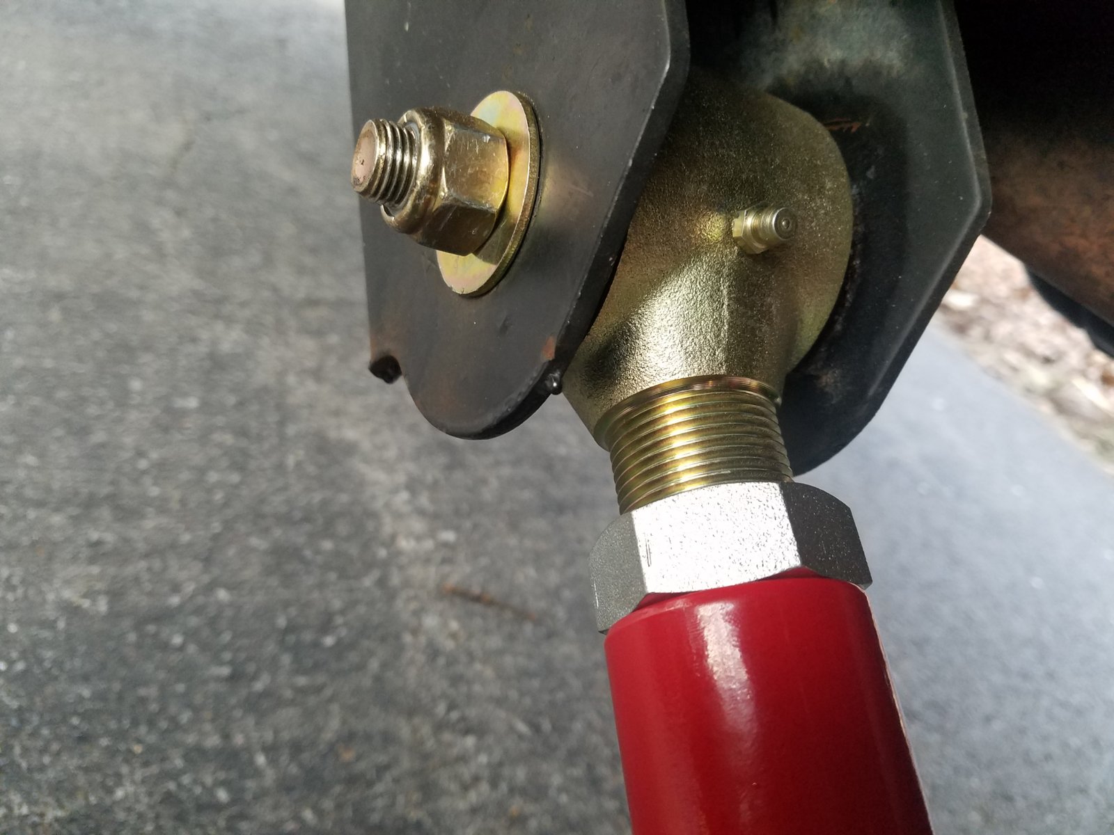

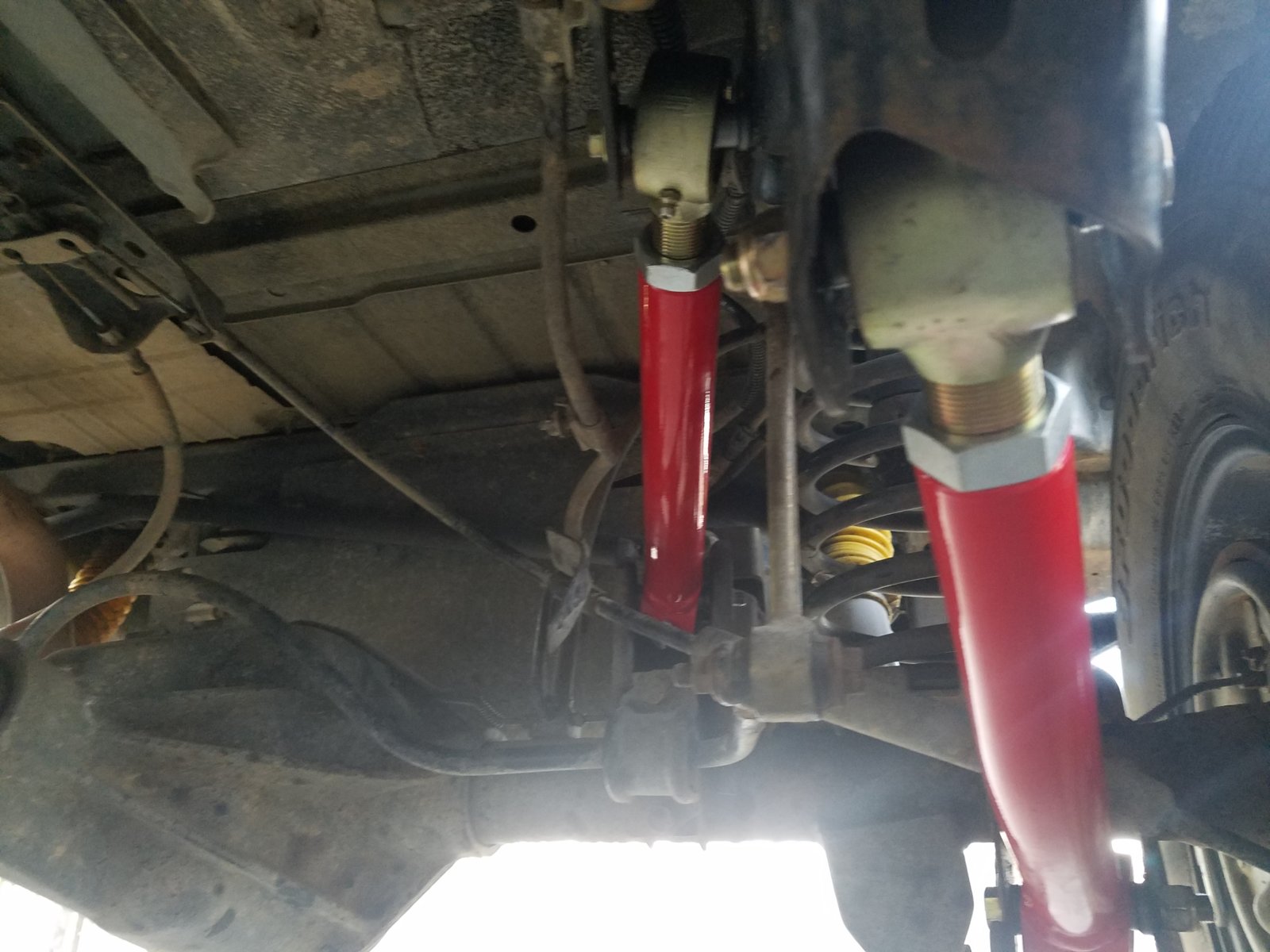

Ok I just ordered the "Tier 4" Core 4x4 Adjustable set all around. That has JJs on both ends. Looks like I'll be doing the entire job over.. Some lessons are learned the hard way. Ill update after the install.
Reactions: Mike_H
Welp the Tier Ones are off and the Tier 4s with JJs on both ends are on. I thought the JJs would be rougher riding. I've read that on here.
I've driven 35 miles on them so far and they feel the same as the rubber bushings. The jeep feels much tighter with the JJs and has great ride. Overall this 3 mth job of figuring out and fixing why it was riding/steering so bad and fishtailing all over the road has been solved. It was 100% the stock control arms. Thank you everyone!
Reactions: Mike_H and derekmac
