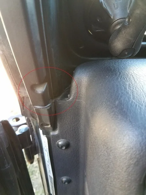

I am having this issue BIG TIME, spent a day working on the tail gate seals, that seemed to help but today when I open her up I noticed a puddle on the passengers side, that looks like it might be coming in from above the door?
