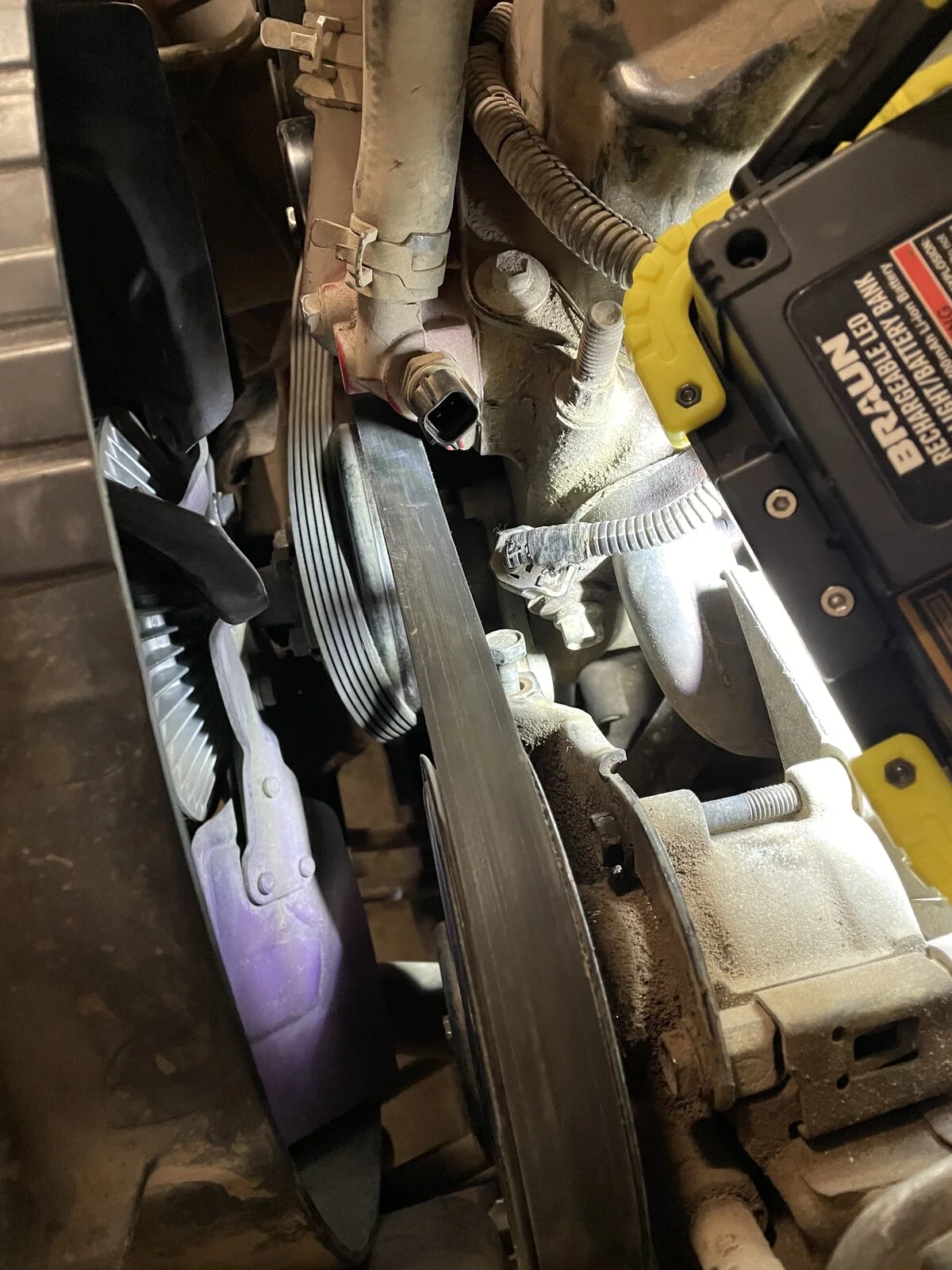

There’s the bolt “under” the temp sender that is loose. Then the bolt in the center of the tensioner pulley (pictured, below the power steering pulley) is loose as well. It pivots freely.
Are you saying the power steering pulley itself needs to be loosened?
Nope just the center bolt that holds the little pulley. Did you loosen the bolt bolt that moves the little/tensioner pulley. It's just above the tensioner pulley on top of the bracket just below the power steering pump.
That bolt is how you tension the belt. Turn it one way it loosens the belt and turn it the other way tightens it.

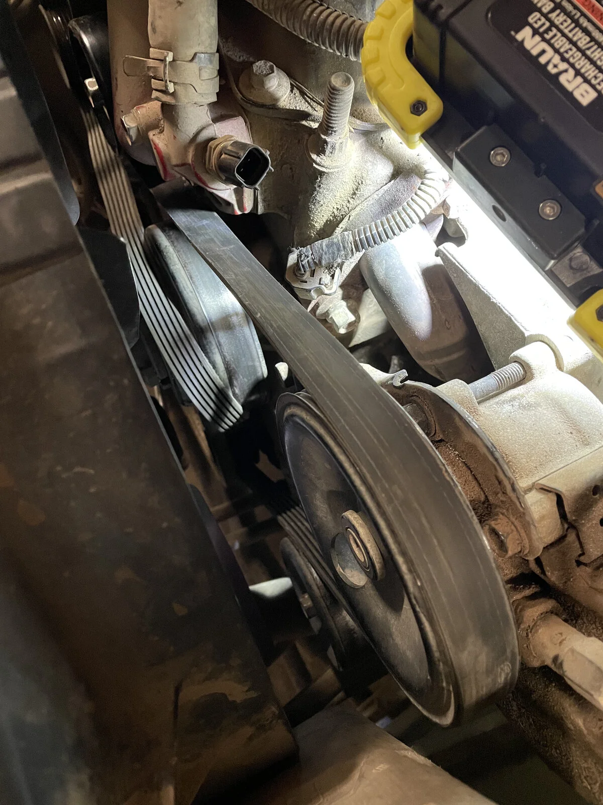

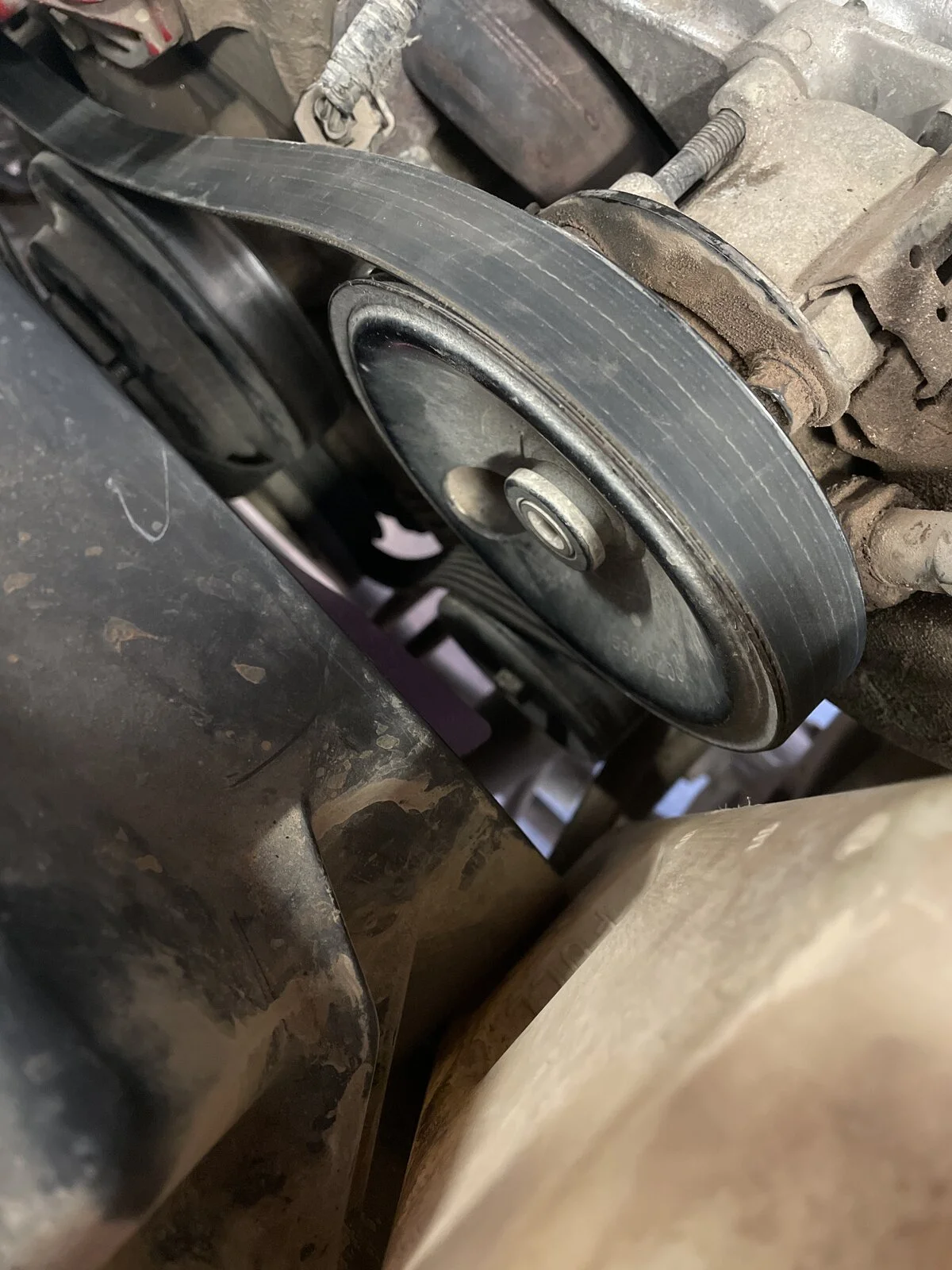

Ok yes, I’ve done all those things. I have the idler pulley below the lower steering pump loose. I can make the thing travel along that slot. And I have the LONG bolt loosened as well. If I loosen it any more it’s going to unthread.
I have no earthly idea how I got this belt on before because it ain’t going on now. If I didn’t know any better I’d say it somehow shrank. Shrunk? Shrinkd’d?
That’s as close as I can humanly get it. I won’t need the damn tensioner if I ever get it on there. Maybe that’s why the idler bearing blew up.

Anyway, after another 90 minutes of cursing at it, I finally got it on. I ended up slipping it over the idler pulley last, although I tried that early on. I also tried a slightly longer belt off a 99 Cherokee I happened to have, but it was too long and wouldn't tension. I will add that even with the "right" belt, the tensioner pulley isn't "tensioned in" as far as I remember.
But it's on, not squealing, alternator charging, etc. I don't feel like the tensioner pulley was the limiting factor in getting this on, which is surprising, but whatevs.
