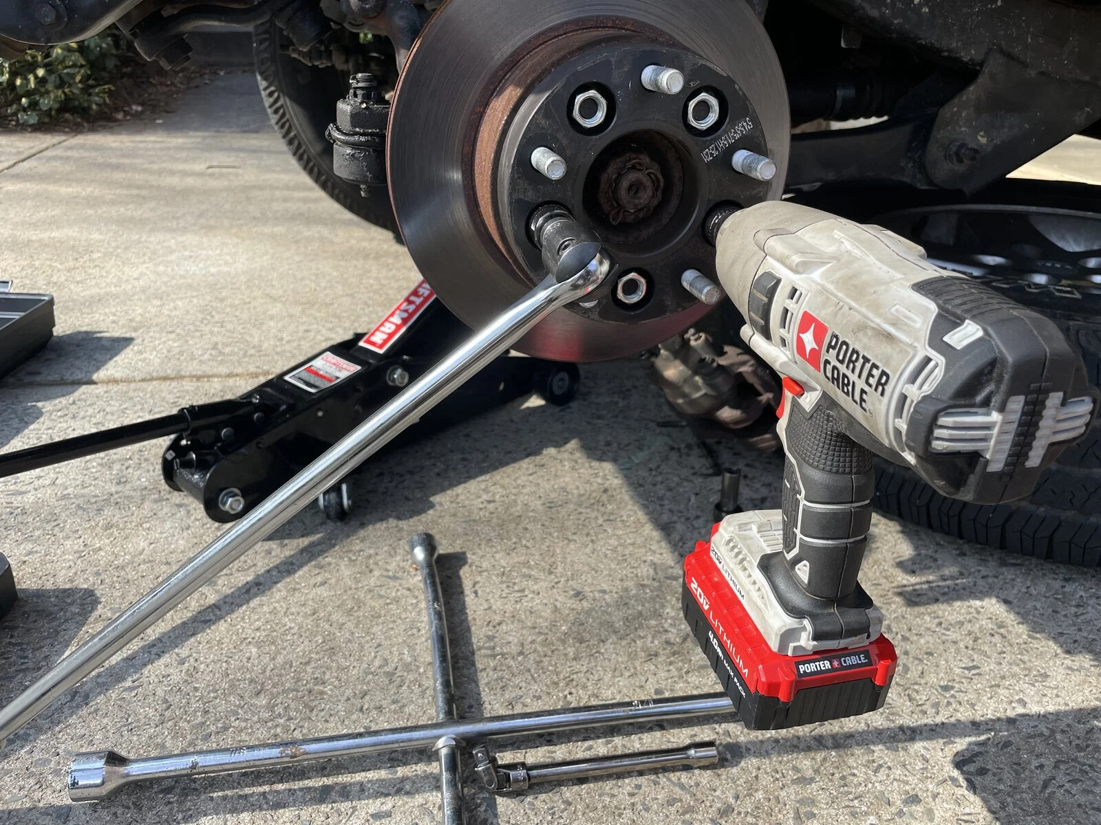

Looking at the research, as long as certain criteria are met a spacer is as safe as no spacer. Things like spacer quality, aircraft grade Al, hub centric, proper torque.
My son and I talked this over this morning and he reminded me that as we were putting the nuts on the stock studs we had to be careful to keep everything centered, or else you’d get to one where the nut was not centered on the stud. These were Titan spacers. It may not be true for all. I can see where human error could creep in there.
