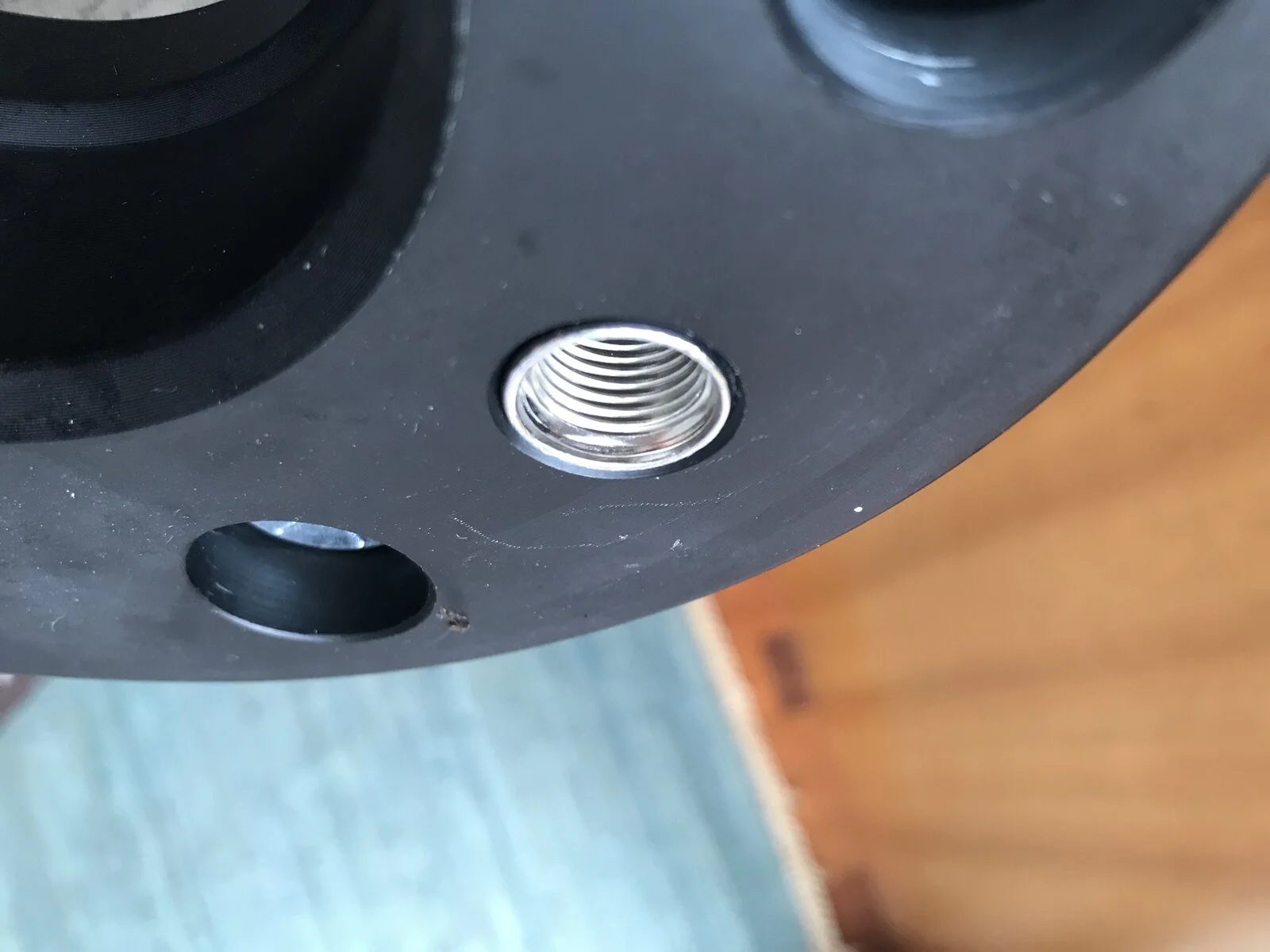

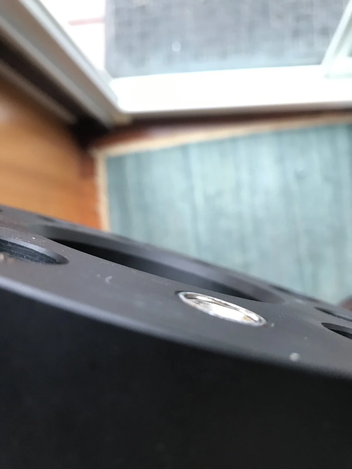

Alright guys, so I finally got around to putting the spacers on. Front went on no problem. Rears have the shorter lug bolts so I ordered the extended thread lugs that @Jerry Bransford suggested. The shank of the lug nuts extend through the spacer on the hub side a fraction of a millimeter. It's barely noticeable by eyeing it or running your finger over it, but am I right in assuming that this is a safety issue? I my mind when I torque this adapter onto the hub it wont be making flush contact with the hub.

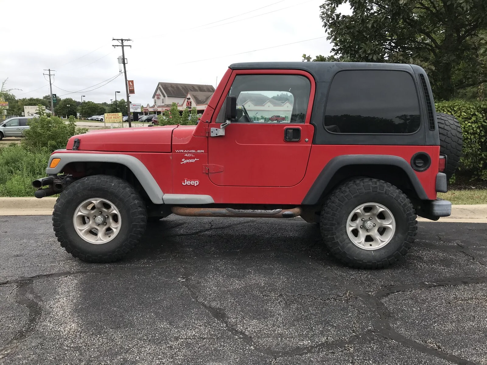

Just wanted to close the loop here to show you guys the finished product.
Old (very old) wheels on the left; New (used) Moab wheels on the right.
Thanks everyone on this thread for your help.✌️
