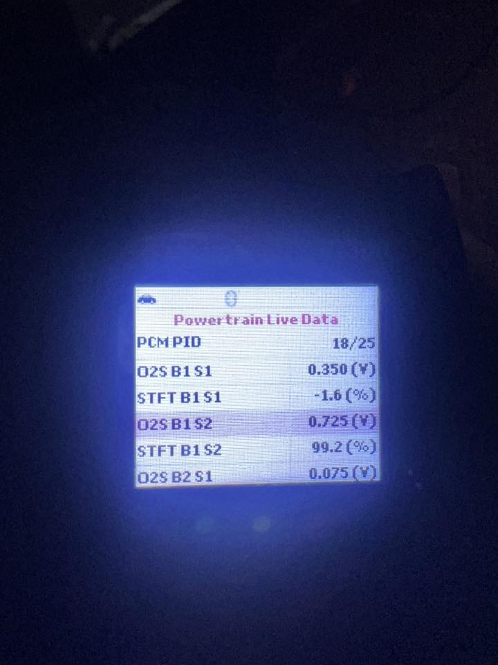

These are the readings I'm getting from my o2 sensors, O₂ sensors oscillate rapidly, so I don't think it's an O2 sensors issue.
