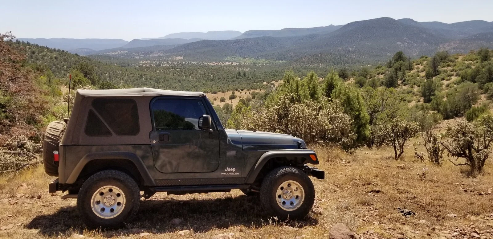

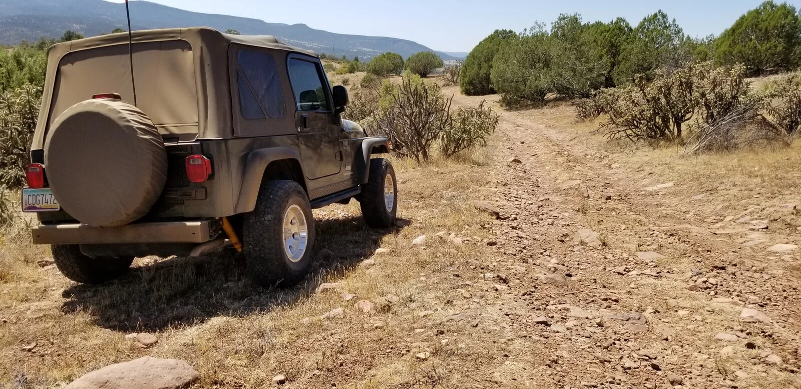

I had mine mounted to the spare mount. I did this so it would be out of the way, not getting caught up in trees or bushes and not have to drill into the body. This also allowed the wiring to neatly tuck in with and follow the existing 3rd brake light wiring.
Not the best pics but I can get close ups of the mount and wiring and post later if you'd like.
That is exactly how I installed my antenna. I removed the 3rd brake light wiring from the hole and installed a PL259. The antenna is protected and no drilling holes in the body.

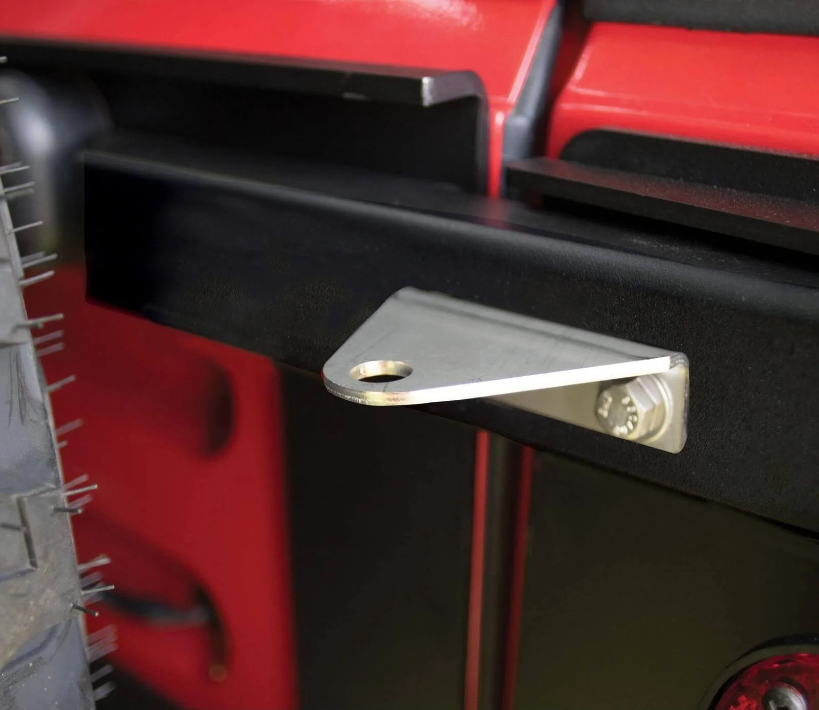

I found MORryde makes a CB mount that attaches to the hinges. I'm going to use that with the MORryde hinges, should work out nicely.
This one? At these links? $24.99?
https://www.morryde.com/products/cb-antenna-mount-kit-2/
https://gr8tops.com/shop/jeepmodels/wrangler-lj-2/tj-lj-hd-tailgate-hinge-cb-mount
(Don't you love it when someone starts a thread asking for product recommendation, finds a solution that hasn't been discussed in the thread, but doesn't post photos, links, prices or any details. ;))
