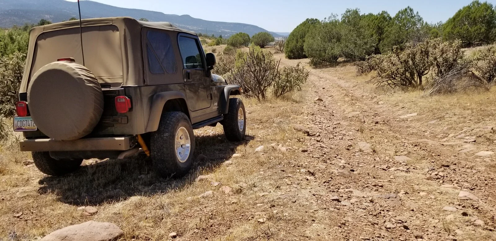

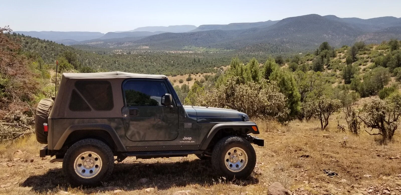

I had mine mounted to the spare mount. I did this so it would be out of the way, not getting caught up in trees or bushes and not have to drill into the body. This also allowed the wiring to neatly tuck in with and follow the existing 3rd brake light wiring.
Not the best pics but I can get close ups of the mount and wiring and post later if you'd like.

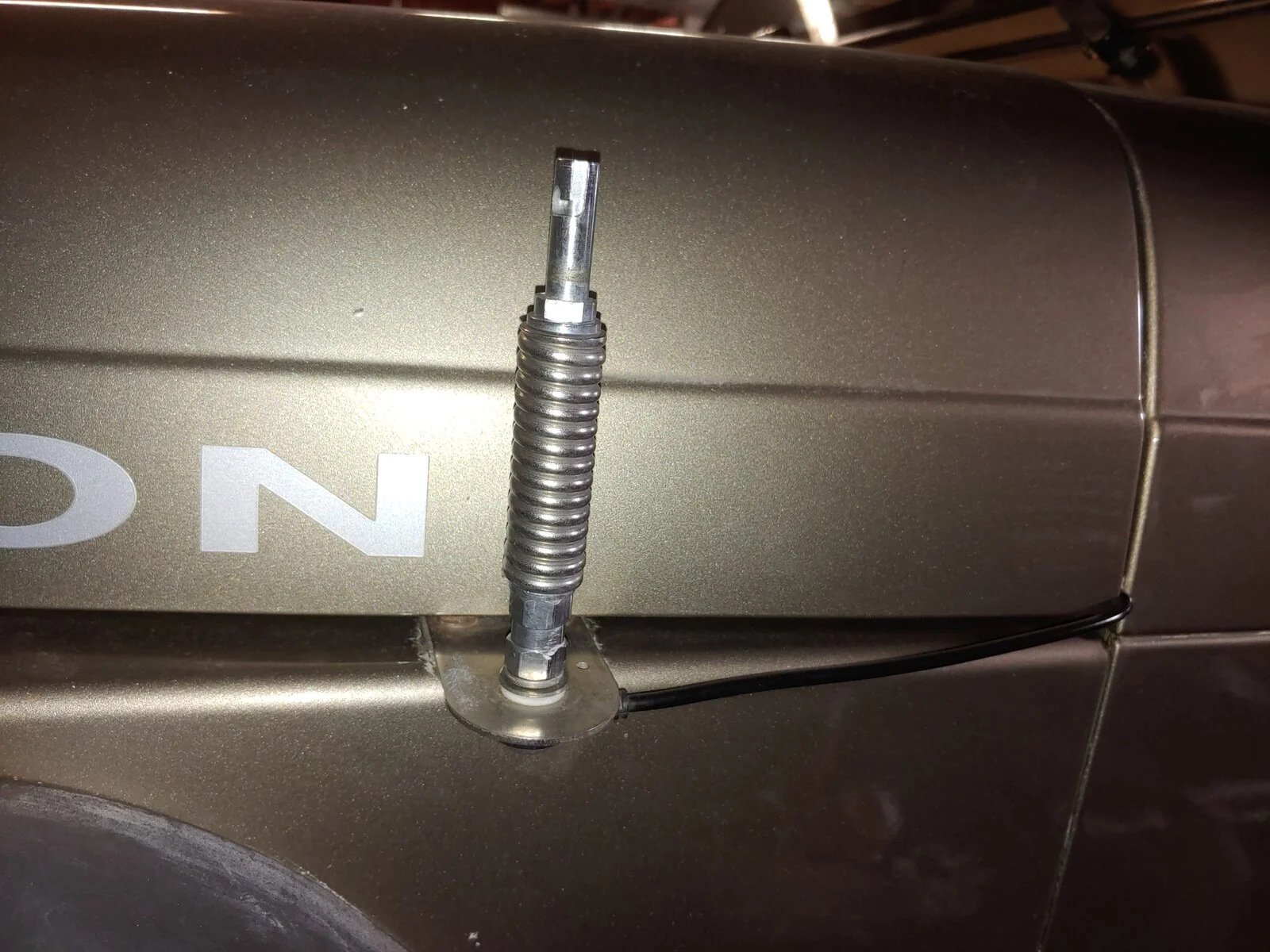

My first antenna mount was simply two holes drilled through the tub for bolts and one larger one for the cable. Obviously this is a pretty bad idea through thin sheet metal and it quickly messed up my tub (don't judge me, I didn't install it...). But, if you have Savvy corner armor, I'd imagine that type of mount wouldn't cause an issue since you have extra support.
I have two bolts filling the bolt holes and plastic plug in hole for cable now. I really like where my antenna is now on my OR Fab carrier. I also changed out to a shorter antenna and I don't think it is taller than my roof.
You can see the mount in this photo. And you can also see why it isn't a good idea at all. But with corner armor and a shorter antenna, I'd imagine it would be fine.
