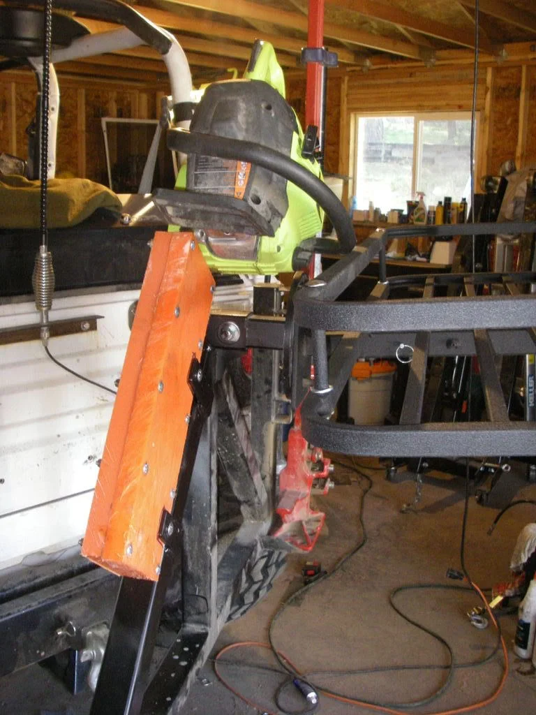

I've got LED tails and will mount my antenna on my tire carrier. @Mr. Bills suggested that I run a grounding line from the antenna to the body to help with a possible weak ground connection from the tire carrier to the body.
1/2" Tinned Copper Metal Braided Sleeving (0.32" Diameter) - 10FT https://www.amazon.com/dp/B01BIBQ940/?tag=wranglerorg-20
Got it. I just used a piece of angle iron and bolted it to the holes on the tailgate where the rubber bumpers use to be.
