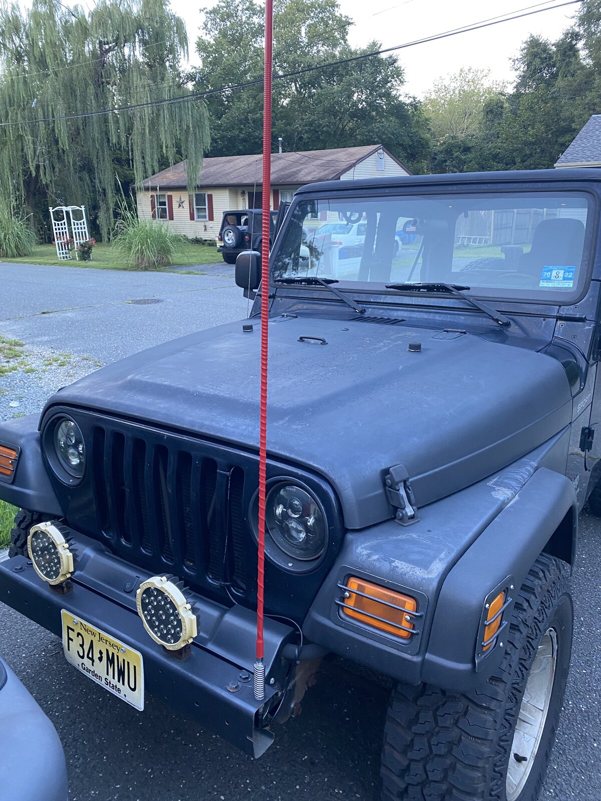

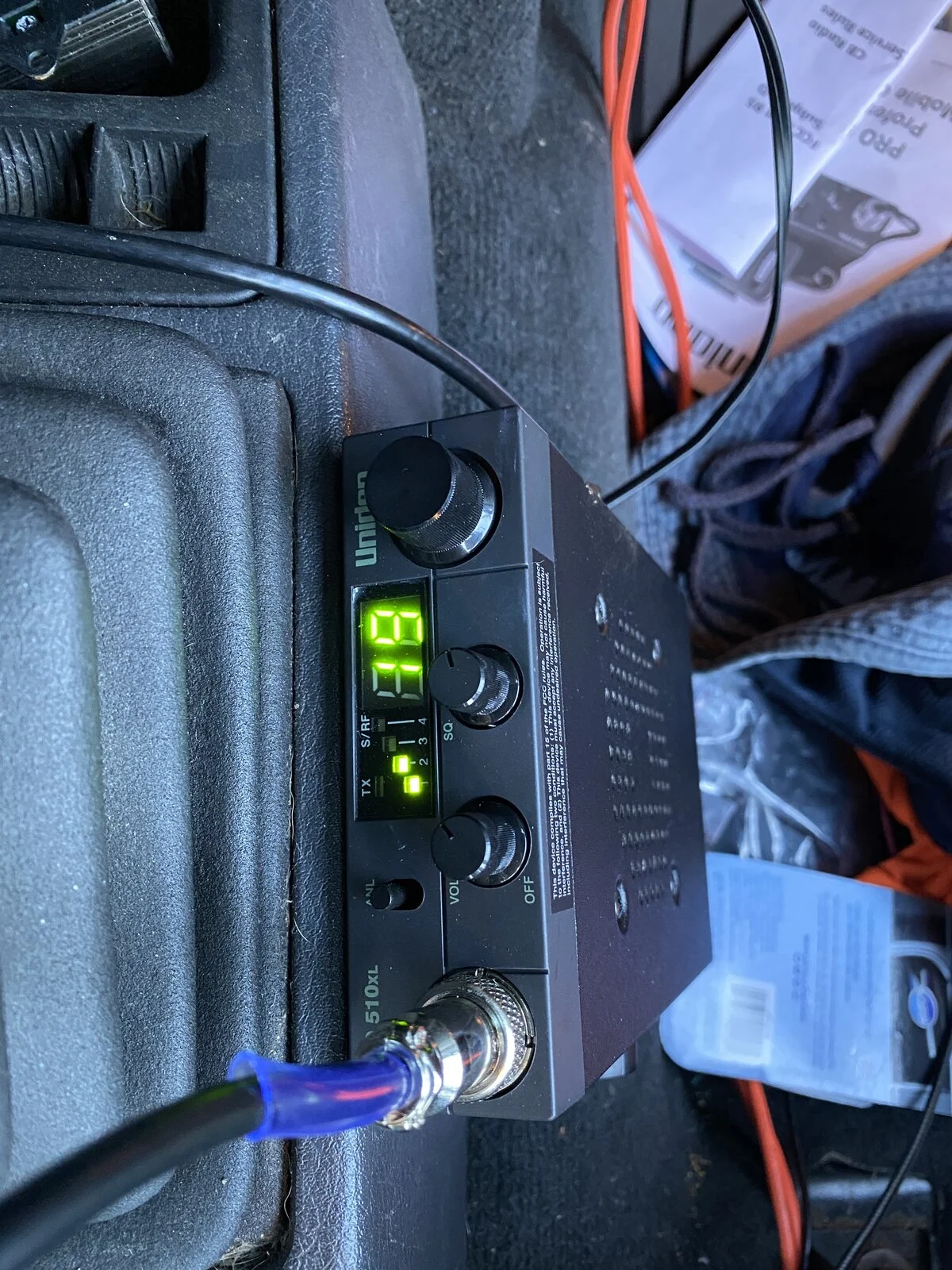

I need a little technical help with my CB install. For reference, the unit is a Uniden 510XL, the antenna is a 4’ Firestik, with spring and AUX connector adapter, and is mounted on my front bumper. I scraped off the paint on the bottom of my bumper to make a ground connection for the bottom of the antenna. I did not grind it with a grinder, but I did file it down. Checked the continuity with a meter, and it seemed good. Per the diagrams, the connector half below the bumper has continuity but the half above the bumper does not. The AUX cable is run through the firewall via an existing penetration (not sure what is currently running through) and inside the Jeep to the CB. The excess cable is folded (not coiled) to one of the supports under the hood. The CB power is wired directly to the battery. I also bought a SWR meter and tuned the antenna to 1:4 at Channel 1 and 40.
So my issue seems to be when I am driving (or at least seems to significantly worse when driving). I can’t seem to pick up anything but static when I am driving. The 4 led lights on the CB unit seem to be maxed out at all times (all 4 are constantly lit) and all I get is static. I can turn the squelch all the way clockwise, and the static is there for about 75% of the turn. All four led lights are continuously on no matter what I do. I can’t seem to pick up anything other than the static. (Ironically I drove my other vehicle with a CB and untuned antenna and get a decent amount of chatter.

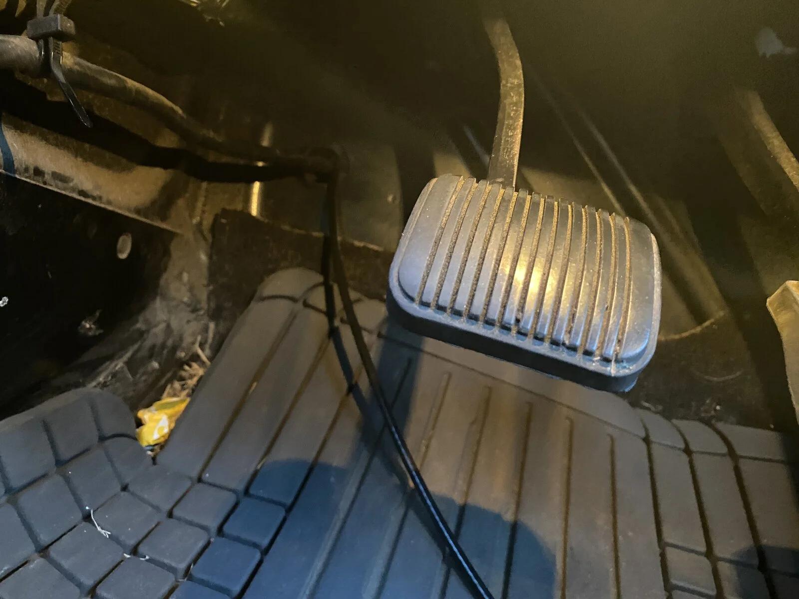

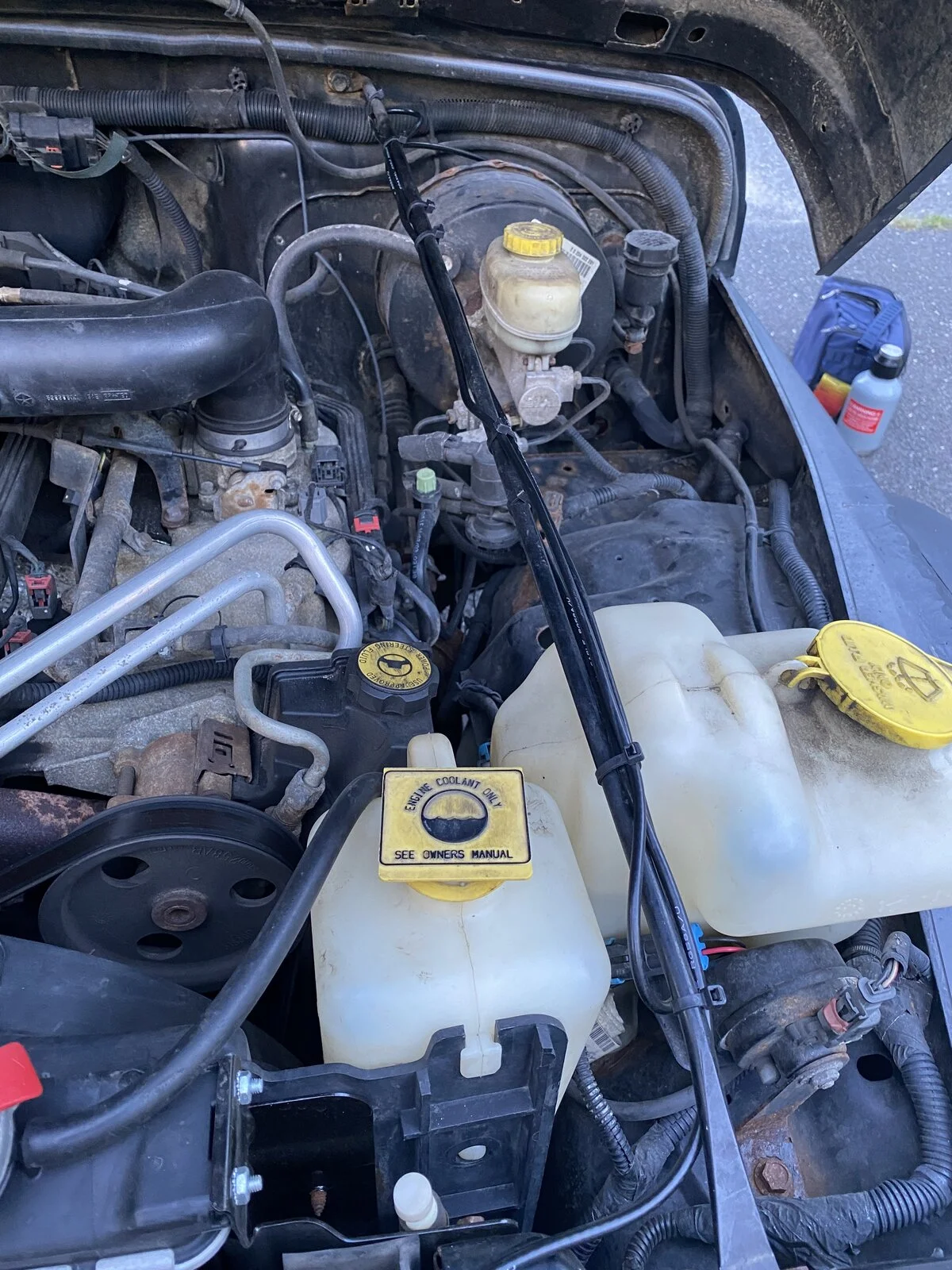

A lot of your antenna is up close to your metal body parts which is absorbing a lot of your signal (grounding it out) for both receive and transmit and may be affecting your SWR on transmit. This is why you need to mount the base up higher to get above as much metal as you can. Many people use a tail light bracket mount, which I have for my 2M ham radio antenna and it works very well. Additionally you have your coax under your hood close to your spark plug wires and alternator which radiate interference and some of that will penetrate your coax to give you static noises that overpower any weak signal you are trying to receive. Again a good reason to move your antenna to the back of your jeep to get it as far away from that as you can. Good luck to you.

The extra cable has some signal loss, it's not a big deal. The cable is shielded so it doesn't matter how you wrap it. The engine compartment gets absurdly hot so don't expect that cable to last more than a few minutes if it isn't rated way over 100C or 250F. I keep my cable on the other side down low and away from the catalytic converters. It would be garbage after one run in my engine compartment sitting on that support where you have it tied. I haven't checked my cable but if yours says 100C it's way over every time you drive around the block. It's possible you just cooked your cable.

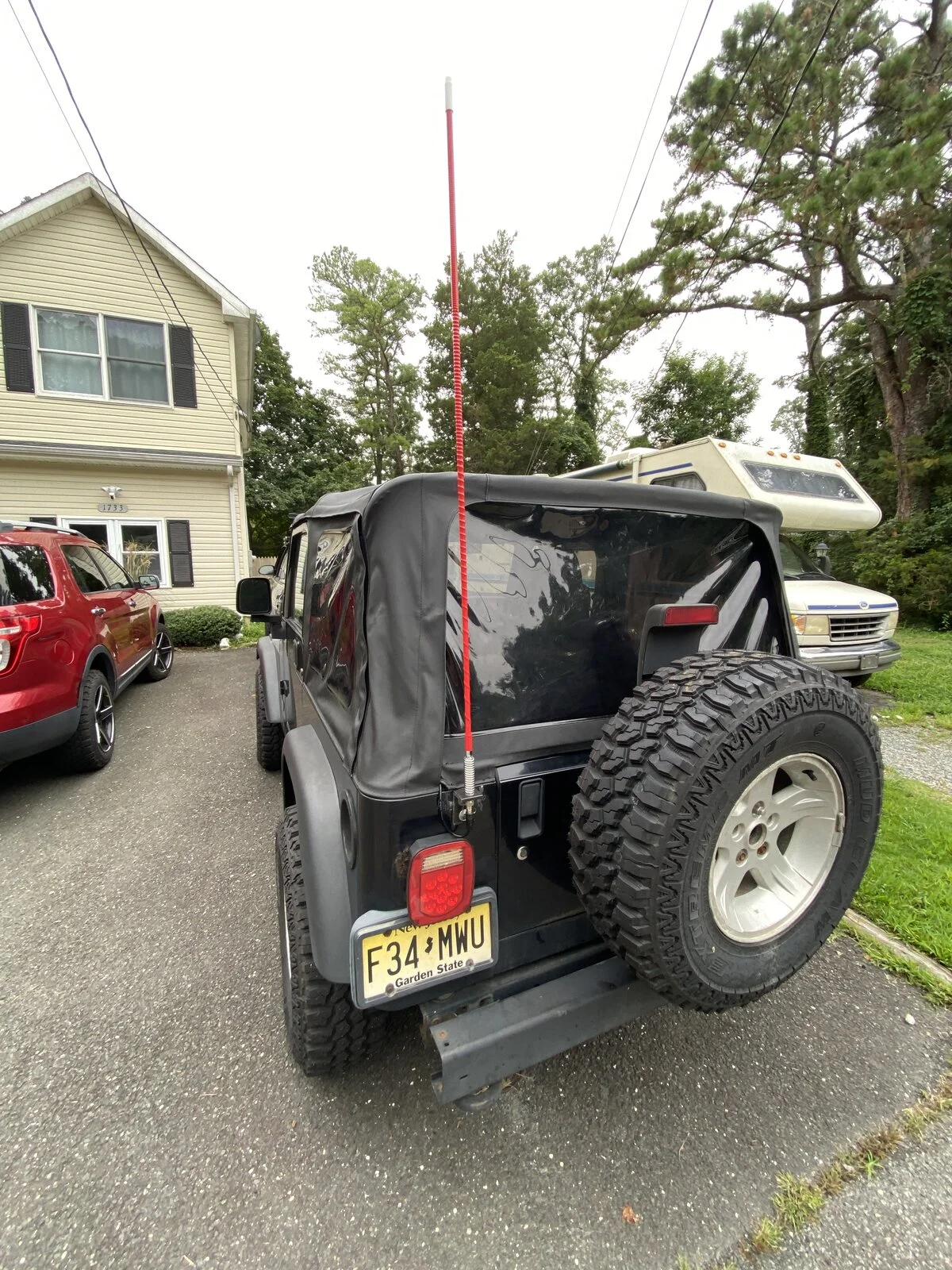

First off, that is a damn fine looking rig you have there. As far as my antenna, I took the advice of several guys here and ended up relocating it to the rear of my Jeep. I intended to remove the spring but apparently the stud coming from the bottom of the antenna wasn’t long enough to make it though my mounting bracket…so the spring will stay for now. It’s actually not as flexy in the back as it was in the front.

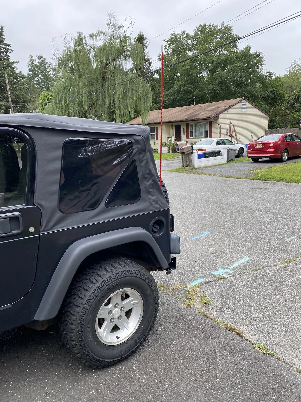

Thanks everyone for your quick and helpful replies. Long story short, I ended up relocating the CB antenna to the rear of the Jeep, right above the driver side tail light. Used an aluminum bracket and bolted it to the tub (cleaned the paint on it all to keep a good ground). Reinstalled the antenna back there and hooked it all up. Tuned it to about 1:5 (could probably get it down a little bit more, but I think I’ll have to remove the spring first to lower it a little). But from the second I turned on the radio after relocating the antenna to the back, it was a night and day difference. I immediately noticed a difference in the reception clarity and could actually understand conversations. Still have to fine-tune a few things, but definitely a huge improvement.
Nicely done, I'd only change two minor things if that was my setup. First I'd replace that 4' (5'?) antenna with something more manageable like a 2' (like I run) or certainly no taller than a 3'. Then I'd get rid of that spring which will allow the antenna to sway around wildly and bang onto the soft top like crazy when you're offroad.
Even a 2' antenna gets out very well and it doesn't get in the way of garage doors, low parking garage obstructions, etc.

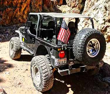

This is my TJ with its 2' Firestick antenna. Its length works very well, I have no trouble communicating up to several miles with it. Its American flag is zip-tied to the top of my antenna. No clearance issues since getting rid of my 3'
and 4' antennas, it performs very well.
