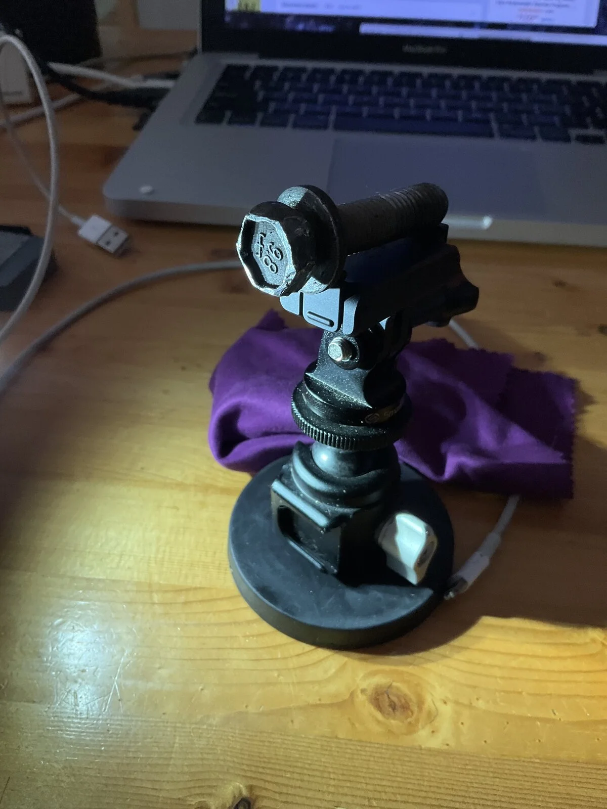

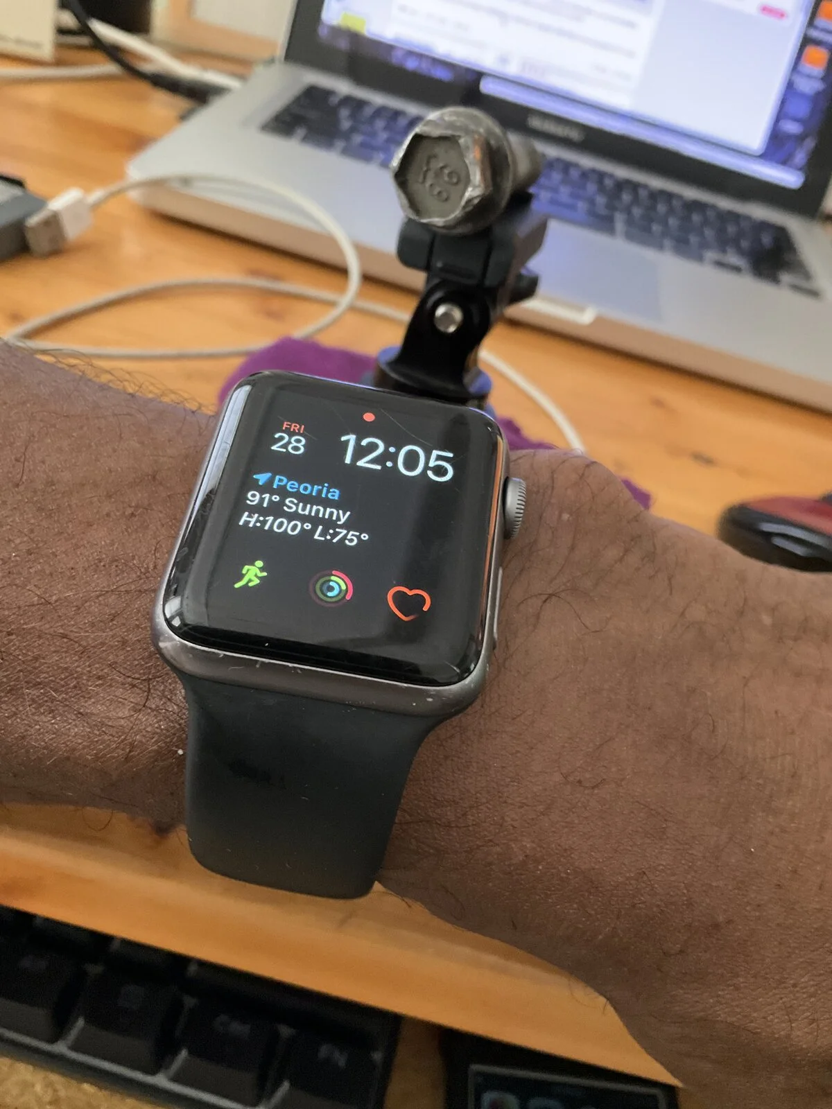

Its was 12:03 pm, 100 degrees in sun, no shade, swollen wrist, feeling great, after a week, I got that DAMN top bolt out, took a hammer and iron rod and tapped on the bolt and the starter mount then finished off with a 12 volt Bosch pocket impact drill. Now I can get this thing bench tested and continue with my summer project, a running Jeep, feeling accomplished, thanks for all advices.
