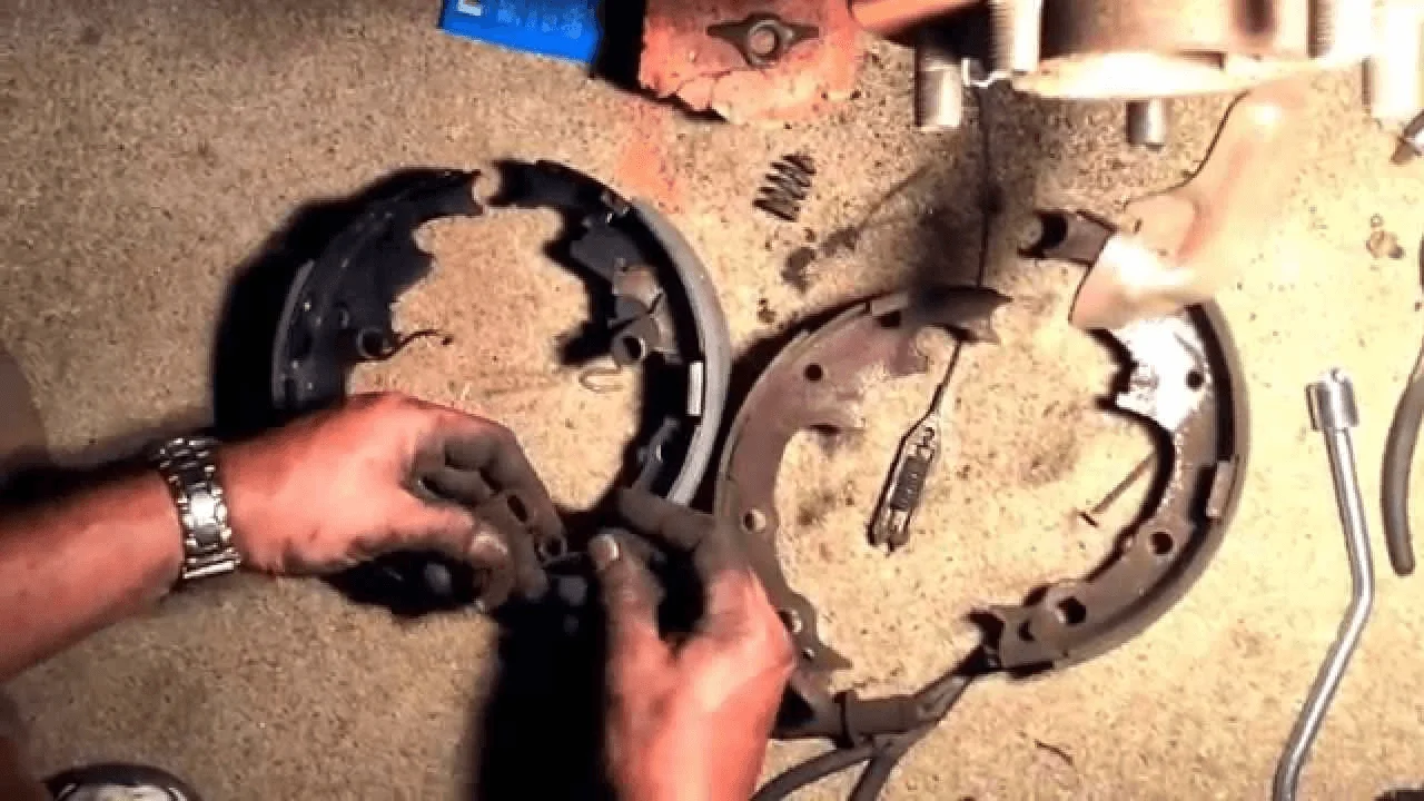

Is this your first? Very important to know because the 2000 Sahara rear brake is a drum and is a bit complicated for the rookies.
