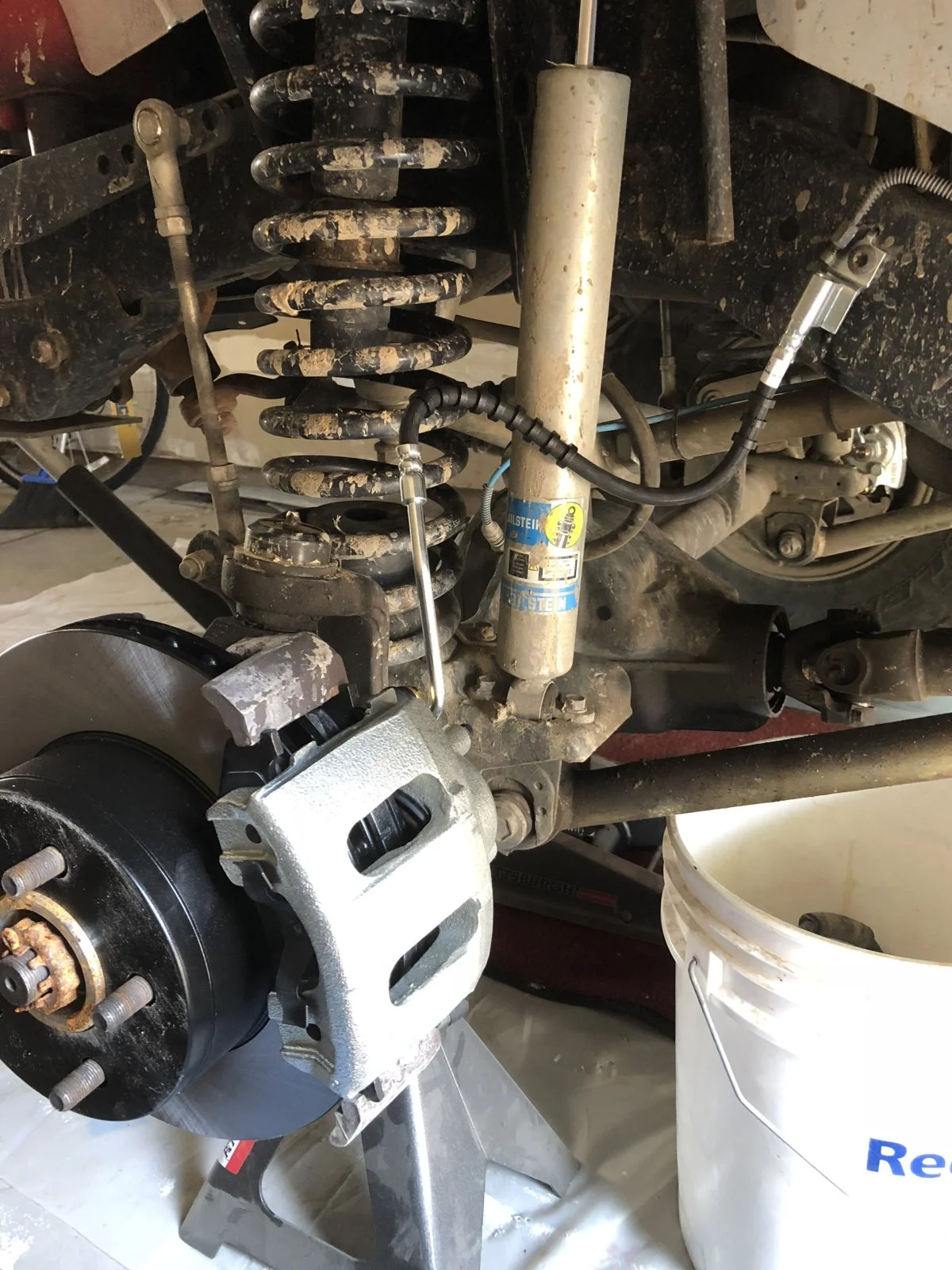

OK, so you are saying do two bed-ins back to back with a regular cool between them, then do a third later in the day after the rotors have completely cooled? I just want to make sure I don't screw this up.
I didn't know if the invoice would help you. He bought all 4 pads and rotors. Who knows what the guy did, I just want to get them right.
A single cycle is get them hot, drive around and cool them down.
Get hot
Get cool
Get hot
Get cool
Wait some until they cool down to ambient
Get hot
Get cool
Get hot
Get cool
Report findings.
You will need to be aggressively and safe. You are pushing hard enough to achieve lock up. If you are finding it unsafe at 60, drop it down to 45 or so.
Black Magic pads and Centric Premium rotors.

I have 33s on 2004 LJ and I'm running Black Magic pads that the PO put on. Personally I'm not impressed at all with these pads and they were bedded in properly. I will eventually be going with Pro Stop which is Centric's performance line. I have them on another vehicle and they are great. I would recommend getting new rotors as well. RockAuto would be a great place to get all of this.
DON'T FORGET you need to bed your new pads in...
Get your Jeep up to around 60 MPH then put the breaks on hard to get your speed down to 15 MPH. Do this 4 to 5 times right in a row without stopping completely. If you've done it right you will smell the brakes. Once done DO NOT COME TO A COMPLETE STOP, continue to drive for at least 15-20 (the longer the better) mins using the brakes as little as possible (a highway is a good place to get on). Once done come to a gentle stop at home and let the Jeep sit over night for the rotors to cool completely. There are varients of this procedure but they are all similar. Been doing this and it's amazing how well it beds the pad, which means imparting pad material onto the rotor. Black Magic require this too.

As Blaine said above, no doubt either they weren't broken in properly or after they were, you did not use them aggressively enough on occasion. They won't remain awesome with nothing but normal braking. If you continually brake gently and never really haul the Jeep down from a fast speed with them they will lose that awesome stopping power they are capable of.
When I notice my Black Magic brakes are not working quite as well as I have become used to, I just do a quick mini-breakin by multiple aggressive stops hard enough to heat them up again and they then return to their former awesomeness. I don't consider the break-in process is being done properly until I can smell the brakes getting hot.

I want to clarify my statement from earlier in this thread as to how I wasn't impressed. Blaine reached out to me privately immediately to address my dissatisfaction. He asked me to take detailed pics and send them to him. Well that was 5 months ago and I'm embarrassed it took me that long to finally get around to it. Blaine took one look at the pics and said the pads were in upside down.
I can't say I'm all that surprised since the PO installed them with many other things and I've found QC lacking. Regardless, Blaine and I discussed the situation and what I will be doing moving forward. I can tell you this based on our conversations... the guy is serious about his product and customer support. I know that is well known on this forum and I'm not saying it to be a kiss ass, just pointing it out.
