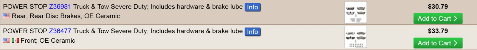

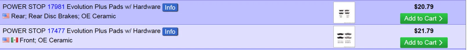

Sorry I meant POWER STOP and I am incorrect, they are not associated with Centric, STOPTECH is (I got them confused). I get my pads and rotors off of RockAuto because of the crazy low price. Here is the pic of the RA link. I have used Centric pads and rotors many times in the past and like them a lot too.
