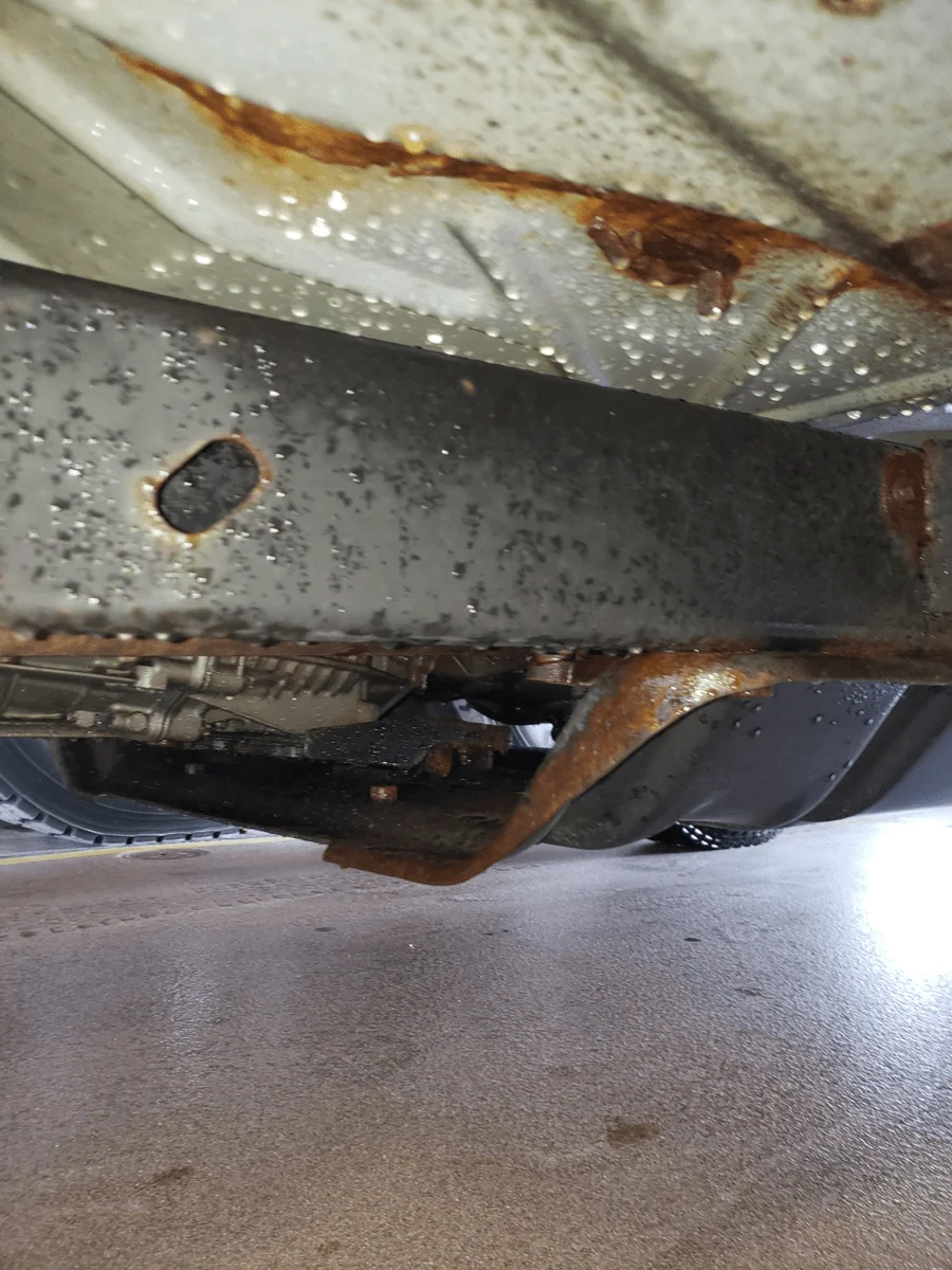

TC Skid itself was fine, but 2 of the bolts are going to need to be drilled out.
Why do they need drilled out. The TC skid is not the issue; rather, it is the frame rails where the TC skid attaches that is one of the 3 notorious placed these frames rot out. The other 2 are near the front and rear LCA mounts. Pics would be nice of the these 3 areas.
Here is the best shot of the TC skid I have. The rust seen here on the frame is pretty consistent everywhere. In this shot yo ucan see the rusted bolt poking out from the lip on the TC plate.
