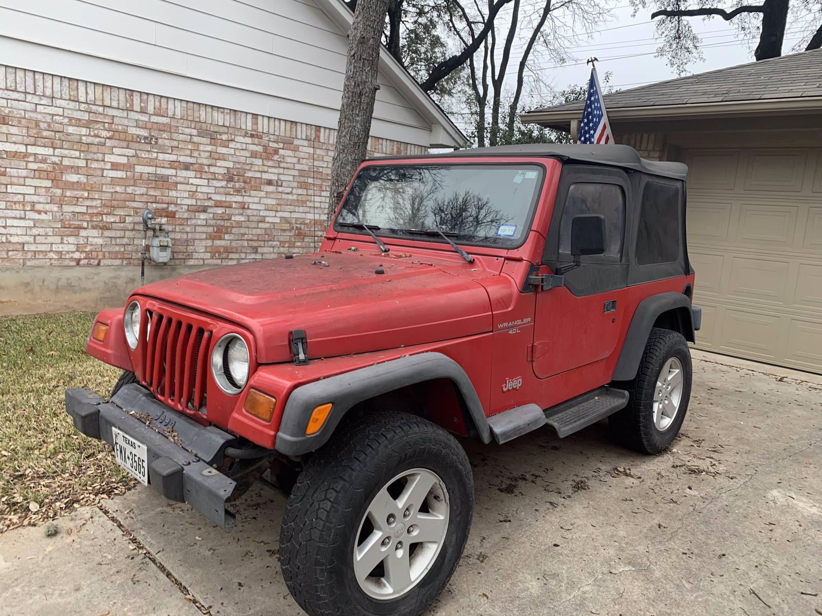

I'm a first-time TJ owner, so this is all new to me.
I'm pretty comfortable working on vehicles (mostly chevy/dodge trucks so far, but I've taken to it pretty quickly) and I'm excited to learn more because owning a half-door TJ has always been a dream of mine.
With that said, I have so much to learn and any help/comments are much appreciated... thanks in advance y'all, this seems like a great group already in the few posts I've read.
Completed Items
Upcoming Items
Bought a 98 TJ off my brother and I'm fixing it up. She has 130k miles and was initially babied as a high school starter vehicle (x2) with <6k miles per year, but sat over the last year when my brother got a new daily driver. I believe the only mods are a 1.5” body level + 1.5” spacers all around, but the rest is stock.
I'm stripping it down, going to replace most everything under the hood, and raptor line all the red paint while everything is stripped out - going to be a ranch vehicle & no paint will survive a few weekends in the mesquite without Ceramic Pro or some other expensive junk.

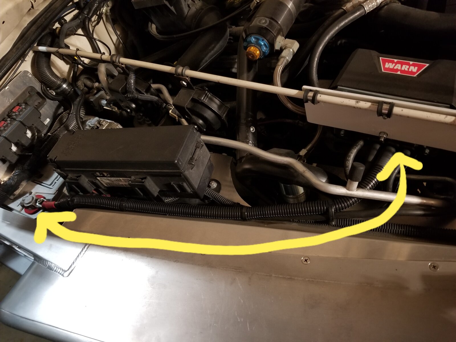

RE O2: I’ll look into mopar
RE: Winch: I’ll look into it more but I don’t know if I’ll be able to get circuit breakers big enough, peak draw on those 7,500+ are like 340A, just don’t want to blow my battery
Circuit breakers? You wire the winch directly to the battery.
That's not remotely a concern.
Also RE: 340A, I’m still trying to calculate auxiliary peak loads... don’t have my wiring quite figured out but I’ll probably put an inline circuit breaker at the side post, something like 100+100+100+50 just to be safe.
Thanks for assurance because I’ve heard bad stories of having overpowered winches, but that may be exaggerated...
I was going to break the hot 2 gauge from auxiliary side post, but direct works too I guess 👌
I should clarify. From the control box straight to the battery.
Myself, mrblaine, Jerry Bransford and several other members all have Warn 9.5k lb 6hp winches.

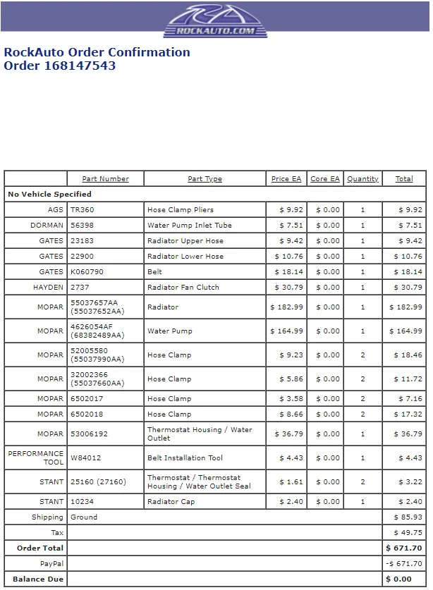

  6. Doing this super helpful Cooling Overhaul (thanks @Chris )
    "...for a 1997-1999 (4.0 liter 6 cylinder)
    • Waterpump: 68382489AA
    • Thermostat: 52028186AC
    Thermostat Gasket
    • Radiator: 55037652AA (Manual Transmission)
    [NEED HELP HERE ~~~ AMAZON SAYS THAT RADIATOR WON'T FIT A 98 TJ ~~~ I FOUND ANOTHER ONE HERE that Amazon tells me will fit instead, ANY THOUGHTS???]
    • Upper Radiator Hose: 52028264AB
    • Lower Radiator Hose: 52079670AA
    • Fan Clutch: 68065080AA
    • Replacement Radiator Cap: Stant #10234 (yes, this part is a must if you're refreshing your cooling system)"

Hey Chris - any idea on the Amazon radiator piece here?
It will fit. The only differences in the radiators are the automatic versions have a provision at the bottom for the transmission cooler whereas the manual versions do not.
Guessing this same answer carries forward for that mopar water pump package... the link you had in your cooling overhaul to WE R MOPAR website says the package won't fit a 2000 Wrangler (won't let me search before 2000)...
