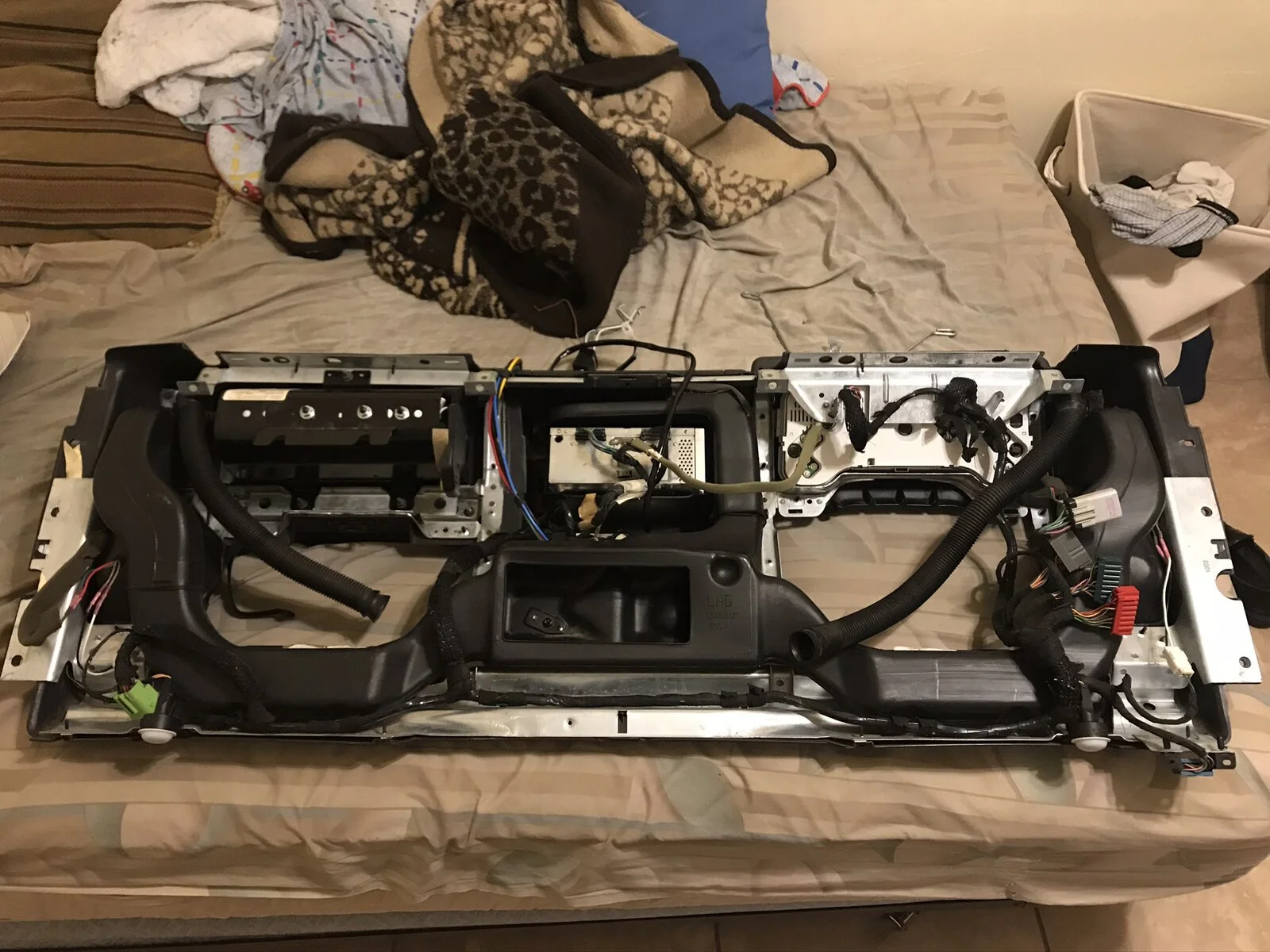

Oh dear, you seems to have tackled it in even more detail. I can see your whole dash board is out . Nicely done.
The best part is I could still drive it
, one thing is pretty clear, I am very proud of myself for being OCD for things I am emotionally attached to, but you surely are at another level .
How difficult was taking that dash apart?
Wow I didnāt notice your question until now! It wasnāt hard at all. It was removal of the three nuts on each side by the speakers, I think three or four bolts across the top of the dash under the defrost trim and the thing pretty much lifts up and out. You just have to take the connectors apart where they connect from the firewall to the dash. Hereās a good picture of the backside from my 02. The steering column has to go too but itās only 4 bolts holding it in.
