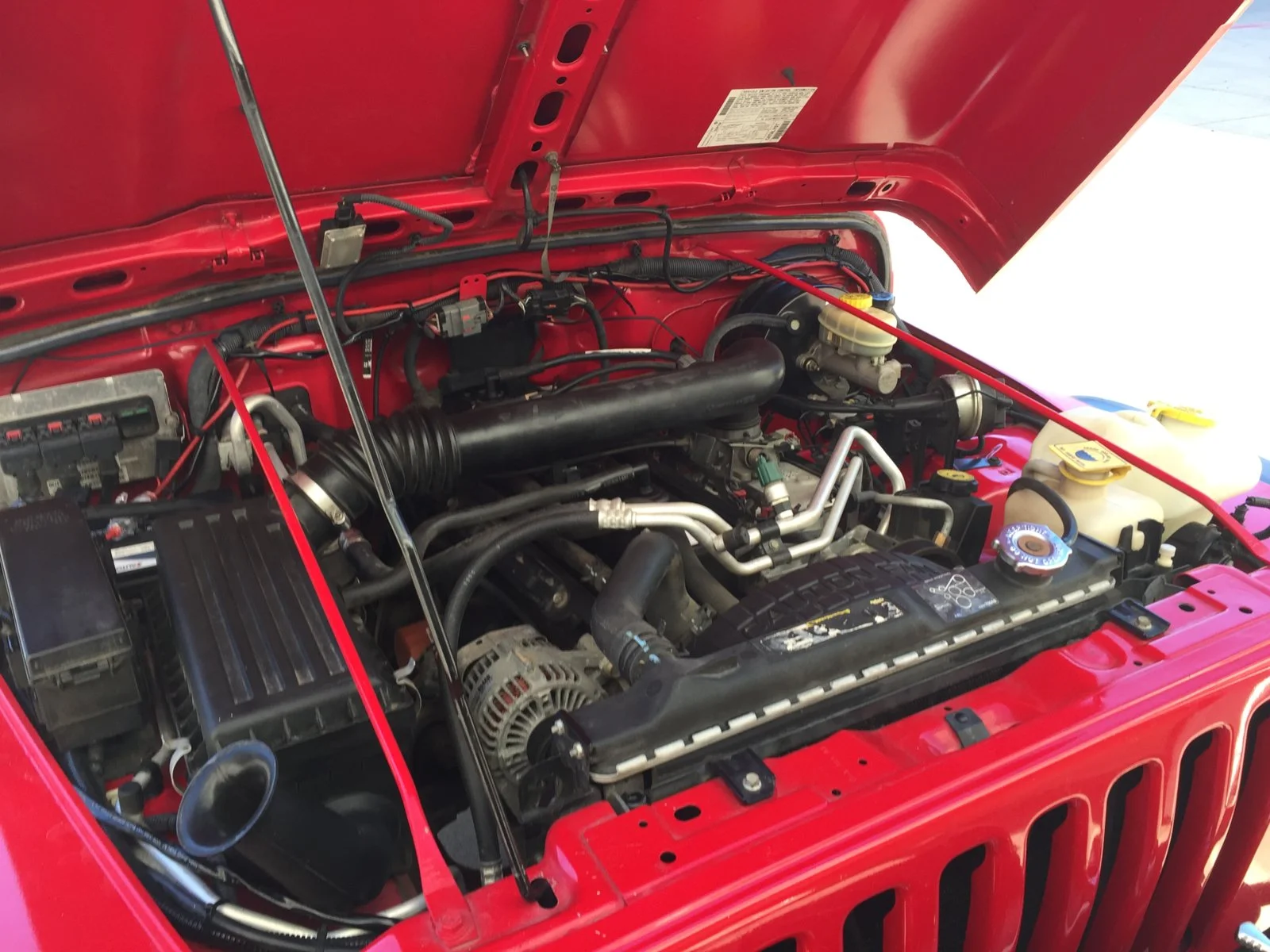

2006 Jeep LJ 4.0 6 speed. Just cleaned it up the other day and detailed the engine bay while I was at it! (Who does that right?)

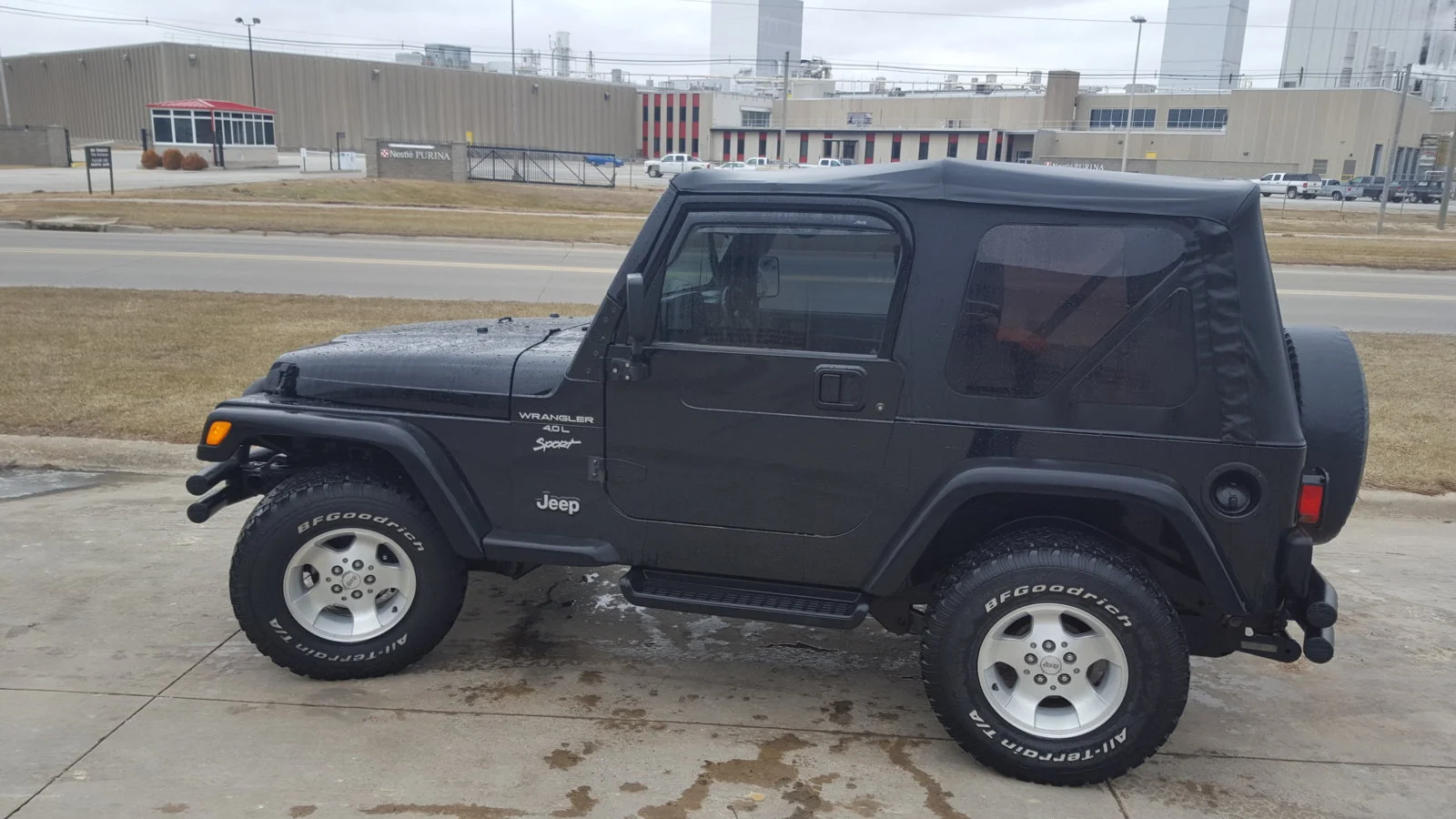

Happy to help! So there are a few different things you can do. You can spray de greaser (mostly on the block, firewall, and inner fenders) and let it sit for 10-20 minutes. Keep the motor running and spray it with a pressure washer. Try to avoid spraying the battery, altenator, and air box (a little won't hurt so don't freak out to bad if it hits lol). Be sure to spray underneath the hood really good too. And honestly the only other thing I do is take a micro fiber cloth or red rag that you won't mind throwing away when you are done and give every inch that you can reach and touch a good wipe down.
I didn't use the de greaser in that last photo on this jeep. This one was already really clean due to the low mileage and wasn't off tossed. Just dusty. A damp cloth does wonders though.
