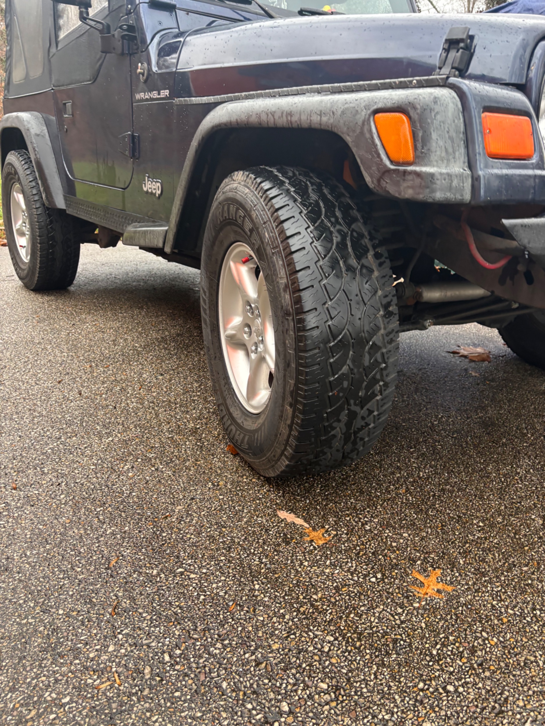

When turning the steering wheel so that the wheels are out of 45° angle left or right I get a thump.
I’ve replaced all Driveshaft U-Joints (Have axle U-Joints on hand), tie rod, drag link, Track Bar is about 4 months old but it’s a rock auto special, and all ball joints
