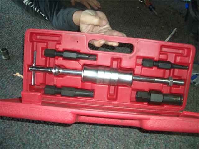

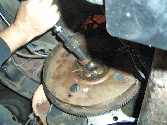

E-10 for the transfer case, E-12 for the transmission. Rent/borrow a "blind bearing puller" from your local auto parts store, it makes removing the bearing very easy.
we used the pack it with bread method. my brother was laughing saying "THIS SHIT WILL NEVER WORK" he shut the fuck up when it popped out !
