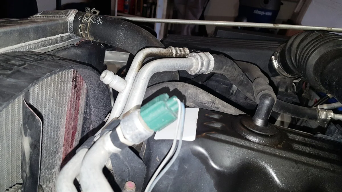

Both required grill removal. The Wizard died a horrible death. It leaked from the top. There was a bit of a gel like substance in the lower outlet. They blamed the leak on that and denied a warranty claim on a nearly new radiator. We flushed the system before we swapped it in. I don't know what the gel was or where it was from. I am 99.99% certain that it can't make the tube rows above it leak though. It was not clogging the radiator nor were there any blockes tubes we could see.
The Northern has had no leaking issues. It was not made for a TJ with AC, we had to rework the mounts and pull the grill to install it. I won't do that again.
