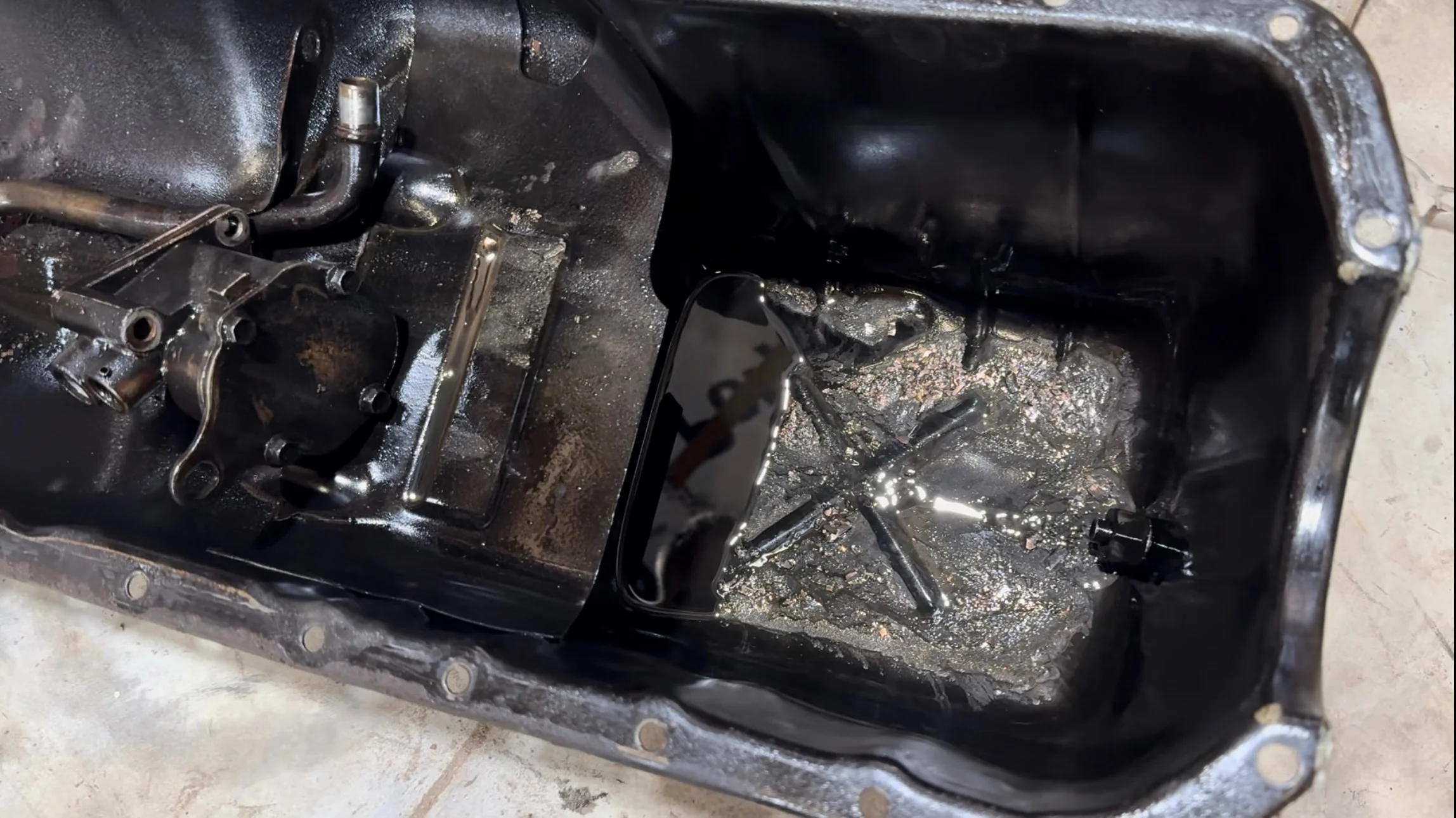

After seeing low oil pressure, I pulled the oil pan and the engine is toast.

I’m not a mechanic. Looks like quite a bit of brass in the bottom of the pan and the connecting rods have a slop on the crankshaft
Just bought this jeep for my son a few months ago and it had been running fine

Rolling in new crank bearings is completely doable without removing the engine.
You'd need to remove the exhaust and drop the skid plate.
Then the oil pan comes off. (And you already ate there!)
Remove the girdle. Then pull off a bearing cap. Back side should have numbers.
I'd do a rear main seal at the same time. And a new Melling oil pump.
If the timing chain moves a lot...you can just get a finger on it...then I'd do a new one. And if I was going after a timing chain I'd do a fan clutch, water pump and crank pulley.
Lots of YouTube videos on this. Check out DexJs - almost all Cherokee content but a 4.0 is a 4.0.
Jeep 4.0s are the easiest engines to work on. Parts are cheap.

And I'd trust rebuilding yours rather than a gamble on something used.
