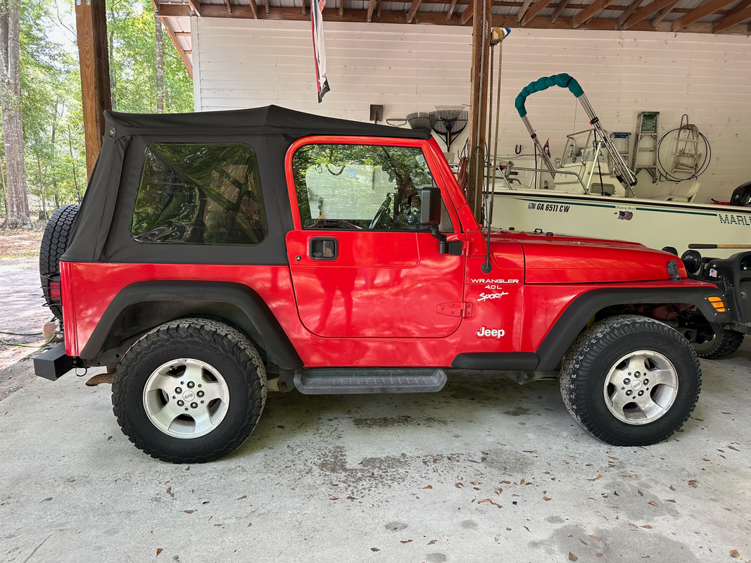

I'd love some preliminary input on the photos I've got, and help with knowing what to check for when I get there (we'll definitely be getting underneath to see the situation). I'm bringing a mechanic friend and his buddy who he said would be perfect to check it out, so I'm not worried about that.
Here's the information my friend forwarded to me:
2000 Wrangler TJ Sport, 4.0 liter, 5 speed manual.
He bought it with about 120k miles from a dealer who got it as a trade in. 158k miles currently, not much offroading or highway driving. Clean title and carfax. some paint blemishes, and could use a new weather seal on the front windshield. Original engine and transmission. 4x4 hi and low both work, came with a set of 30" BFG all terrains when he bought it.

That said, it looks clean and sounds clean. It's a street Jeep, looks like it has been, which is all good. The frame and rust is thing 1. Don't just look at the outside, put your finger in the openings and try and see if you can get a feel for if it's rusting underneath. I'd look at what axles it has, my guess would be Dana 30/35 combo, which isn't a reason to not get it, but also not a premium. I'd look at the Control Arm bushings and the track bar bushings. It's not big $, but do they look like they might need to be replaced. I'd drive it and find some pot holes, bumps etc. while test driving it.
Sounds weird, but personally I've done that hoping it starts to wobble, knock off $2k, and tighten some loose connections.
I wouldn't personally go $10k, but it's what you're willing to pay, not me. I've never had a 2000 specifically, I believe there were head cracking issues, maybe some others can point that out.
Just don't be fooled, pay what you need to , but there will need to be a budget for parts on a 24 year old Jeep.

like has been said check the inside of the frame. There's a big hole just forward of the rear tire you can stick a finger in and feel around for roughness or chunks falling out. Another thing to check is does the air change from defrost to vent to floor. take a code reader and check it for codes and pull a car fax to check for accidents and such. what part of GA are you in ?

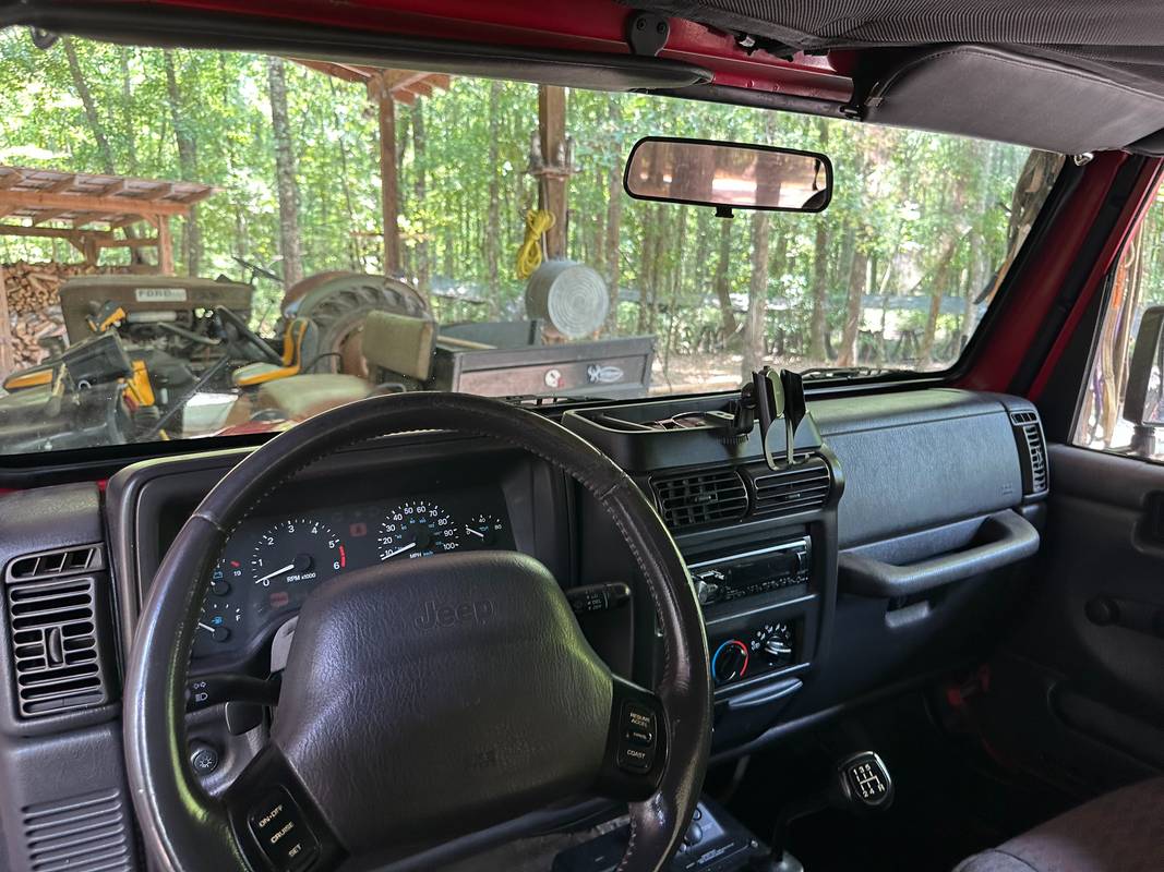

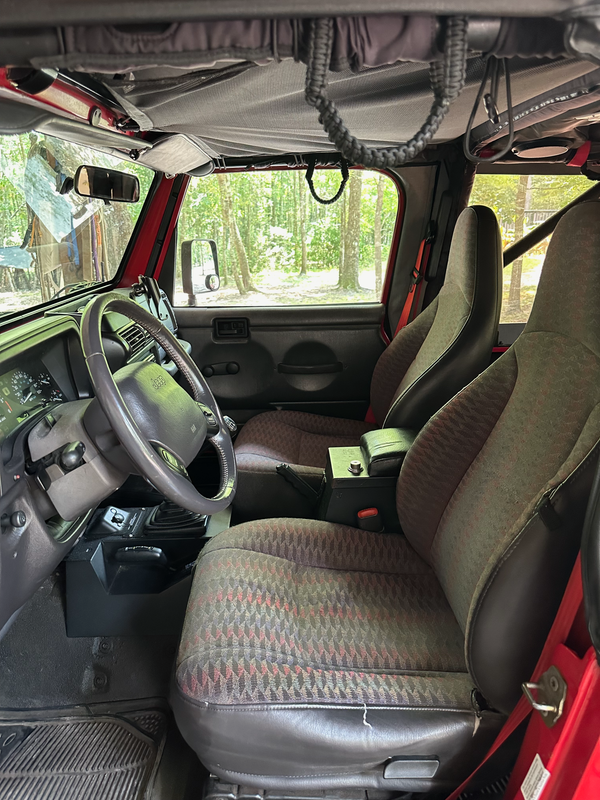

looks to be in good shape. what's going on with the top? looking at the interior photo, it seems stretched in a way I'm not used to seeing. you'll definitely have more fun with it than the Golf.

I had to look at it about 3 times really close and it looks like some sort of added liner, I don't believe it's the top itself
Prices are really low now. I think it's worth $7500-8,000 tops. I've had three 00-01' Jeeps and two of them cracked the heads. Just something to think about.
p.s. The gas tank skid is rusted.

It is one of those add on mesh tops. Like mine it can stay on even with the soft top on. You can just see the tie to the bar on the windshield.

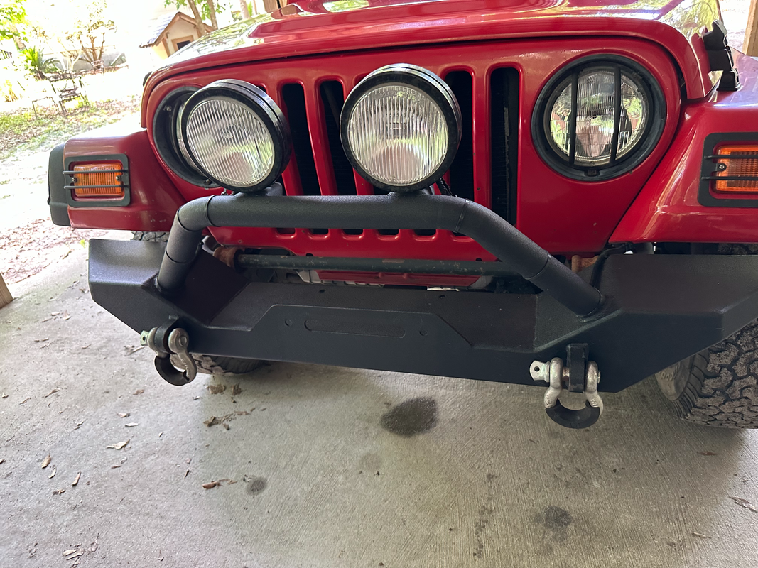

In fact, I would sell that heavy front bumper and put a stock one back on.

Looks like the Bestop Supertop; the one more similar to YJs and CJs.
