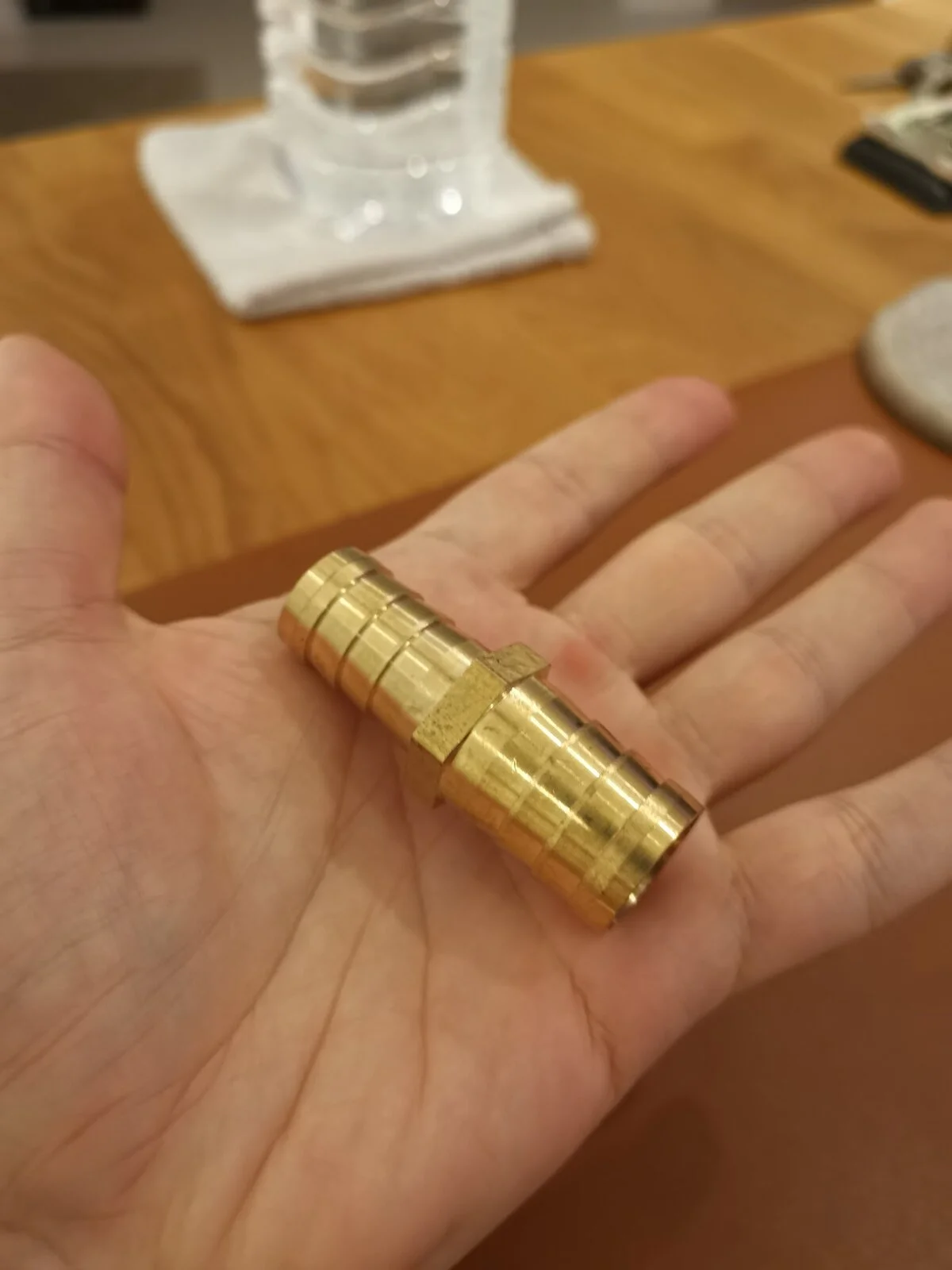

The day after I suddenly had steam in my whole car and figured the heater core broke (thanks google and this forum), which also explains where all my coolant went. Since we've an average of 80 degrees here, and therefor I definitely never gonna use the heater, so I used the simple quick-fix and bridged the two hoses with a proper brass fitting (100% no leak there).

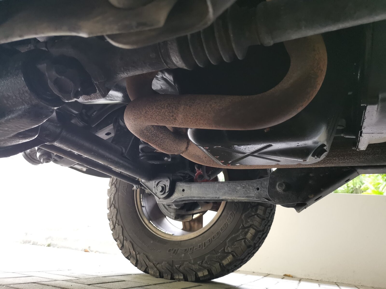

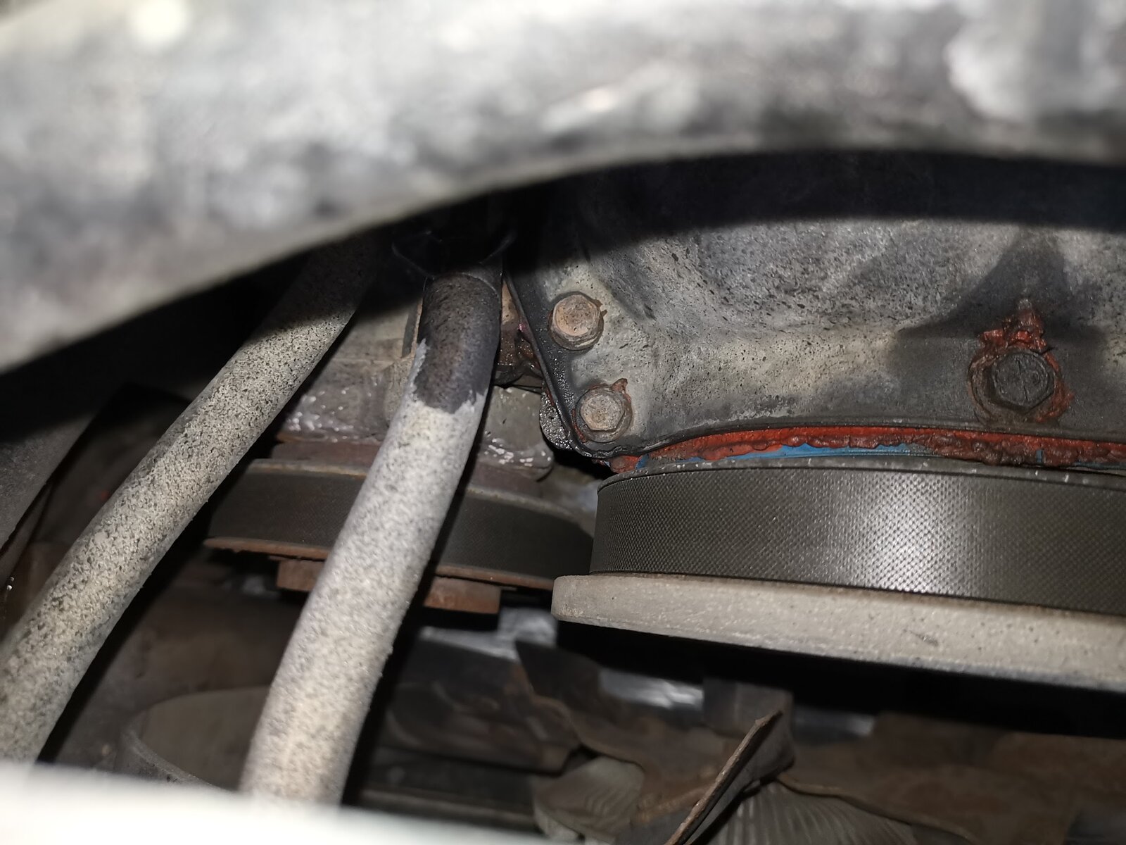

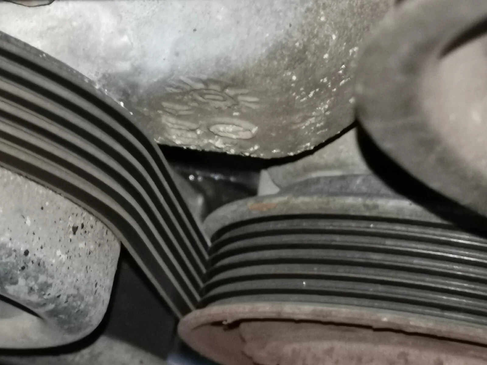

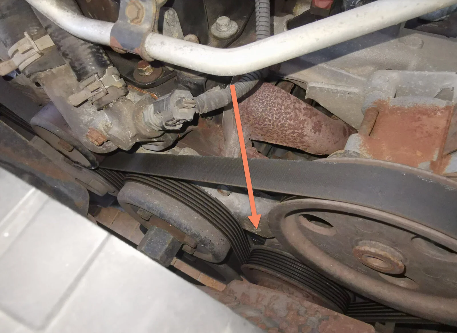

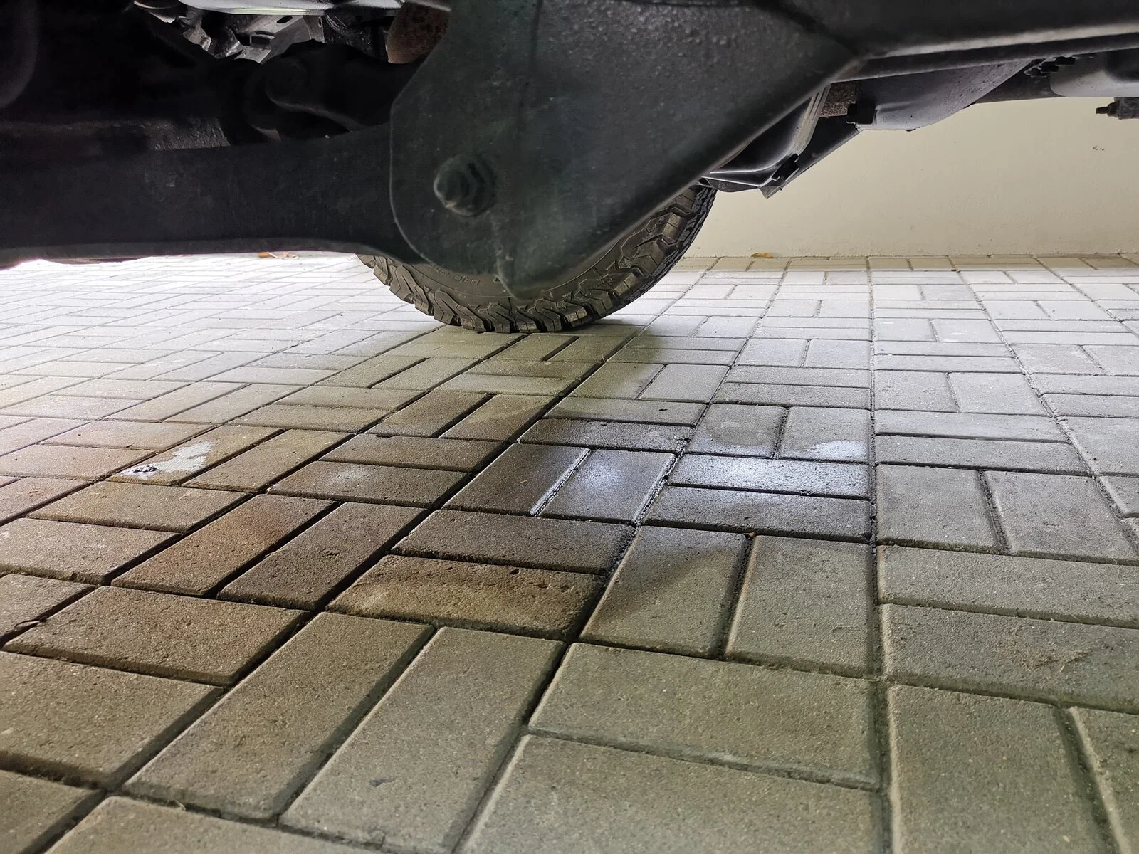

After that I thought everything would be fine, but today .. probably six weeks later (I don't drive daily).. my Jeep was parked in a puddle of coolant once again... 24h after I drove yesterday. And again the whole oil pan is all soaking wet from the front to the end. With the temperatures here everything dries quit quickly, why I'm surprised to find a wet puddle and a wet oil pan 24h later.
I climbed underneath with a flashlight and I can't explain how the whole pan is wett all over.. not a single dry spot.. even the screws all around have pink coolant on them. I assume it must be drips coming down the front and then get blown along the pan while driving, but again.. its quite hot here.. 24h later that would have been dry I guess. Also around and below the thermostat it's all dry, as far as I can see/reach. But of course the engine is hot, so it probably dries off... but how can it reach the pan then in the first place. It seems to loose coolant once the engine is cold....
Any hints, ideas, suggestions? I could re-do the thermostat and order another seal but I have the feeling that this is not the source.
