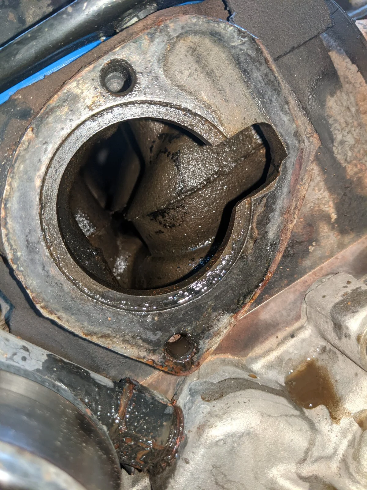

The last day I worked on this was Sunday, and I strained my right trapezius which was spasming and compressing the ulnar/median/radian nerves on that side putting me in a steady state of mind numbing pain and unable to really use my arm. So rather than getting the water pump replaced and filling the system with coolant, I went to bed with it filled with distilled water and now it's got rust again, despite looking really clean when I previously removed the thermostat to flush out the thermocure.
So I've got another bottle of thermocure and I guess I'm starting again from scratch tomorrow, other than having the new water pump on it.

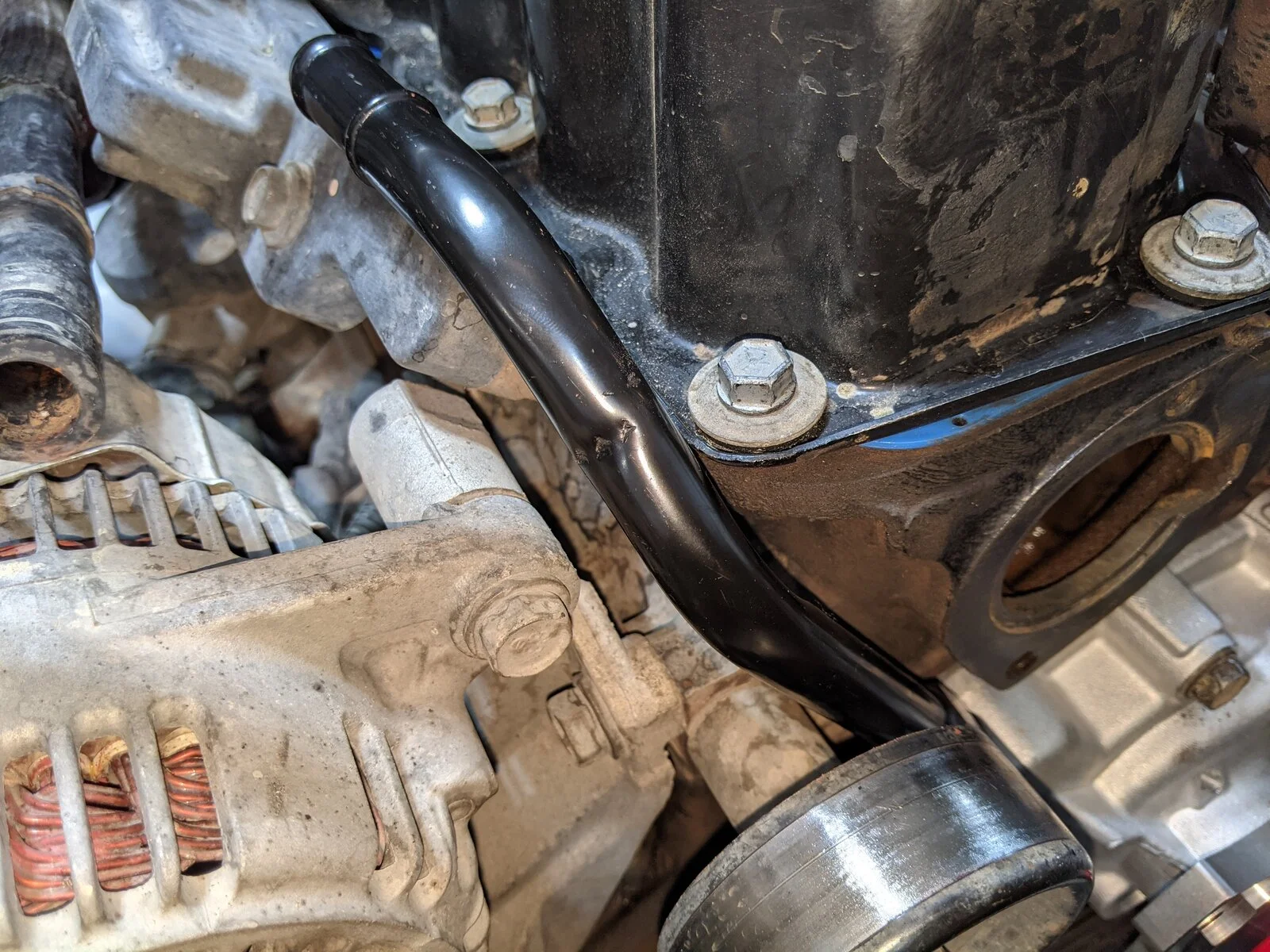

Nope, spoke too soon, gonna have to take that back off. I took the inlet tube a little too far and it was making contact with the valve cover so I tried to bend it a little bit and creased the damned thing.
This is just not my week, apparently.

Feel your pain, PS how clean is clean? this is 2 weeks after Thermocure, Radiator cracked, so taking the opportunity to also do my water pump. (Still cleaning the old gasket)

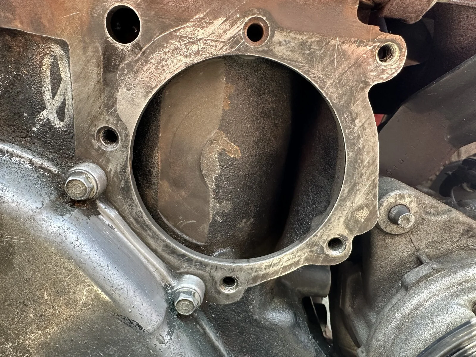

I'd like to see it as clean as what @mrblaine posted here.
https://wranglertjforum.com/threads/cooling-system-cleanliness.72024/post-1366677
I'm not sure how to get it that way though because I'm pretty sure even if it got that clean it would have powdery rust again by the time it was dry.
just a few posts above his is a photo from mine after the 2021 thermocure flush. It's worse than that now.
If it is still rusty, there was probably some old tap water in there that allowed more rust to form.
No, it rusted because he didn’t add anti-freeze to the water.
You’re confusing two different chemical processes. The first one is the rusting process. Iron in the steel, water (distilled or tap - it does not matter), and air combine to form rust. The hydrogen in the water, the oxygen in the air, and the iron in steel go through a multi-step process to form rust (iron oxide). First iron oxide hydrate is formed, and then it dehydrates, leaving rust behind. Using distilled water doesn’t prevent rust. That is why anti-freeze has rust inhibitors in it. Without those inhibitors, the steel will rust. It doesn’t matter if there are dissolved minerals in the water (“tap water”) or not. Any water without rust inhibitors will form rust in a steel engine block.
The second chemical process is the precipitation of dissolved minerals in the water. The precipitates are carbonates, which won’t re-dissolve in the water. They are that white powder that builds up. This is why tap water shouldn’t be used in a cooling system. Most tap water has dissolved minerals in it (usually calcium and/or magnesium). When the cooling water is heated by the combustion energy, the minerals precipitate out of the water and leave the scale behind. Once it precipitates out, it continues to build up, clogging up the water passages in the engine.
This is why Mr. Blaine recommends a two-step process. First, a de-scaler (I think Prestone is what he uses) is used to remove the mineral scale. Then, Thermocure is used to remove the rust. After the final Thermocure flush, you add coolant, which has rust inhibitors in it, to slow down the rust buildup.
So, use distilled water to prevent mineral scale buildup and use anti-freeze to prevent rusting. Both components in your cooling system are important.

ok, I was just going to do the Thermocure. Now, I'll do the Prestone and then the Thermocure.
