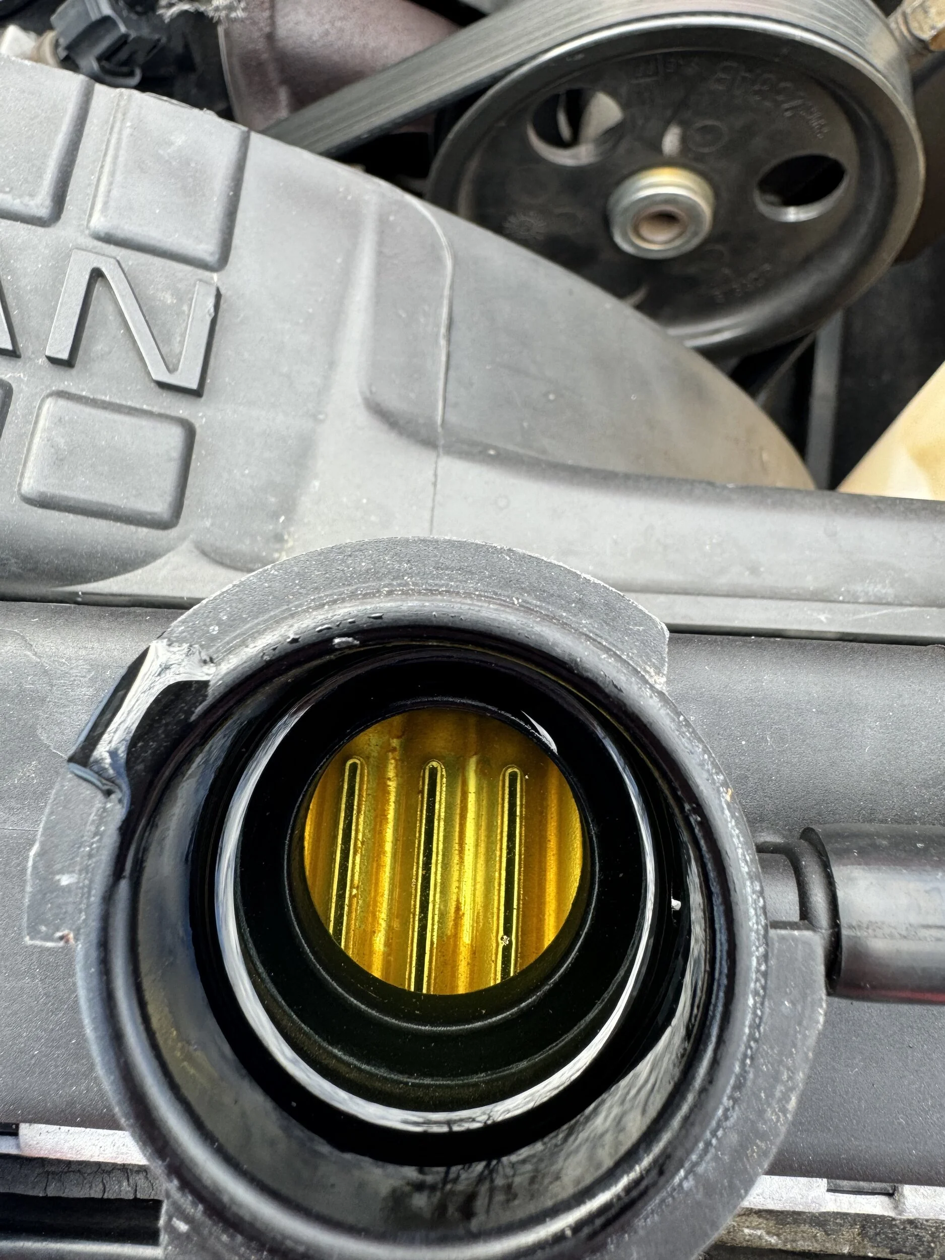

Looking back at this photo from before the second thermocure makes me wish I'd have just buttoned it up at that point and moved on, cause somehow it's worse now than it was. The only difference is that this one I opened up stone cold after sitting for days with distilled water, instead of opening it up still hot.
After chemical treatments and about 30 tap water flushes, 8 distilled flushes, I was still getting weird yellow sulfury looking flakes out and the water turning cloudy after a drive then flush.

I installed a new mopar radiator in Aug. 6mo later it’s got a thin layer of sediment that’s not floating but will come up if a scrape it. Normal, or is something else going on?
Mine has been worse than what you see even after thermocuring four different times over the past couple of years. I have a feeling that my issue is rust in the block that's not going way. But I'm also getting 3mm flakes of metal in the radiator along with rust build up.
The last time I filled the system, I used more concentrate than water for the first gallon then applied 50/50 mix. My thought was that maybe I've had water from the flush in the heater core even after draining from the block.
This isn't a solution to your issue, but this is where I'm currently at on the subject. Mine looked like yours does after only 3 months (between July and October). :( This was after a Prestone and then Thermocure flush.
