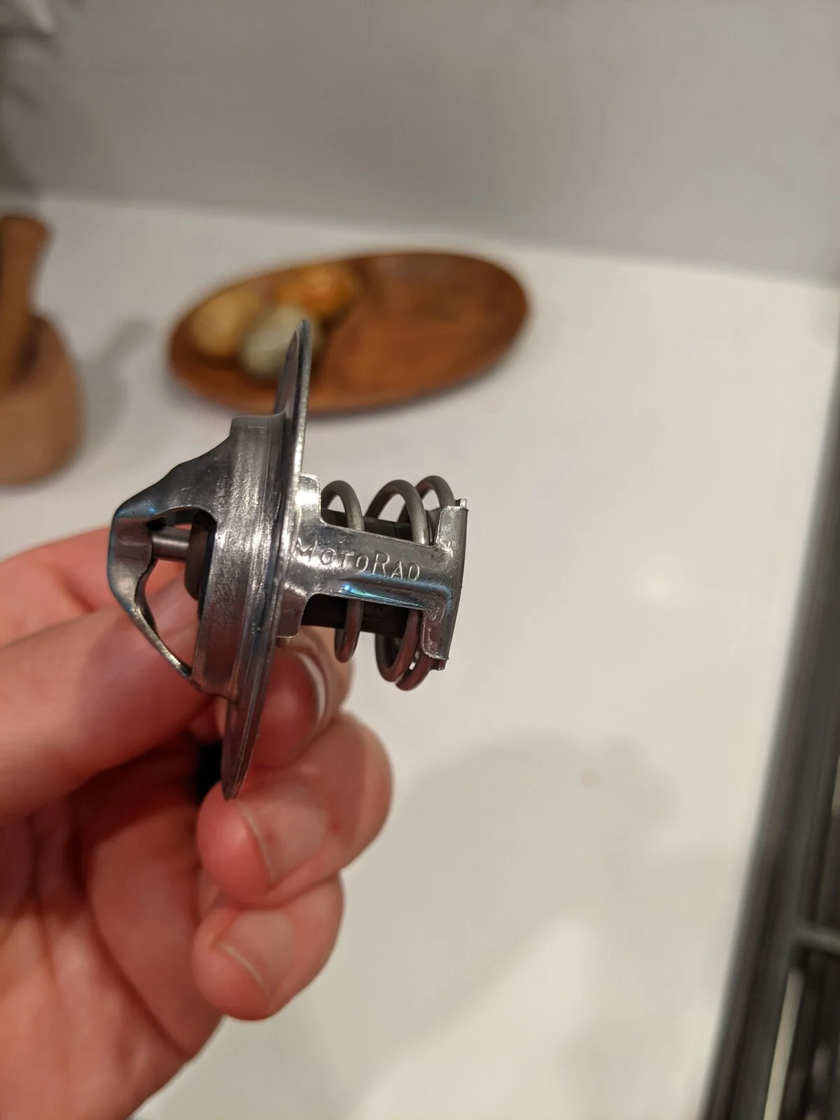

I got to examine and test the old thermostat last night and found some interesting things. It was a Stant Superstat but after the motorad acquisition so it has the motorad stamp, and is labeled for 195 which is what I purchased.
It has a jiggle pin but it's in the center plunger instead of the housing and has 3 struts vs the 2 present in the Mopar/Motorad. Not sure what that's supposed to accomplish .
When cold, it appears completely closed as expected.
When heated up, it cracks open on one side in the 150s.
It's opening more by 178.
And really open at 185.
I was really expecting to find some rust or a stray chunk of RTV from the previous owners hamfisted attempt at installing the previous one without getting it correctly seated, but it appears to just be a failure. I won't be using another one.

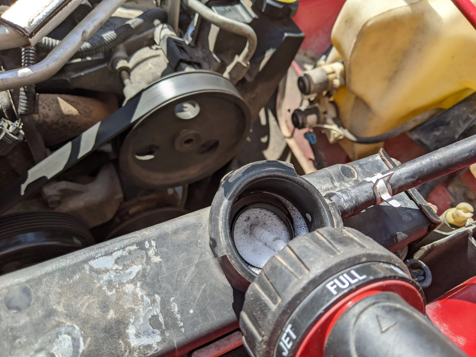

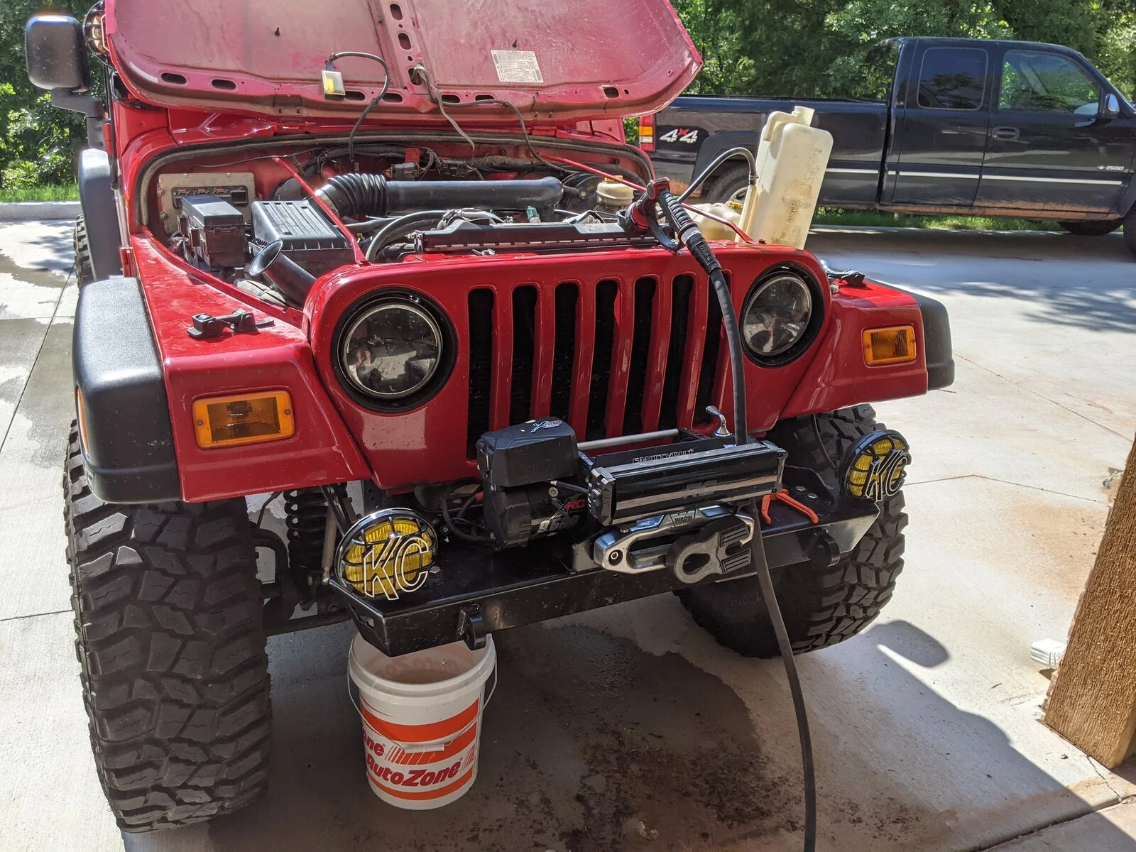

Even thermostat out this is taking for-ev-er.

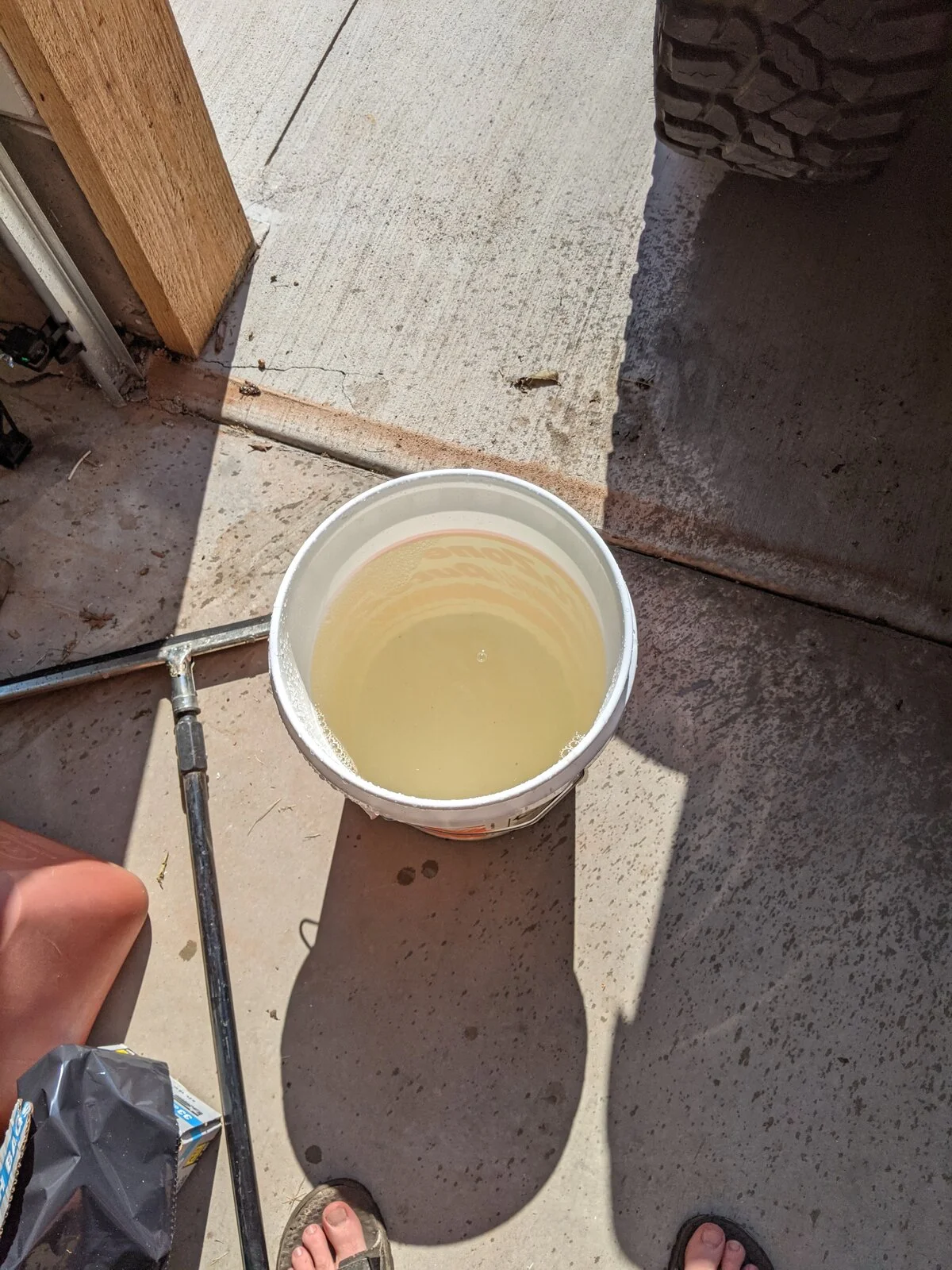

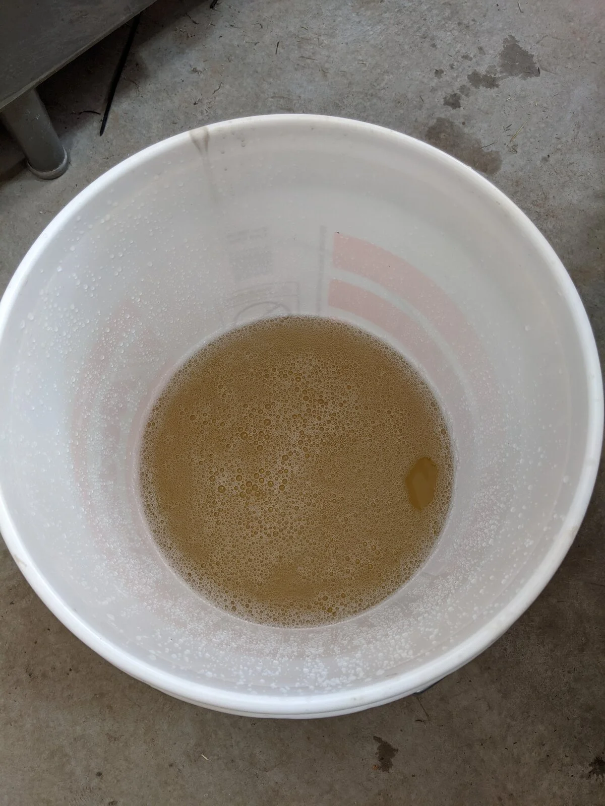

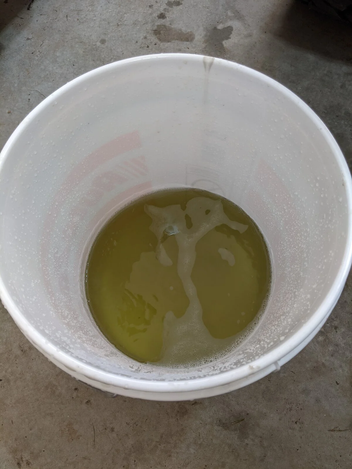

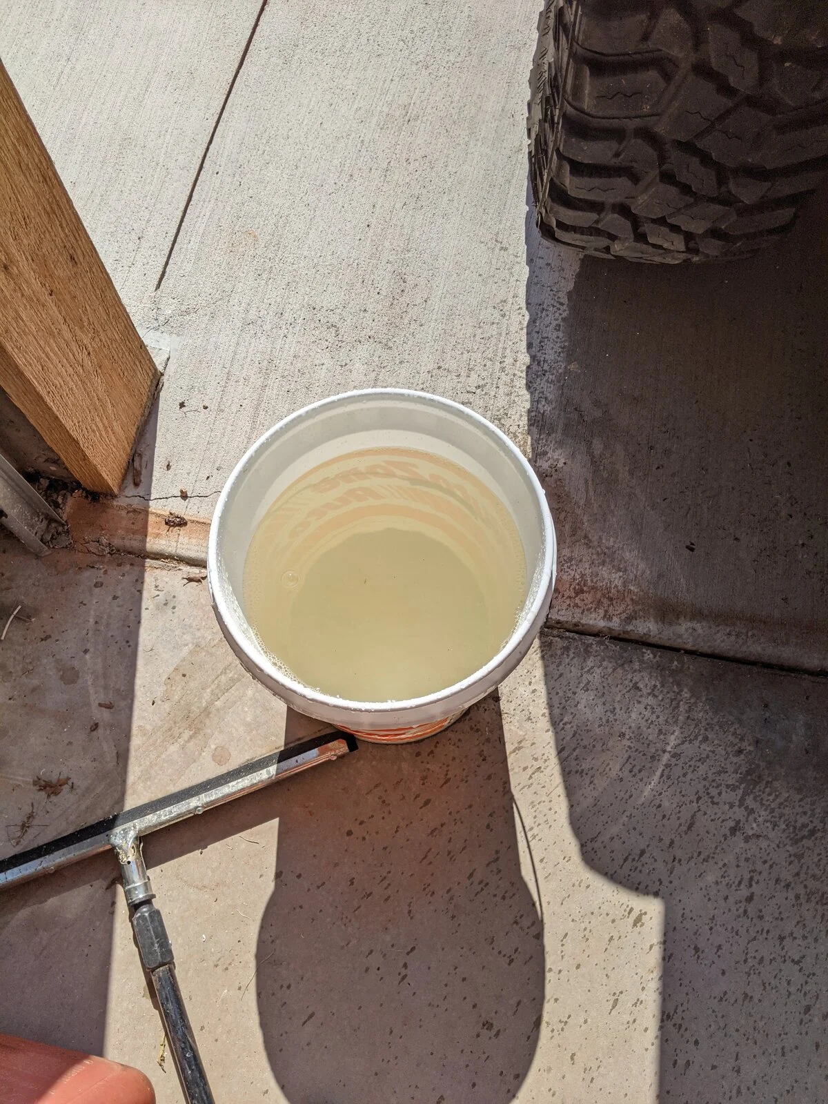

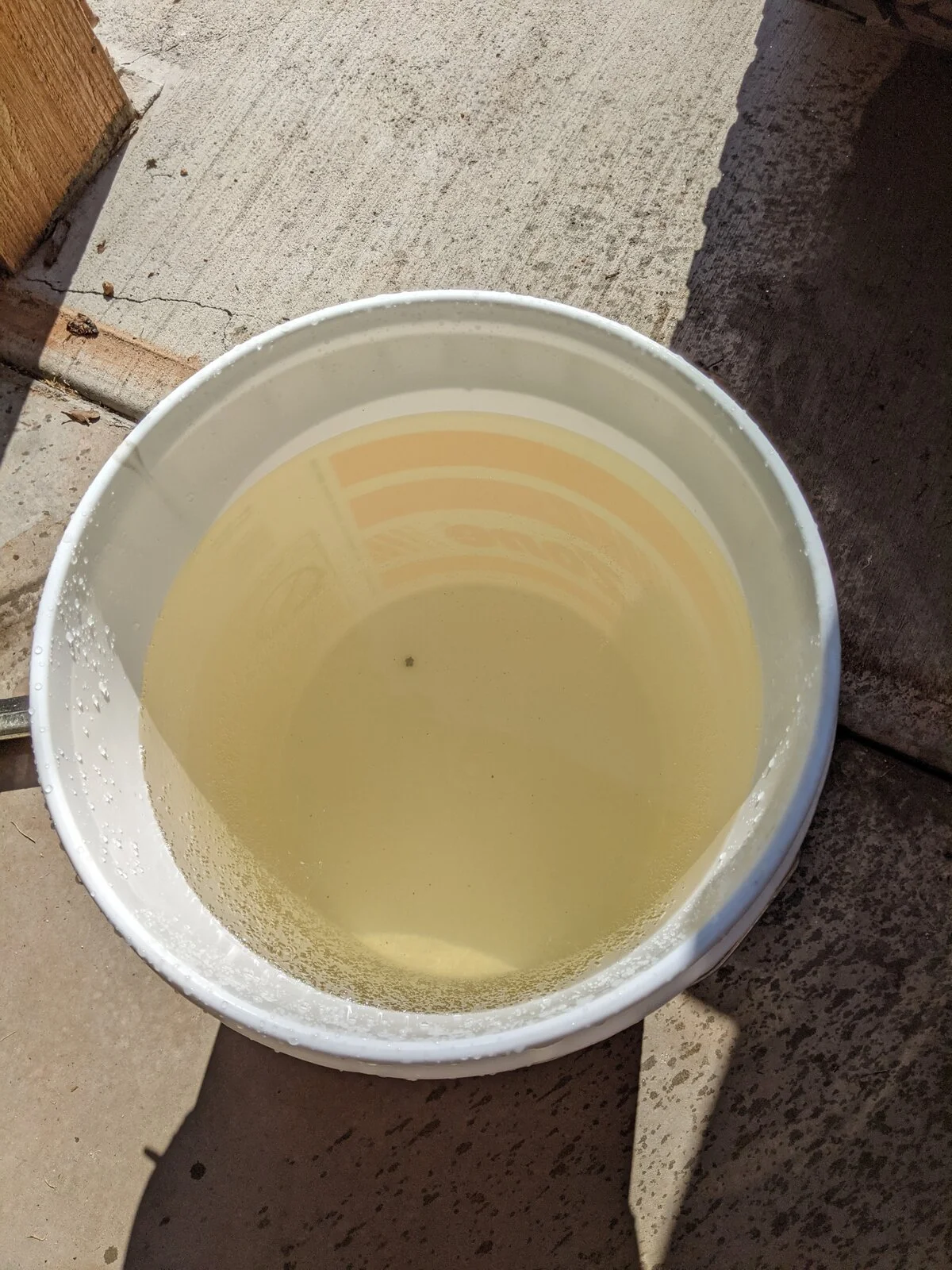

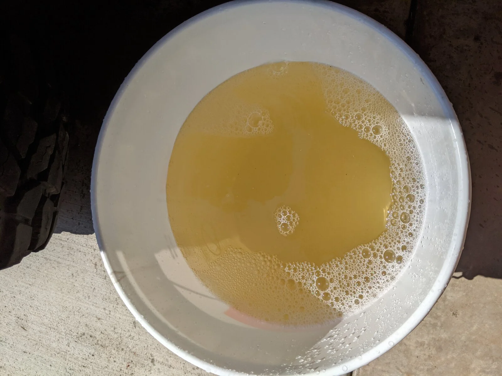

These photos are the third, then fifth flush of tap water after draining the thermocure.

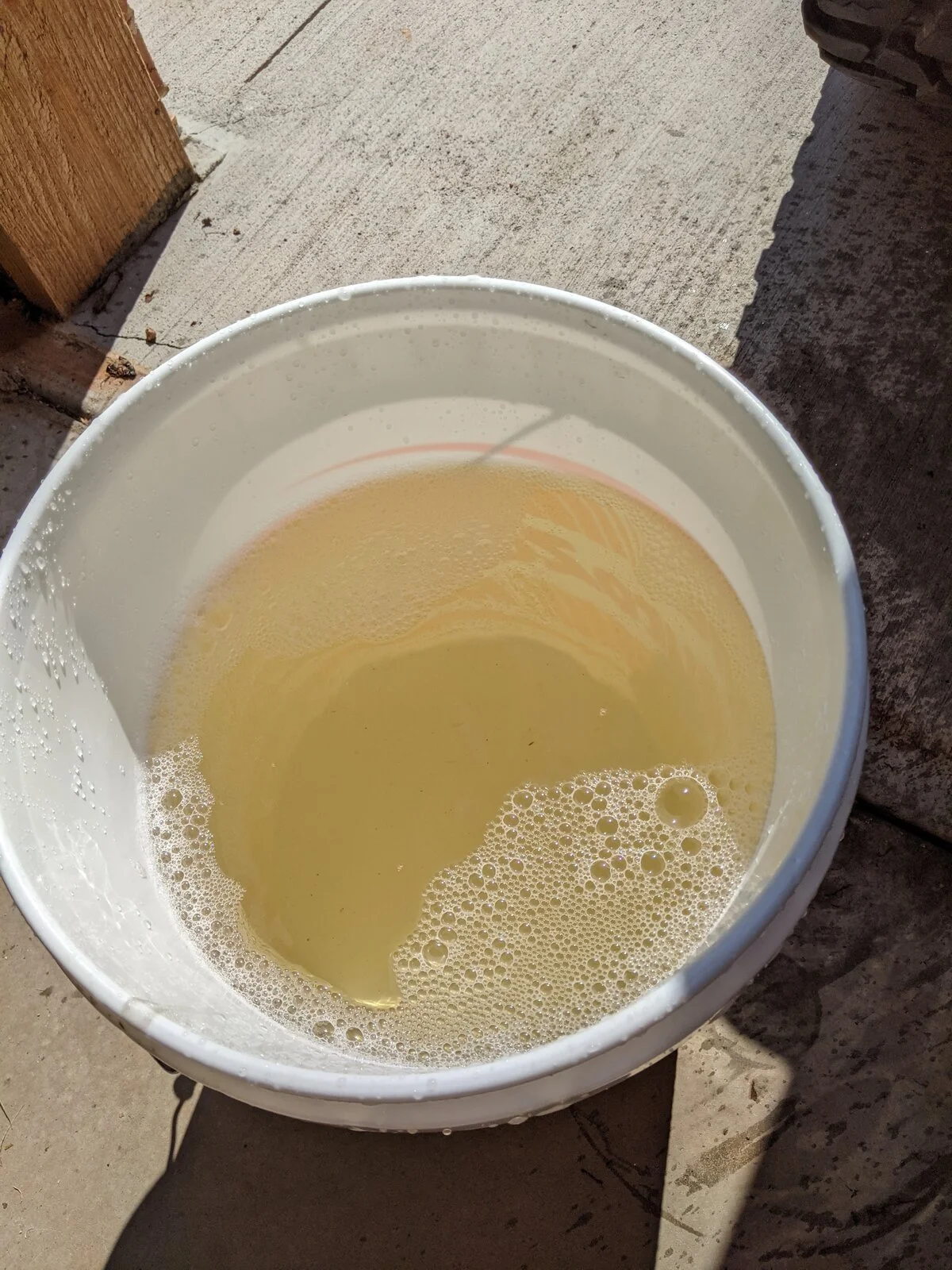

After that I just opened the drain and am running hose water into the cap at just the right rate to keep the radiator full, and emptying the bucket when it fills up.
My plan was to stop when it looked indistinguishable from tap water but I'm about 20 gallons in on this and every bucket I think ok, it'll be the next one.

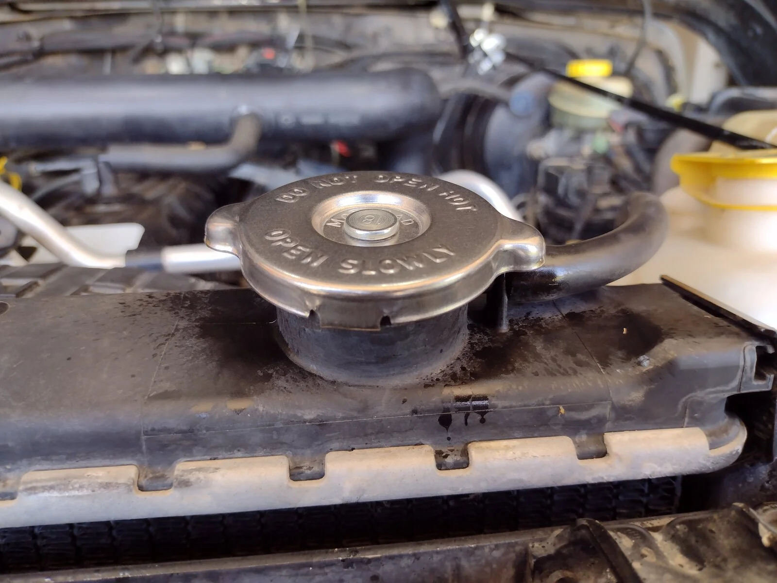

I'm also not sure what to make of all the foam I'm seeing at the cap.
Mine was foamy as well on this last run of thermocure. No issues that I know of.
