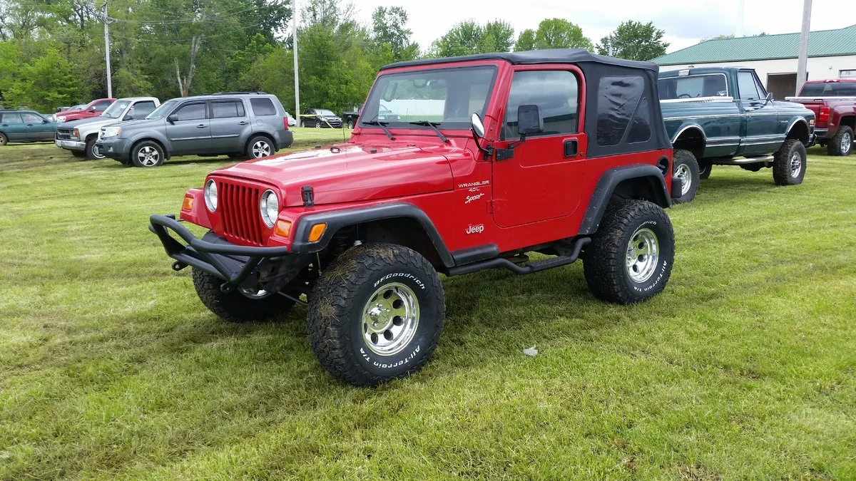

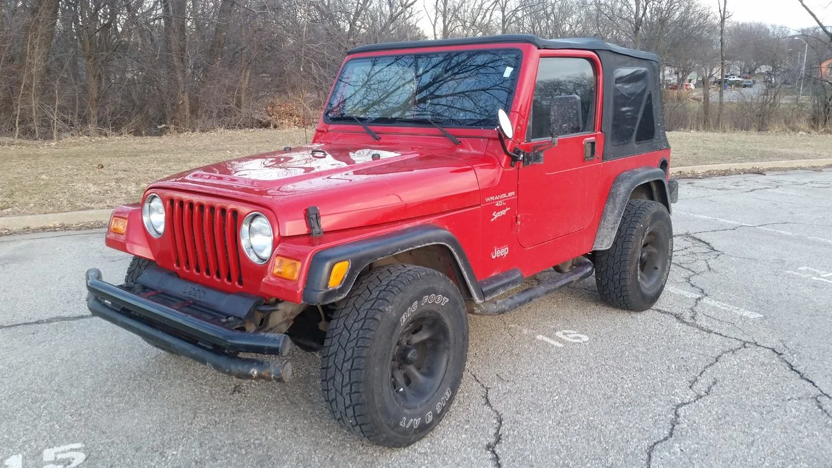

Exactly. Example:
Not bitchin:
Bitchin:
Now, as far as number of dollars to get there....well......
