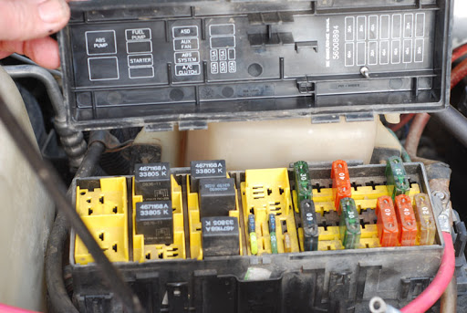

I am doing a project using an old Jeep PDC to make an auxiliary fuse box. I am going to do my own wiring.

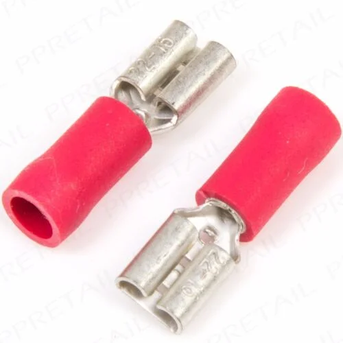

I would like to ask If anyone knows about amperages of the crimp connectors.
Is it safe to use those kind of connectors in 50-60A relays?
For example, for a device rated for 45A, I am going to use a 50A fuse + 50-60A relay + wire rated for at least 60A. Is it safe to use a crimp connector like the above for those kind of Amps?
Use the correct size crimp connector for the size wire you are using and yes they are rated for the amp load. Use a connector sized for 12ga wire it will handle the 28 amps the wire is rated for. Beware that AC amps and DC amps are not the same. DC needs larger wire then AC does. Your 60amp load may need something around 8ga wire with insulation rated for DC amperage. The connectors pictured in your post are AC rated for 14/16 gage wire, maybe about 10/12 amps, You will need some big Blues for you application

Yeah, I know that I am not going to use the red one, I just wanted to show the style of the connector.

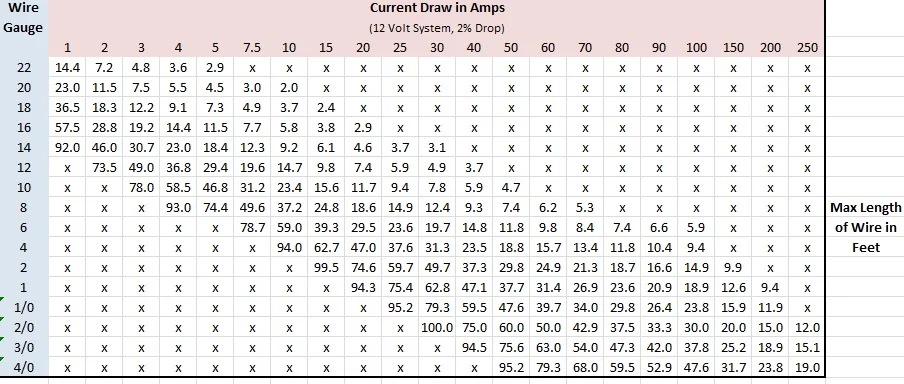

The size of the wire is also dependent on it’s length. I’ve attached a chart for automotive wire, crimp connectors are usually found for 10 GA and smaller, after that you will likely need either the mechanical (screw type shown above), or battery connectors that require a special crimp tool.
You also mention some post references for a standard bosch automotive relay, those are usually rated at 30A, maybe up to 40A. Look for 60A solenoid. I have a 500A solenoid to isolate my winch, operates that same as the bosch relay, but at a higher current rating.

I am going to " build" an Auxiliary Relay & Fuse box, by using a Power Distribution Center (PDC) of another Jeep. (photo)
