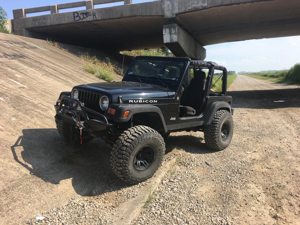

Pic on my random country cruise yesterday.
